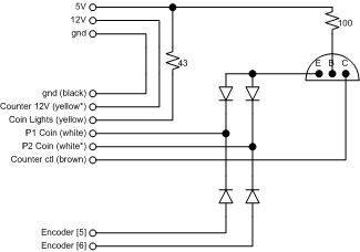

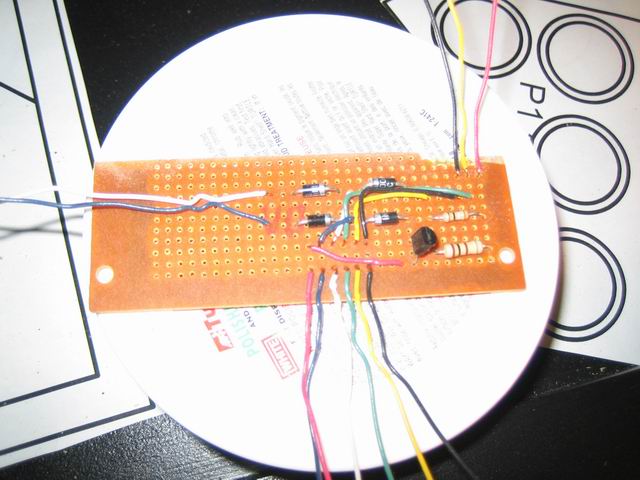

Hello everyone!
I've spend every night this week wiring the control pannel,
installing the button LED connectors, coin door led, trackball led,
connecting the ground chains
Adding a "computer" switch in the CP
bringing the 5v/12v from the PC power supply to the CP box
Doing the protection circuit to share the same encoder input between a microwsitch 4-way joystick and the P360.
and plenty of other stuff.
So I should be posting some big update soon.
I just don't have enough time right now to write the whole update
Got to get that cab running for this Saturday (my 10 years old nephew birthday)
It a race against the clock...
the BD party and my girlfriend starting to have those "fake" contractions... (not sure if it's the right word...)
Lets hope they remains "fake" for a few more days  ;)
Cheers
Jay  :cheers:
