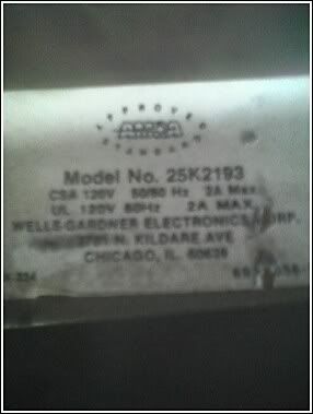

Well I plugged in my SF:II Hyper pcb today and powered it up in my cab containing a WG 25K2193 Monitor and all I got was a green line going straight across the screen.  I tried adjusting the position and such and it simply expanded ever so slightly.  Any idea as to what I am supposed to do?
Also, if anyone could find me a schematic/manual for the monitor it would be greatly appreciated.

I have a repair guide for that model. There's a service kit you need to buy from Wells-Gardner's parts department to correct the "no vertical sweep" problem you have.

Would it be possible for me to contact you through PM/Email and possibly obtain that guide if it's in digital format?  Also, would you happen to know the service kit parts # that is needed?  I couldn't find my model listed under the site but I have heard that it either IS or is similar to the U2000 monitor.

You can shoot me an email if you want the guide. It lists ALL the kits for the U2000. Your monitor is indeed a U2000 (2193).
