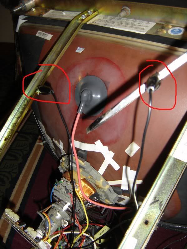

Ok i am attempting to discharge my first monitor. I have a screw driver with an aligator clip to it wired to another alligator clip that is on the frame of the monitor. Do i simply tuck it under the anode? Is it ok if my chassis is not bolted down to my frame? It is just sitting on it. Take a look at my picture and tell me if i got this right. Thanks,

Yes that will work. Just be sure the power to the monitor is unplugged.

Hurray! Thanks ken i just did it. Wasn't a big pop, very low pop. Im just glad to see my crappy jen shinn chassis leaving!
