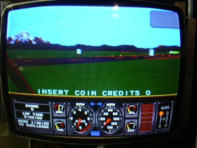

Well, I did end up getting the wei-ya 826hr from Alva amusements, so far I am happy with it.  It does have a great picture.  But  I am having a small problem though, I can't seem to shrink the picture enough, I have the horizontal and vertical set to min.  I can get the picture to get much bigger, but can't shrink it enough to get everything on the screen...
You can see in the pic that words are starting to go off the screen, its much more noticable in the test menu.  Any ideas?  Is it something I will have to live with?  Can pots be changed on the remote adjustment board for more adjustment.  I see the horizontal coil on the board, but the slug is in upside down and no hole on the board is present to put the alignment too into.  I suppose I could remove the coil to put the slug in the right way, but it still wont fix my vertical being to big.  Also, is there anywhere that I can get any type of manual for this chassis?  As always any help  is greatly appreciated.

I think the 826 is for 26" tubes while the 825 is for 25" tubes so in enessence the 826 chassis is generating a picture sized for a 26" tube.
I assume you turned the vert size/vert height pots?

Looks like that is my problem then, wrong chassis.  At that time I didn't know 826 meant 26 inch and 825 meant 25 inch.  Both vertical and horizontial pots are set to min.  Maybe they will exchange it, or maybe I can find schematics for both and find the differences.  Thanks for the help.

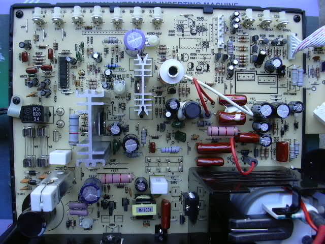

Got the 825H chassis to replace the 826HR today.  Snapped a pic for Ken:
Ken, a larger pic is below:

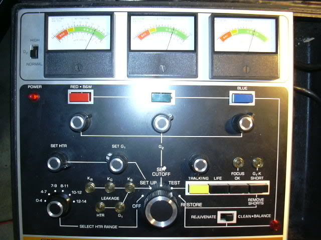

Also got a new toy on ebay for 33.00 with a bunch of adapters, so I took 467 and shot the tube as it was weak on all guns, emission looks much better now:

I am much happier, it fits on the screen now!  I wish they did have the 825HR but I can do without the remote board.  Pictures may be slightly blurry as a long day has made my hands unsteady  ;D.
I did not snap a pic of the 826HR chassis when I had it, but they look the same to me.  Alva sent me a 826HR schematic as they did not have the 825H, so sometime I am gonna look at the chassis and schematic to see what differences exist between the two chassis'.

If you have a chance, email that 825H picture to Bob Roberts for him to put up on his monitor ID page.
You got a good deal on that B&K 467. I've had one for quite a while now. I don't know how I got along without it. Remember to take the time on how to properly use it. The guns on the tube you tried on look good---pretty close in emission with each other. After 'zapping' the tube with the 467, you usually need to readjust the color control pots on the neckboard for proper color balance/level and sometimes adjust the screen, focus, or black level (brightness).
When you use a rejuvenator (a.k.a. restorer/analyzer) regardless of brand/model you must always discharge the picture tube you intend to test/rejuvenate before connecting to the rejuvenator or the rejuvenator will be DESTROYED!

Thanks for the info Ken.  I carefully read the manual for the 467 as I am new to that type of test equipment.  Yeah, I don't want to blow anything up.   Also sent the pic to Bob Roberts and he now has it posted on his site.
