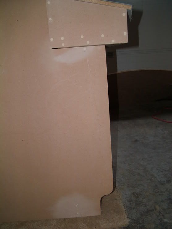

hello everybody!  just wanted to post some pictures on the progress on my first cabinet.  its a two person cab, fitted with a 27" t.v.  six button, two Happy comps, and dedicated 4-way + trackball will be purchased soon.  I'm also going to hook up a working coindoor. (just need to find a spare....)  allthough all the measurements and final design are my own,  the design  was definitely influenced by neo-geo cabs, space invaders, and "arcade paradise III".  i just took parts about all of the that i liked and put them together....
the project is currently nameless, and i am about to paint the whole thing.  i am trying to decide between all yellow, or maybe red with white pinstripes at the bottom.  ( actually I'm totally undecided on the color scheme.... ) I'm using a paint sprayer for painting.
although there are not many pictures yet to go off,  any criticism would be appreciated as i plan to build a second cab after this. ( i already have some relatives who would like to buy this.)  so if anything looks wrong in anyway, please point it out. ( design, flow of controls, shoddy carpentry, etc etc.)

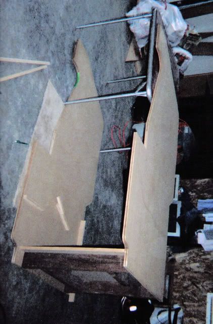

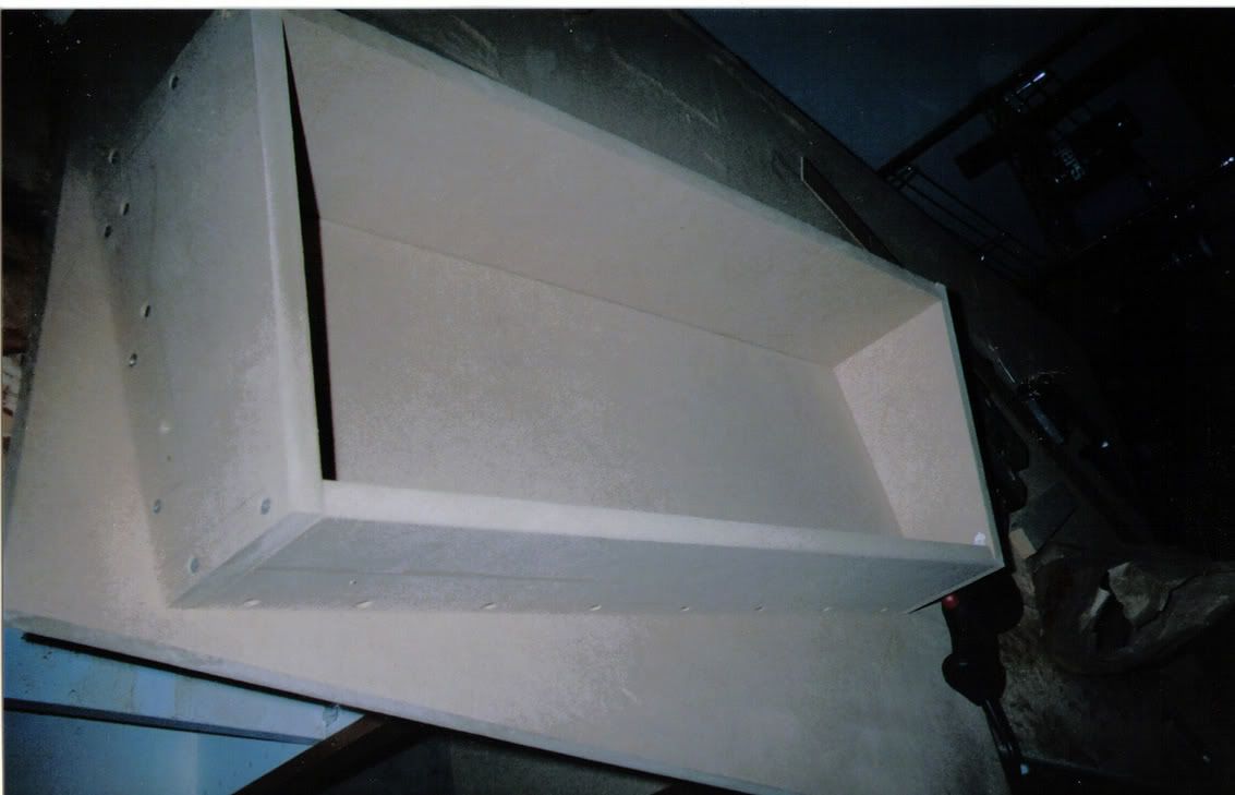

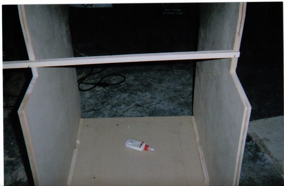

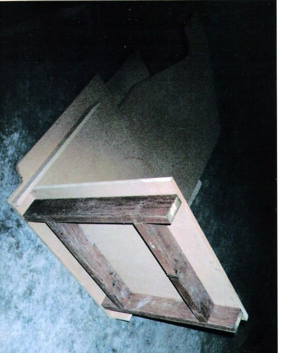

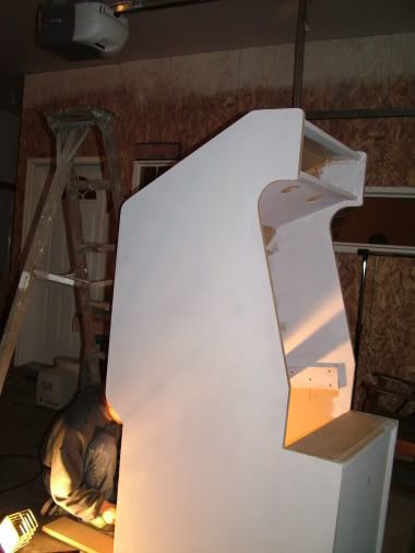

picture quality is bad, but you can kinda see how my cab sides will look....i wish i had the updated pictures w/ me....
the start of my cp.....screw holes were later filled and edges rounded out.
my cab getting the sides leveled out....
another view of the bottom being attached to the sides....
from the front w/ the bottom attached....
« Last Edit: December 20, 2005, 04:40:22 pm by babydickonboard »

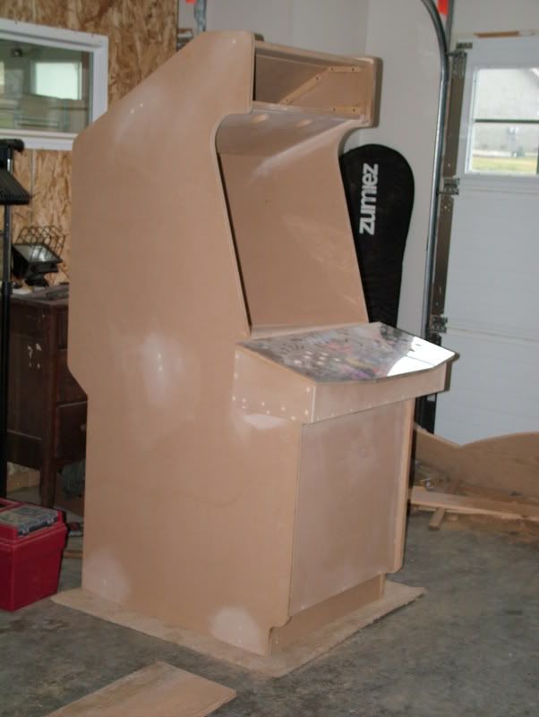

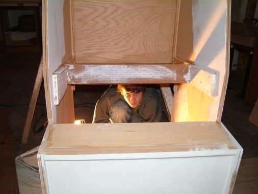

so i got a digital camera for Christmas.  heres some updated pics.
front side of the cab....
the top of the cp thats in the pic is just temporary until i get a trackball + spinner.  also will eventually put in a coindoor.
speaker shelf

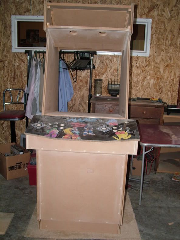

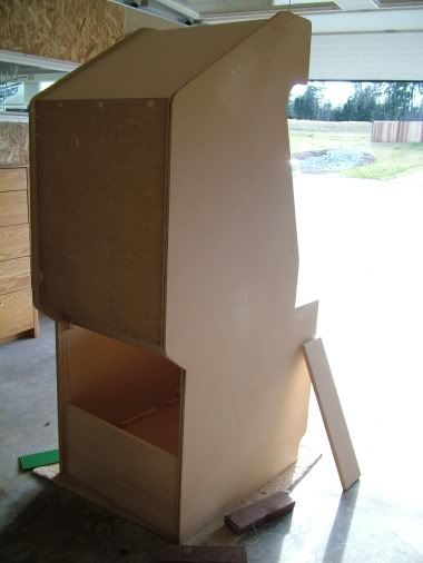

after a looong delay due to lack of time + money, construction has once agian started up on my cab.  just got through priming and finishing the backside. heres some updated pics.
also...my friend has offered to model the cab w/ some cad software. so all the measurements and dimensions are on there way.

Hi. Your cab looks great so far. I really like the way you designed the sides. One thing i will tel you is to use fine grit sand paper and sand beetween each layer of primer and paint. It makes a huge difference.

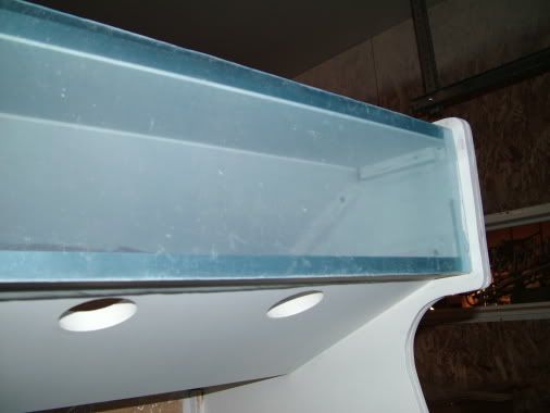

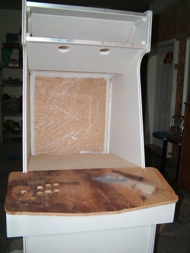

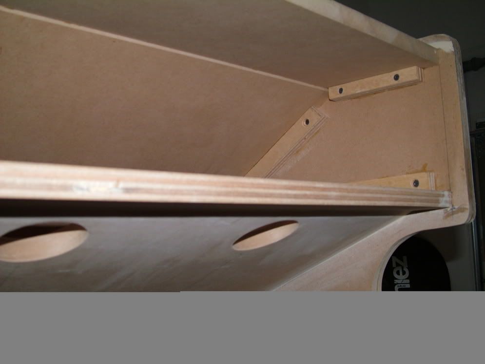

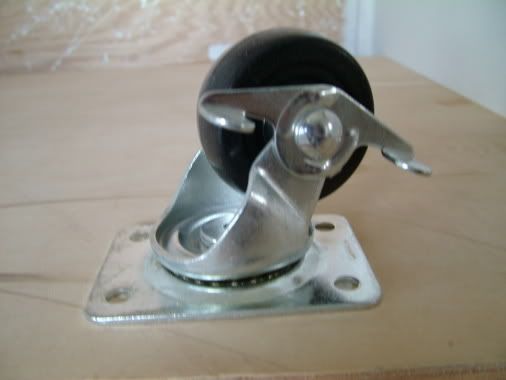

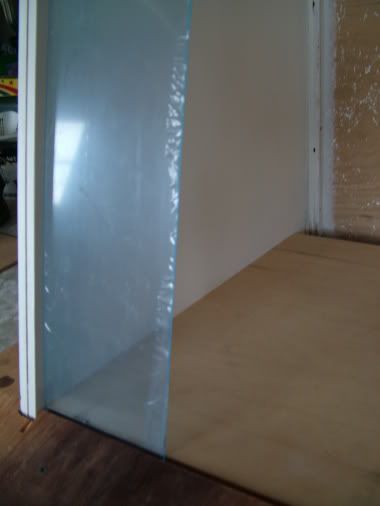

heres some more updated pictures.  i rolled on a second layer of primer, and cut the marquee out of some plexie.  i also got some locking wheels to attach to the bottom.  I really need to figure out a theme + name for the cab, cause i'm almost to the point where i need to start adding artwork.  i'm thinking of something generic, like Arcade Anthology or Game Blowout. OR maybe i'll have it in spanish/latin or something.  I'm really not all that sure.
im also trying to decide if i should spray on the coats of paint, or use a foam roller.  anybody have experience w/ the differences?

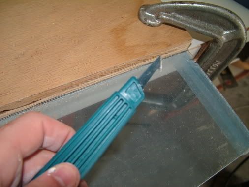

heres a picture of scoring and snapping some acrillic.
heres the locking wheels i got.  ( four of em for 25$ )
and finaaly heres how i'm thinking of putting the glass in front of the monitor.  it can slide in between the control panel and the monitor shelf.
picture of marquee... i know the metal retainer is on the inside....i had to hold the plexie up.
frontal shot
« Last Edit: March 30, 2006, 12:12:43 pm by babydickonboard »

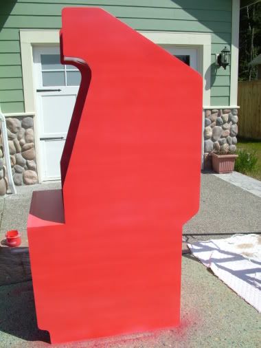

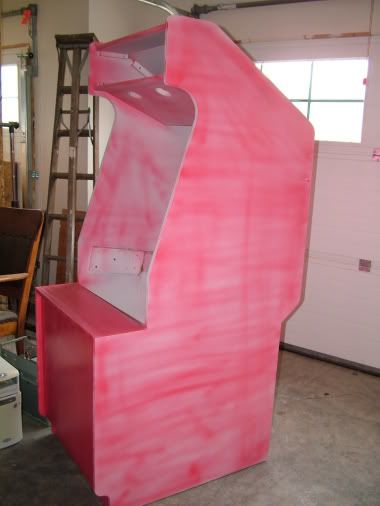

Just finished painting w/ my new spray painter and compressor.  heres some pics.
the first pass turned out horrible, due to the sprayer being clogged. so i soaked the tips in some mineral spirits and it cleared it right up. the second pass that i did today turned out much better, tho there are still visible lines in the paint job. this was my first time ever using a sprayer, so a medicore job was expected. i'll spray the paint on vertically next time, and im sure that will help.
 :lame:
i'm also not happy w/ the color @ all.... it too pink and not enough red.  but this may be due the white primer underneath and/or it not being all the way cured.  the lady at the store assured me that it would cure red and if it dosn't i can take it back and get some more red mixed in.
-oh, and the paint i'm using is oil-based Aspen gloss enamel, and i thinned it down w/ some mineral spirits so it would go thru the sprayer easier.

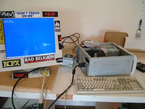

i also started setting up the computer i would be using. so far its...
- pent. III (700ish mhz)
- 20 gig HD
- 256mb ram
-vga card w/ s-video out.
i started putting windows 2000 onto it, but i'm pretty sure i'm going to put win98 instead, for the performance gain.

We both have the same general shape to our cabs.  It is looking good.  If you find that the paint is running in streaks up the pressure of the sprayer and see if that helps.  My sprayer said max 40 and it sprayed much better at 50.  Also took less time.
i'm not too worried about streaks on the next coat, but how does one go about increasing  the pressure of the sprayer?  ARe the dials on the sprayer resposible for this? ( currently i have no idea what the dials do. )

I strongly agree with rlemmon's comment about sanding between coats.  I helped out a friend with his cab and he didn't do it.  Now it is in his basement and the lighting really draws out the scratches.  I helped my son make a chair for a class project and we put on 4 coats of semi-gloss black paint.  We used 400 grit paper between coats.  It looks glass.

i plan on doing some sanding between coats, but i kinda want to stay away from the super shiny glass finish if possible.  once i do another coat though, i'll decide if i want to make it high gloss, or a slightly eggshell type finish.
