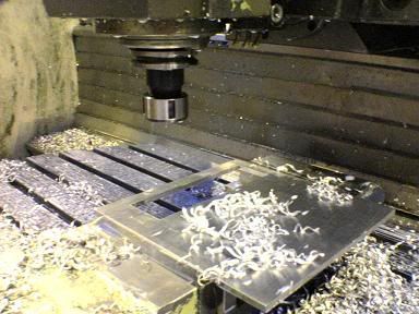

Ive been moving house this past week so I havent really been able to spend much time on the CP. I have got the console plates finished just about though.
This is a pic of the machined plate:-
The hole profiles were milled on a CNC machining center and then I just sawed the excess plate off and file finished them. The finish is pretty good but I want it mirror like so Ive plenty more polishing to do yet!

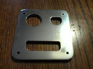

This is a picture of the plate with the adapters in place:-
They are all just controller extension leads. I am going to shoten the N64 and PS2 ones as they plug into an adapter just inside the CP but the DC ones will plug directly into a DC that is in the bottom of my cab.

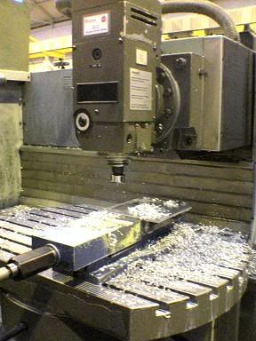

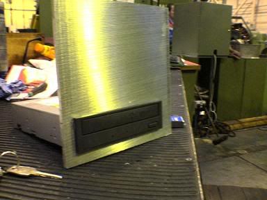

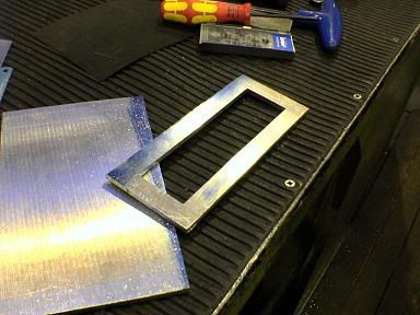

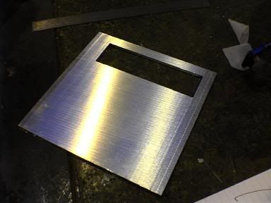

I started the CD drive plate tonight. I know some people (like me!) like to see progress pictures of things being made so Ive taken a few as I have been going along.
This is one of the Maho machining center that the plate was milled on (the same as the console plates)
Bit of a close up of the job in hand:-
The finished profile (after I had filed the radii out to give a square corner):-
Test fit of the drive in the plate, look mommy, no gaps!!
Plate cut out to size using a band saw (started with a hacksaw but im just too lazy!)
Anyway im off back for a couple of hours of filling! More pics to follow!

Yeah think I will definatly look into the engraving. Im just wondering how easy it is to engrave ally with it being so soft.
Im a CNC machinist and work for a company that makes gas turbines. Home orders are one of the very few perks of the job!
That machining center pictured is one of our smallest. This is a bigger Mazak close to me but we have some huge ones in over departments. Im talking about 5 meters tall!
