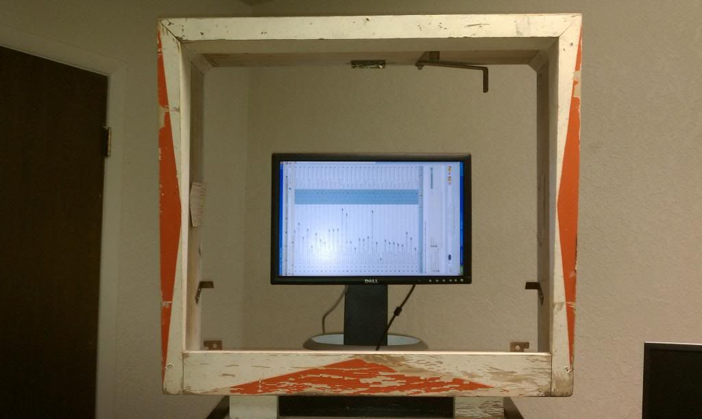

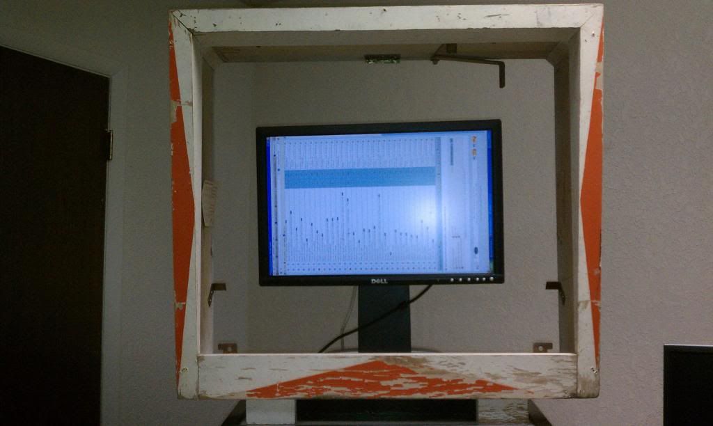

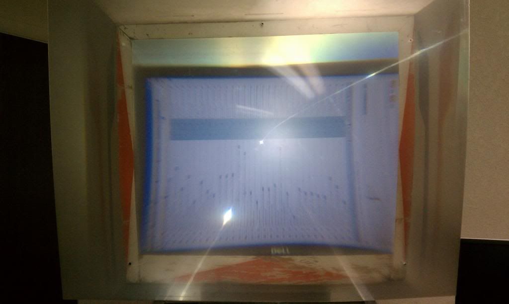

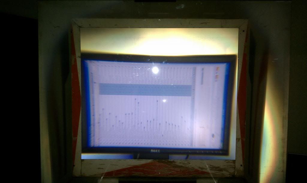

I need to bring this thread back from almost 10 years dead. I am considering using a fresnel lens from a "modern" projection TV in front of a 19" 4:3 LCD Monitor in the backbox of a pinball simulator. What are my odds of success? What I really need is about a 32" 4:3 monitor. This is my goal. Is there any other kind of solution? I have a small collection of fresnel lenses to try it with, but they are not in hand right now.
http://pinballmd.com/
MTPPC
  • Posts: 535
Re: Are Fresnel lenses worth it?
« Reply #8 on: February 19, 2013, 07:07:02 pm »
My experimentation is done and the concept is interesting, but the results are sub-par. Here is a with and without at 7" behind the lens:
Here is a with and without at 17" behind the lens:
Now you know.
