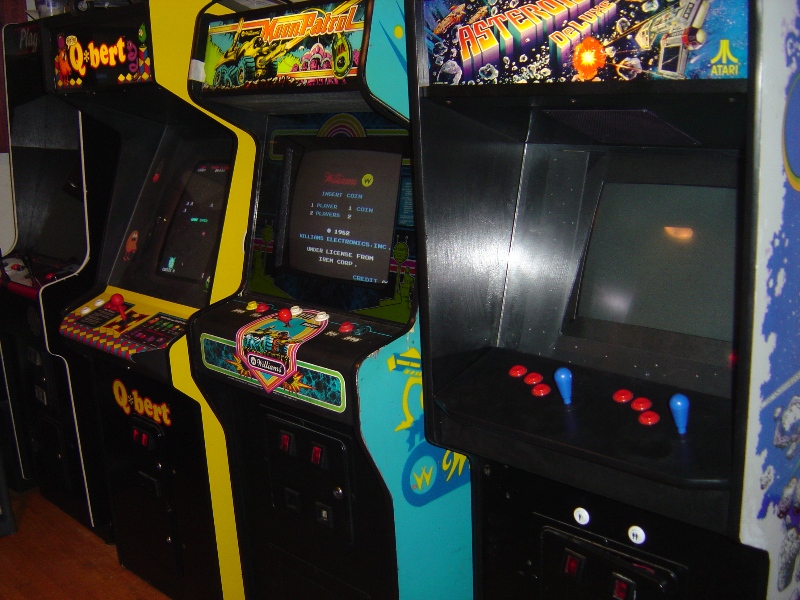

My machines are as follows:
**Q*Bert clone
    Fixed vertical monitor
    Only Vertical ROMS
    Mame .67
    ArcadeOs
    3 buttons 1 joystick +2 player start buttons
    iPac encoder
    PIII 800 /512Mb ram /TNT2 32Mb AGP/SB16 ISA
**Asteroids Delux rescued from going to the dump
    Fixed horizontal monitor
    Only Horizontal ROMs
    Mame .67
    AdvanceMENU (note: new version with xml file will not run, older one does
    6 buttons 2 joysticks  + 2 player start buttons
    iPac encoder
    Athlon XP 2400/512Mb ram/TNT2 32Mb AGP/ SBPCI (DOS driver available for the one sold at WalMart)
**PacMan, also rescued from going to the dump
    PacMan series ROMs only
    ArcadeOs
    Mame .36
    0 buttons + 2 player start buttons
    KeyWhiz encoder
    AMD K6II 240Mhz/ 64Mb ram/ Nvidia 32Mb PCI/same SBPCI as above
