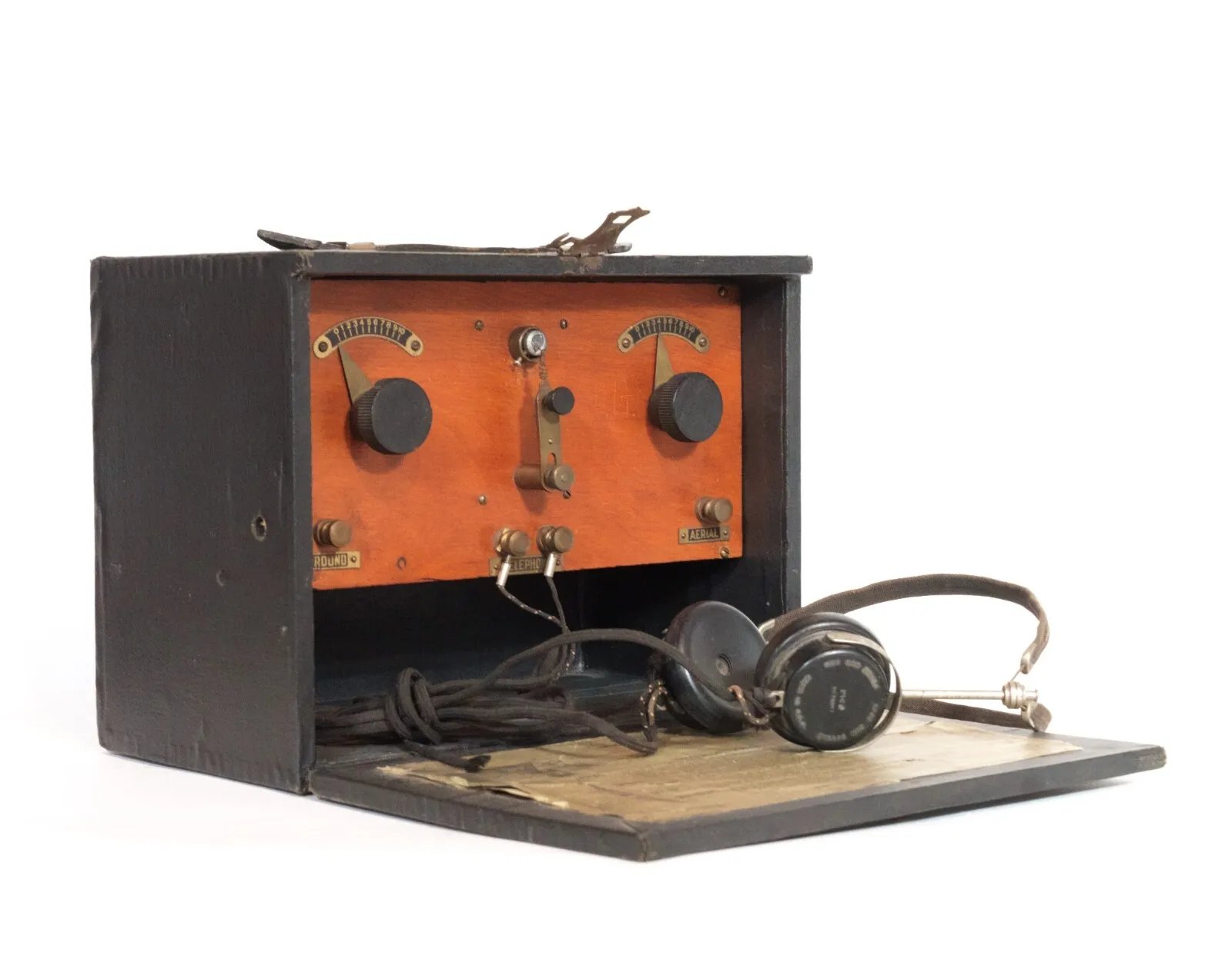

Thanks. Heres a couple of pics.

  • Posts: 5198
Re: Vintage Radio restoration
« Reply #4 on: May 24, 2024, 08:14:32 pm »
What is missing?
two labels (GROUND and TELEPHONE)
one bakelight terminal nut.
One wiper assembly (someone replaced one with a variable capacitor.
One cats whisker assembly with galena crystal. (It was missing, I installed two banana jacks to attach a geranium diode to.)
Original box with instructions on fold down door. (I made the box in the pic, I only had a pic of the original to go by).
It works, but I havent put up a proper antenna yet, so its reception is limited. (A proper antenna is a wire 50 to 100 feet long, strung up outside at least 10 feet off ground.)
Here is the pic I had of the original:
« Last Edit: May 24, 2024, 08:23:46 pm by DaOld Man »

Love the old headset that goes with it. Interesting they put the diode on the outside. Do you think that was because it needed adjusting/attention? Like physical pressure on the crystal needed to be adjusted from time to time? Or was it a sort of 'LOOK TO THE FUTURE!' kinda deal just to show off the hi tech?
Looking at it again, probably for adjustment. Man, we made crystal sets in grade 7. Mine was one of the few that worked. If we had to use THOSE diodes I don't think any of them woulda worked.
Thank god for germanium, huh?

« Reply #8 on: May 24, 2024, 11:13:39 pm »
Actually, I added the diode, the original had a galena crystal that a small wire touched. This was called a cats whisker. You had to move the wire to find the right spot on the crystal.
Of course, the cats whisker was missing, I replaced it with a 1N34A diode.
I made something similar to this when I was a kid, except it used a bent safety pin with a piece of pencil graphite attached, the graphite tip touched a double edged razor. You had to move it to find the right spot on the razor. This was called a "Foxhole Radio", used by soldiers on the battle field.
