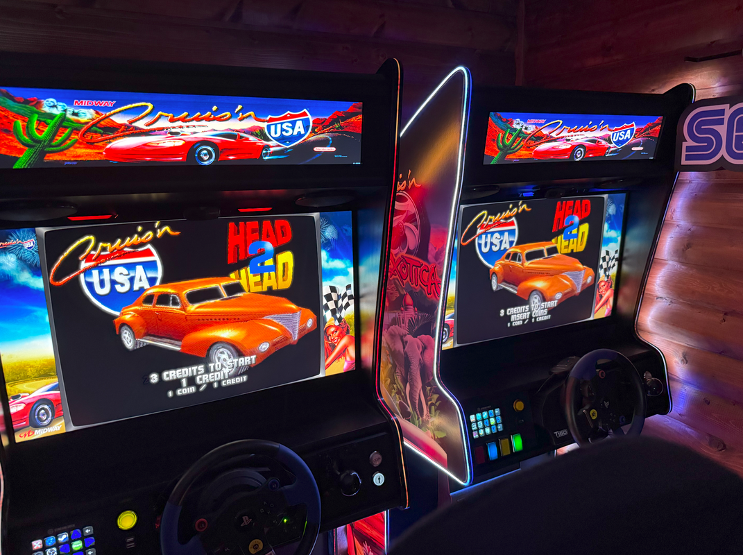

https://youtube.com/shorts/SO_e-36-JFY
/edit Now I really need to get going and hang this beauty above my cabs!!!  Anyone have a manual on the Cruis'n USA topper? I think I can figure out the voltages but I don't want to accidently let out the magic smoke....

Hello everyone, what wonderful news, I downloaded the mame version, which version of the game do I have to use? Would there be a bat file or commands to send to mame? I opened the games, set it to master And save, the message appears to enable the firewall, I enable it, but the games are not linked.
theolditguy
  • Posts: 14
  • Last login:July 30, 2025, 01:49:10 pm
Re: Cruis n usa and Cruis n World (MAME) link 2 players?
« Reply #24 on: July 30, 2025, 01:49:11 pm »
My setup:
two machines on 192.168.x.x Network
Local windows firewall completely disabled
cruisnmame
Cruis'n USA 4.5
set dip switchs (2) to linked mode on/enable
Set second machine to SLAVE in dipswitch settings
thats it!  I use a bat file for games like Virtua Racing but I didnt need one for this game/this version of mame.

So far so good. I have two player Crusn USA working and it’s incredible thank you! I just need to add it to my other two cabs that have race leader lights to verify outputs are the same. A few things I ran into:
1) I make my cfg files for games read only once I am done with them and then I copied my Crusn usa cfg file to this new Mame folder and the dip switches were not saving (and lan mode not working) due to this. Taking off the windows read only right click properties of the file fixed that. This probably only applies to me
2) Changing Mame.ini ip to point to each other worked great and lan works great but I could not get my controls to work at all even after copying from a Mame folder where it works so…
3) For some reason in Crusn in the Mame tab menu you have to go to the controls section and go to the second section (analog or something like that) and change the acclerator pedal to reverse. That fixed not being able to go past 2nd gear or being able to push gas to select .
I assume Crusn USA is only 2 players still right? As far as I know it was 2 in the arcade. For Crusn world, do we have to put the comm ip in a loop so racer 1 points to the ip of racer 2, racer 2 points to racer 3 ip, racer 3 ip points to racer 4, and racer 4 points to racer 1 in the Mame.ini (or crusnusa.ini or whatever it is called if you have a named ini for game specific controls)?

Awesome I will give Crusn World a try and put Cruis’n USA on my two cabs with a race leader
lights and update everyone.
