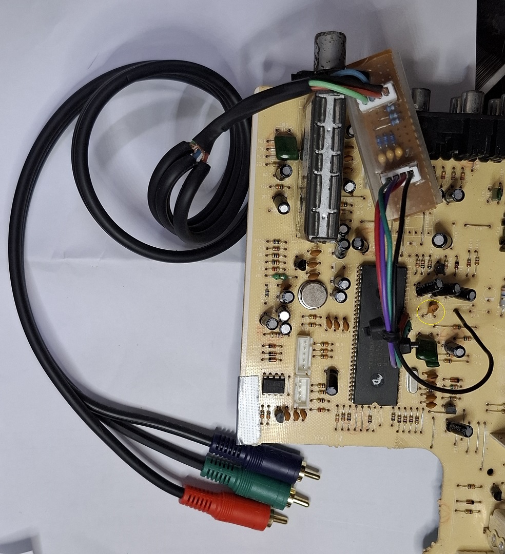

So, it all works! here are some shots of it all connected up. On the second pic you can see the standard test colour bars on the screen via PC input.
Here is the TV connected to a standard DVD player by component. No GreenAntz required for this, it is completely standard input from the DVD player.

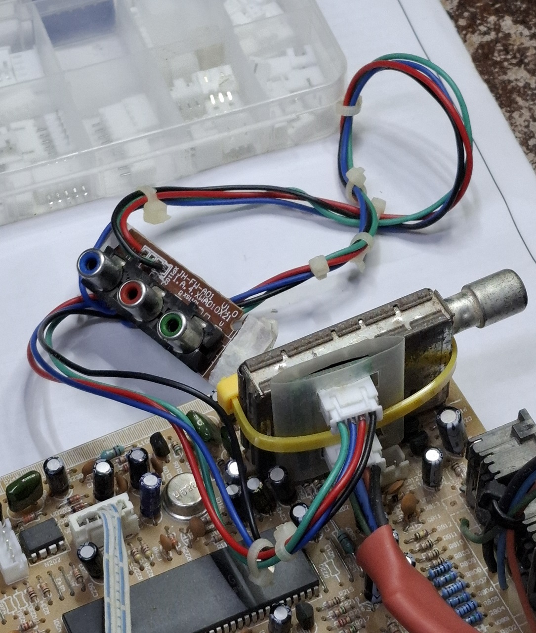

Last month or so I've gone and done component mods to two more of these China TV chassis, and I've learned a bit more, and want to share that. I also re-visited one of my earlier mods.
I took these photos over a period of roughly a month, a little while ago (Jan/Feb). I've had to pick out the best, as the TVs have mostly been closed up and put away already, and don't want to open them up again just for photos. So I'll be using pics from three very similar, but different, China TV chassis in this post. You will notice some minor differences.

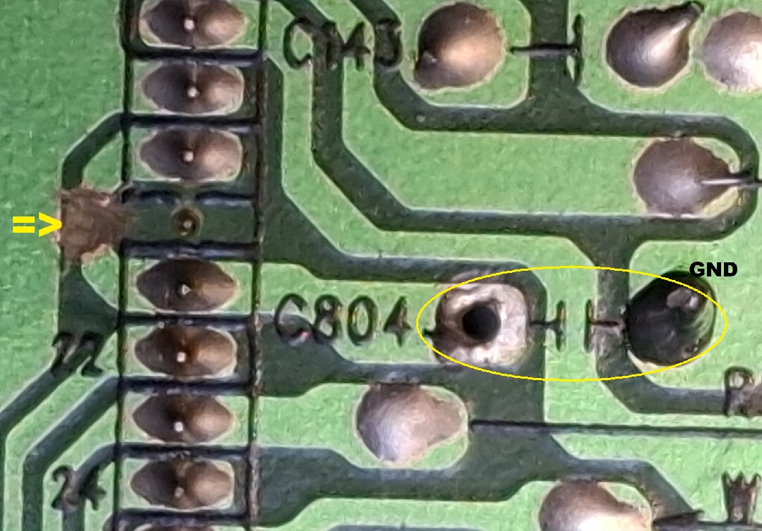

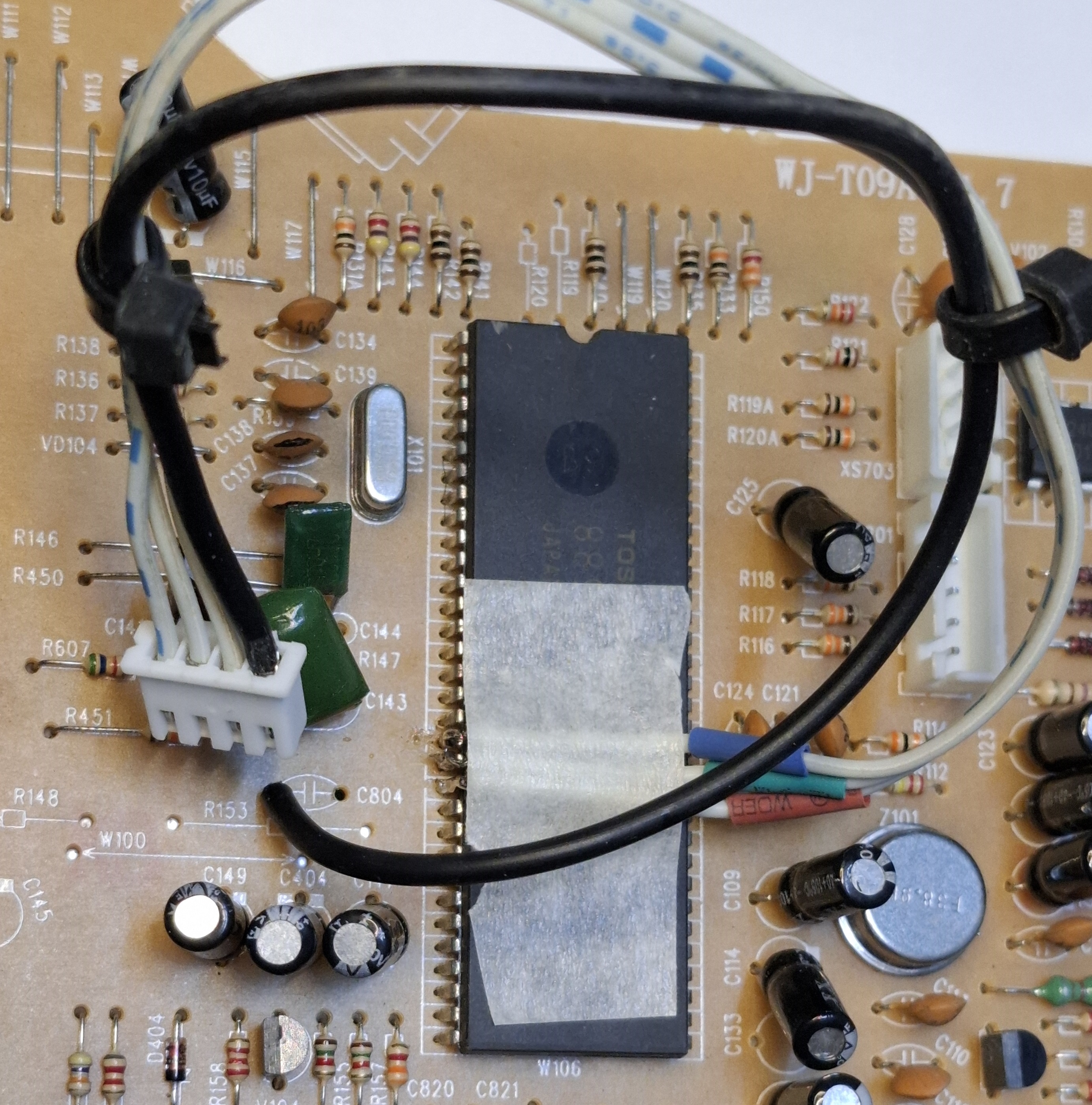

These next two TVs have the same basic China TV layout, same jungle. However, unlike the ones I did earlier, these PCBs don't have any blank spots for the extra resistors and capacitors. There are no convenient landing points for the component inputs, and there are no copper traces leading to the jungle pins [Pb, Y, Pr] -> [19, 20, 21]. There isn't even any copper trace around the Y input (pin 20)! It is what it is.
Means some fiddly soldering right onto the legs. Will need to scratch off copper trace connecting pins 19 and 21 (Pb and Pr). In this pic we can see that the trace connects 19 to 21, and then to C804, a 103 (10nF) ceramic capacitor. This 103 cap clamps the Pb, Pr signal pins to ground, to prevent unused inputs from "floating ". It needs to be removed. The first pic below is untouched and shows which pins are the signal pins; the second pic (from an identical but different TV) has had the trace scraped off between Pr and Pb, and C804 has been removed.
Before soldering, I did some crimping and put it all together into 4-pin female headers, which I'll explain in a moment.
For my first attempt at soldering to the jungles pins, I attached some stout leads to the wires to make them sturdier, then stuck the ends into the PCB holes for the pins, and soldered. This works OK, great even, but the wires shoot straight up and, though it is sturdier than it looks, I still worry it might break off accidentally. Not that this has ever happened. It works fine, I won't redo it, but I can do better!
See that 103 capacitor, C804, circled in yellow? It is the one I mentioned earlier - I forgot to remove it before taking the pics! I went back, removed C804, moved the Pr input to the newly vacated hole. I then also cleaned it all up, it is still quite messy in these photos, and sometimes you don't realise how messy something is until you see the high-res images. The black spots near the pins are just magic marker, so I know which pins to solder.
For the second TV, I took a different approach. I recycled some surplus 3-wire TV ribbon cable and added an extra wire for GND.
Then I stripped a few mm of wire, carefully laid the ribbon down on top of the jungle, bent the exposed wires to meet the pins, and secured it with some paper tape.  The ribbon cable/wire has the right combination of being somewhat stiff yet flexible enough to make this work. This made the soldering much easier, and the wires more secure.
I put some coloured heat shrink on the wires so I wouldn't get them mixed up.

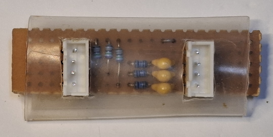

To make things more manageable, I created a mini input-PCBs for the input circuit. I used some offcut breadboard, 2 x 4-pin male connectors for IN/OUT, 3x100R resistors, 3x75R resistors, and 3x104 (100nF) ceramic capacitors. I've included a simple schematic. The last pic shows the input-PCB inside some heat shrink for electrical insulation. I cut some holes for the connectors. I didn't bother with heating the heat-shrink as it works perfectly the way it is, I can still remove it to get at the PCB inside, and those white connectors are a bit sensitive to heat.
104 (0.1uF/100nF) capacitors are pretty much always what you'll need for Pb, Pr. I've also gone with 104 (100nF) on Y, and that is right for these TVs. For other TVs with different jungles, some might go up to 1uF on Y, but I suggest starting with 100nF anyway. This is because capacitors in parallel ADD capacitance, and it would be easy to solder a 1uF capacitor below the 100nF. This would give you a total of 1.1uF, close enough for testing. If it works better that way for your TV, then you can make it permanent. If this seems confusing, then just stick with 100nF.
These input-PCBs are very convenient, especially now I have several TVs with the same component mod. In normal use, when the TV is closed, it is connected to the external side-input so standard video cables can be used.
When a TV is on my bench, for testing with GreenAntz connected, I can just unplug that external side input and use a shorter, more convenient cable that I've hacked. This saves space and hassle, the soldered connection to the jungle is more secure, and it is easier to work on the main PCB with everything unplugged.
I even created an input-PCB for one of my earlier mods, but without the input resistors/capacitors, as these are already present on the main PCB (see pics below). I just find it very convenient to use, and having all my TVs modded the same way makes it interchangeable.

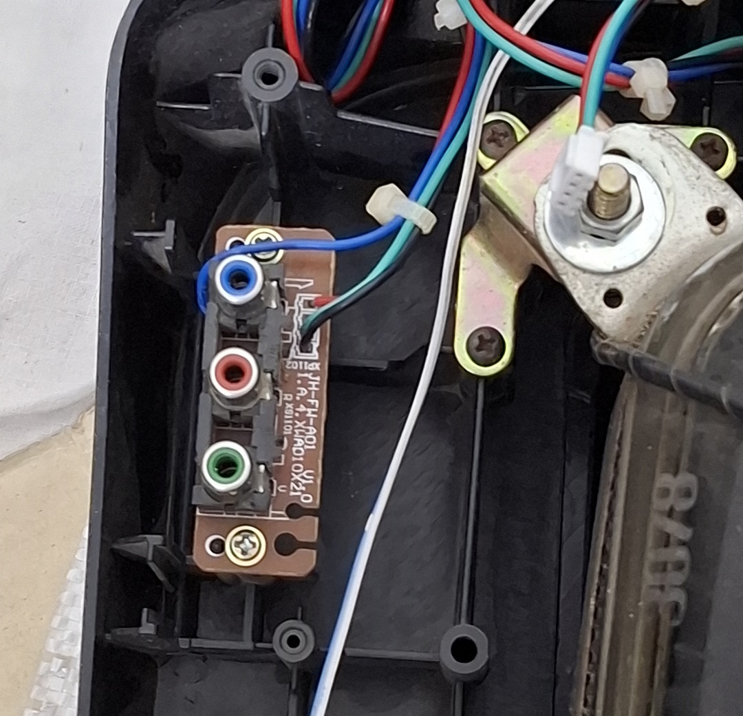

... in the first post at the end you mentioned having to add the ground wire by modifying the pcb...what modification did you have to do on that one?
Ah, you mean the side connector?
Unfortunately I didn't take any pics of the modded back side, and I've reassembled all the TVs now.
Every TV model be a little different, and I've done about 5-6 TVs now. They all required some modification, but slightly different in each case. In most cases the left/right audio channels (red/white) were connected at the PCB. In most I had to use a craft knife to carefully cut a channel separating the audio inputs - sometimes a small cut, sometimes quite large. In all cases the cables back to chassis had only 3 wires (video, audio, ground), but for our purposes we need 4 wires (Y, Pb, Pr, ground) so a wire must be added.
Here are some pics of a side connector I salvaged from a dead TV. The TV had been left out in rain by a former owner, thus the corrosion on the outer metal shell.
Those coloured insets (yellow/red/white) can be removed and replaced with something else - you will need to desolder the metal ground shells from the PCB and prise them off with a small screwdriver or something. Then the coloured "donuts" come out, you can replace them with something more appropriate. I happen to have RGB coloured ones handy already, but you could make them yourself from some plastic or card.
Here is a close up of the underside. The three big pins at top, all connected together, are the grounds. They all connect to the metal shells on the other side. You'll need to desolder them to change the coloured insets.
The three big pins below that are (from left) for video, audioL and audioR. Notice that audioL & audioR lines are linked by a small bit of trace? I marked this in yellow.
The three smaller pins at top left are where the cable connects. See how only one audio wire is connected? Forget about stereo sound with this TV! The other two are for video and ground. There is a spot to add a fourth wire, but it isn't used. I marked this in turquoise, this is where you'd add the extra wire when modding this for component input.
So this side connector would be very easy to adapt for Y Pb Pr. You could just cut the small bit of connecting trace between the audio L&R. In this case the ground is already connected, would need to add a wire for one of the component colours.
« Last Edit: May 15, 2025, 07:55:59 pm by Zebidee »

Looking at your input mini-PCB, at first I thought you had gotten the inline capacitors and resistors back-to-front, and you used 75R instead of 100R, but I see that is how they are in the schematic you provided. I'd probably just stick to ceramic capacitors where possible, though the blue polypropylene film caps you've used should be sufficient. If it works then it works :D

I also made a v2 of the input mini-PCB with 103 caps instead of the blue ones and shielded wire this time. I wish I had a picture of it but I already closed up the TV because I was glad I could finally get it over with. :lol

Yeah - I also forgot to suggest trying a 104 (0.1uF, instead of the 1uF can cap) on Y - though it is a little more hassle to test as you'd have to remove the 1uF. On my TVs I found that the default 1uF cap made Y a tiny bit fuzzier, less sharp - though some might see this as an advantage!
This is because these jungles artificially create a slight delay on the chroma signals as it takes a few hundred nanoseconds (fraction of a microsecond) for the IC (basically a tiny computer) to digitally process or "demodulate" the analog Pr/Pb into Cr/Cb and then => RGB, the delay means a visible Y/luma shadow, to the right, can be visible in some situations with a crisp 240p input. So, making the Y a little fuzzier disguises the delay. So I suggest trying 104 (0.1uF) on Y, but ultimately you may prefer the 1uF.

You could try bumping that 1uF cap on Y down to a 104 (0.1uF), though I don't expect this to do much about blooming.

However, I then had another problem... it wasn't working. On the hardware side I thought I was lucky because I found pads labelled Y Cb and Cr on the board right next to the composite ports, so I soldered onto those thinking that perhaps the manufacturer simply left the component ports out. Turns out I was wrong.
I thought maybe there's just some pulldown resistors but trying to follow them back to the jungle chip was a nightmare, they had caps and resistors and jumpers all over the place. I knew pins 19 - 21 were the correct ones, so I decided to just cut those pins off the board to completely isolate them from the mess of traces below and bend them up at a 90 degree angle to solder onto them directly. I used hot glue afterwards to secure the delicate wires and pins and did something I'm not entirely proud of...
I took apart my 14" China CRT and pilfered the PCB I made for it last year because it was late at night and I didn't want to have to make another one. (I'll make another one for that TV so it doesn't become a composite only paperweight again) I soldered the PCB onto the new TV and it works!
It seems the colour maths are correct for this TV too. The PCB worked great in the 14" but it was designed for what that TV's schematics require, not this 21" TCL. It has 75 ohm termination, 75 ohms in series with each of them and 1uF electrolytic for the Y, and 104s for the Pb and Pr.
The OSD is pin sharp, but both composite and the newly-added component look similarly soft. The TV has a sharpness control (0-100) that at 50 adds obvious haloing. At 0 it looks soft, and 25-30 seems a reasonable compromise—but I can't tell if that's because 0 reveals the TV's natural softness, or if 0 is actually applying some sort of anti-sharpening filter. Any thoughts?

You can also play with using a 1uf (vs 0.1uf) on Y input. With 1uf the Y signal persists a little longer, makes it a tiny bit fuzzier. Even 10uf would probably not be terrible. I dunno, depends on the TV and personal choice. Compromise.
Try 100R for the inline resistors.
Yeah, you can't assume anything. Even if the PCB traces are still there, you'd need to add some components like the inline caps & resistors; & terminator resistors.
Plot it out with a multimeter. Whether the PCB traces are there or not, you may find the Y Cb Cr inputs (maybe just the Cb,Cr) connected to ground via one or more 103 capacitors (prevents unused inputs from floating). You should remove the 103s and maybe use the vacated footprint as an easier place to land your inputs.
Pics please!

Pictures you requested, and pictures you shall get:
Description of each picture in order:
1. A collage of all the service menu pages I could get to display (0 - 9 buttons and calendar, so 10 pages total). There may be more but I'm not sure. Strangely this TV displays some different items when displaying NTSC and PAL, with PAL being the default (all of these are for PAL, most should apply to both apart from the geometry ones)
2. The jungle IC of the 21" Philips, it may be hard to see but it says 8821CRNG5HG4.

I noticed the image is a rotated to the left by a few degrees and the convergence is out a little in the top left and bottom right corners too.
The upside though with this TV is that blooming is far less noticeable than on my 14" CRT, and scanlines are finally visible.
The image rotation would be a yoke alignment thing. To fix that you'd need to loosen the yoke (there will be one (or maybe two) ring clamp, and you'd need to loosen some rubber wedges) and twist it slightly while the TV is powered on and displaying a test image.
If you use silicon to re-glue the rubber wedges be sure to leave the back off about 24 hours, and be careful what you touch with dirty fingers - for some silicons, as it cures it releases a vapour that can corrode copper. You could use hot glue instead but I never trust that very much.
For your mini-PCB, try putting the inline capacitors *after* the inline resistors. And try using 100R there instead, as suggested earlier.
Of course, those Ro and Lo connection points are for right/left audio, so I assume you've cut some traces if repurposing them for Pr/Pb. In addition, on most (all?) of these 2000s cheap China TV variants they would run the right and left audio channels together (connection deliberately bridged with copper trace). On some of my China TVs the L/R channels were connected on the side input, so you'll need to check everywhere.
Try playing with that HDDELAY setting, I'm wondering if it is something similar to the Y-delay I was talking about earlier.
Good luck!
