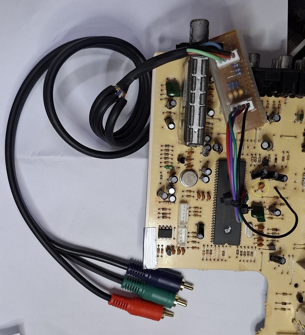

Last month or so I've gone and done component mods to two more of these China TV chassis, and I've learned a bit more, and want to share that. I also re-visited one of my earlier mods.
I took these photos over a period of roughly a month, a little while ago (Jan/Feb). I've had to pick out the best, as the TVs have mostly been closed up and put away already, and don't want to open them up again just for photos. So I'll be using pics from three very similar, but different, China TV chassis in this post. You will notice some minor differences.

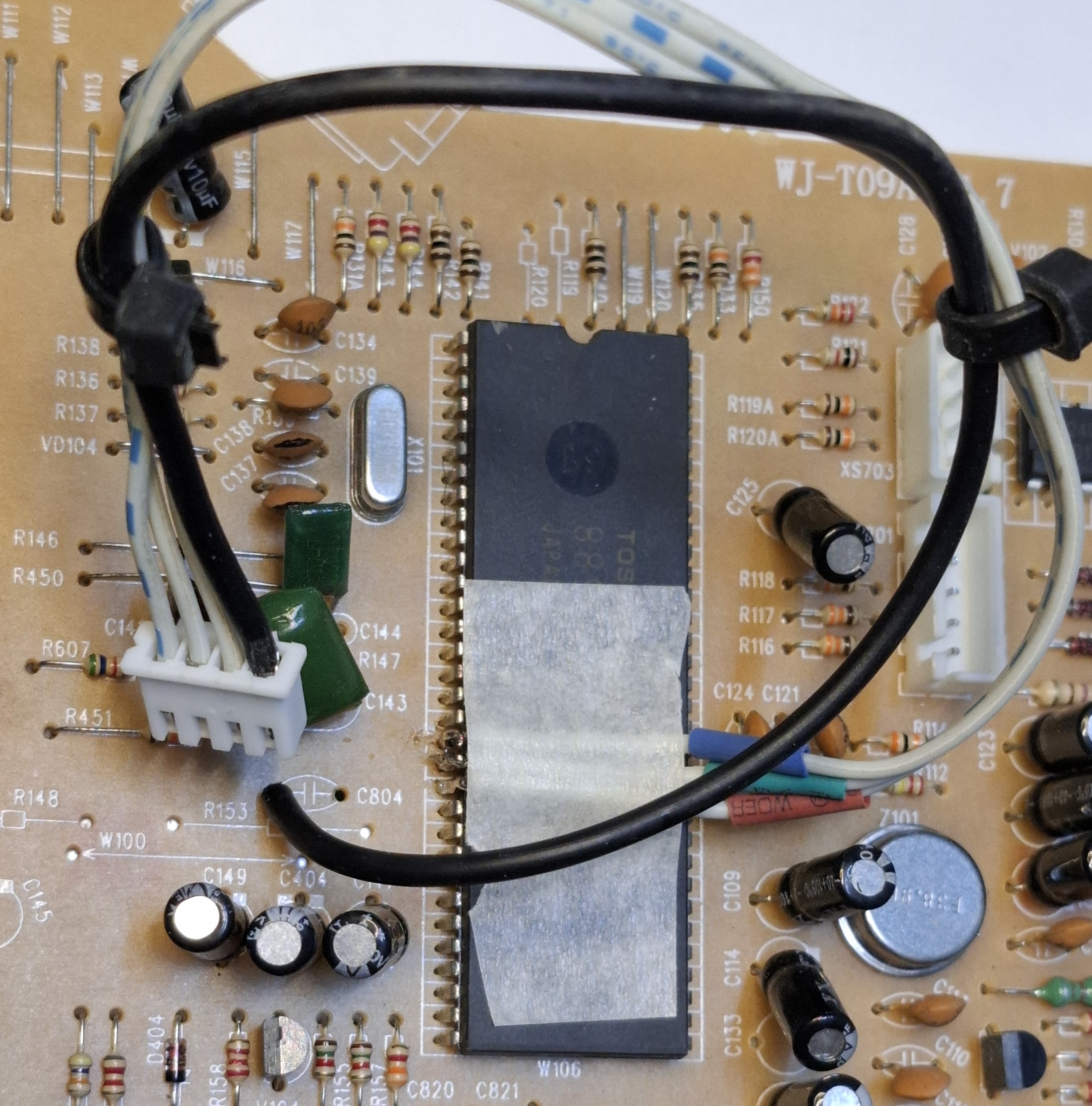

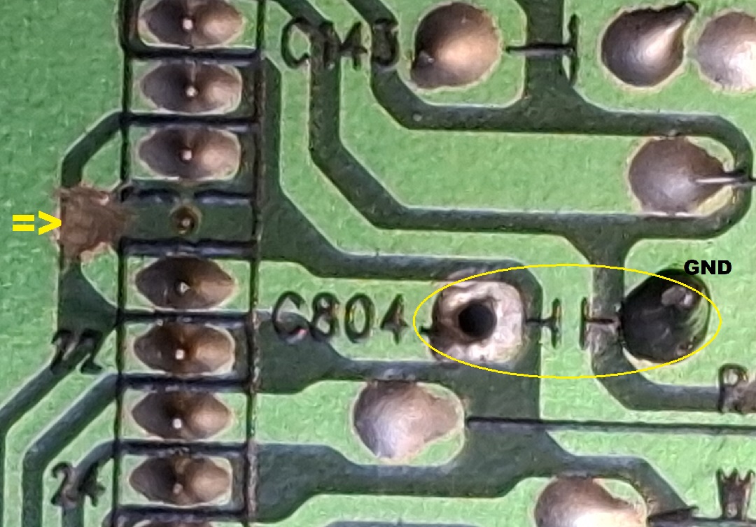

These next two TVs have the same basic China TV layout, same jungle. However, unlike the ones I did earlier, these PCBs don't have any blank spots for the extra resistors and capacitors. There are no convenient landing points for the component inputs, and there are no copper traces leading to the jungle pins [Pb, Y, Pr] -> [19, 20, 21]. There isn't even any copper trace around the Y input (pin 20)! It is what it is.
Means some fiddly soldering right onto the legs. Will need to scratch off copper trace connecting pins 19 and 21 (Pb and Pr). In this pic we can see that the trace connects 19 to 21, and then to C804, a 103 (10nF) ceramic capacitor. This 103 cap clamps the Pb, Pr signal pins to ground, to prevent unused inputs from "floating ". It needs to be removed. The first pic below is untouched and shows which pins are the signal pins; the second pic (from an identical but different TV) has had the trace scraped off between Pr and Pb, and C804 has been removed.
Before soldering, I did some crimping and put it all together into 4-pin female headers, which I'll explain in a moment.
For my first attempt at soldering to the jungles pins, I attached some stout leads to the wires to make them sturdier, then stuck the ends into the PCB holes for the pins, and soldered. This works OK, great even, but the wires shoot straight up and, though it is sturdier than it looks, I still worry it might break off accidentally. Not that this has ever happened. It works fine, I won't redo it, but I can do better!
See that 103 capacitor, C804, circled in yellow? It is the one I mentioned earlier - I forgot to remove it before taking the pics! I went back, removed C804, moved the Pr input to the newly vacated hole. I then also cleaned it all up, it is still quite messy in these photos, and sometimes you don't realise how messy something is until you see the high-res images. The black spots near the pins are just magic marker, so I know which pins to solder.

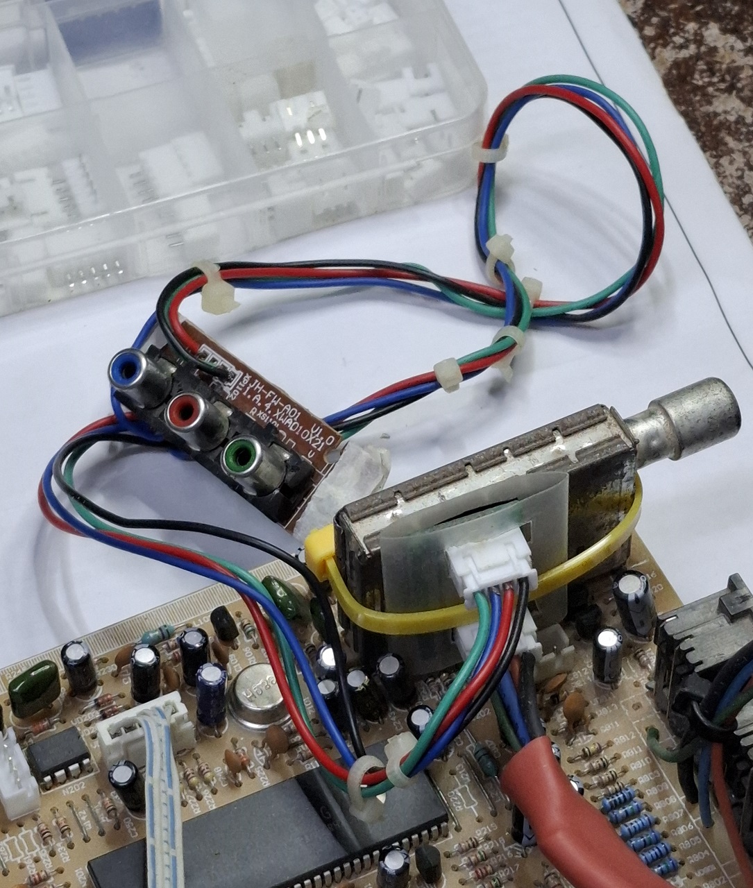

For the second TV, I took a different approach. I recycled some surplus 3-wire TV ribbon cable and added an extra wire for GND.
Then I stripped a few mm of wire, carefully laid the ribbon down on top of the jungle, bent the exposed wires to meet the pins, and secured it with some paper tape.  The ribbon cable/wire has the right combination of being somewhat stiff yet flexible enough to make this work. This made the soldering much easier, and the wires more secure.
I put some coloured heat shrink on the wires so I wouldn't get them mixed up.
To make things more manageable, I created a mini input-PCBs for the input circuit. I used some offcut breadboard, 2 x 4-pin male connectors for IN/OUT, 3x100R resistors, 3x75R resistors, and 3x104 (100nF) ceramic capacitors. I've included a simple schematic. The last pic shows the input-PCB inside some heat shrink for electrical insulation. I cut some holes for the connectors. I didn't bother with heating the heat-shrink as it works perfectly the way it is, I can still remove it to get at the PCB inside, and those white connectors are a bit sensitive to heat.
104 (0.1uF/100nF) capacitors are pretty much always what you'll need for Pb, Pr. I've also gone with 104 (100nF) on Y, and that is right for these TVs. For other TVs with different jungles, some might go up to 1uF on Y, but I suggest starting with 100nF anyway. This is because capacitors in parallel ADD capacitance, and it would be easy to solder a 1uF capacitor below the 100nF. This would give you a total of 1.1uF, close enough for testing. If it works better that way for your TV, then you can make it permanent. If this seems confusing, then just stick with 100nF.
These input-PCBs are very convenient, especially now I have several TVs with the same component mod. In normal use, when the TV is closed, it is connected to the external side-input so standard video cables can be used.
When a TV is on my bench, for testing with GreenAntz connected, I can just unplug that external side input and use a shorter, more convenient cable that I've hacked. This saves space and hassle, the soldered connection to the jungle is more secure, and it is easier to work on the main PCB with everything unplugged.
I even created an input-PCB for one of my earlier mods, but without the input resistors/capacitors, as these are already present on the main PCB (see pics below). I just find it very convenient to use, and having all my TVs modded the same way makes it interchangeable.
For the connectors, I bought one of these kits with a range of JTC 2.54mm pitch terminal connectors with a range of sizes. The kits cost about $3-4 each and come with all the pins for crimping. I've been using a lot of 4P connectors, I tried to find these cheaper separately but could not. So I just bought another kit! I should probably invest in a better crimping tool too.

I just bought a Philips 21" CRT TV, because although I got my 14" Sonistar looking great, it's still a 14" at the end of the day. The Philips is is 20PT2110-79R, and upon opening it up, the jungle chip and stickers indicate it must be a TCL design:
Jungle IC: TCL-A30V01-TO (can't even find a datasheet for some reason, quite unexpected, nevertheless it's a 64-pin jungle IC and the board even had Y Cr and Cb pads labelled next to the composite ones behind the connector and I used that to trace the pins to 19, 20 and 21)
Board number: 40-2165MG-MAI1G
24C08 EEPROM
The tube is made by Hitachi
I've unfortunately run into the same problem as before, I successfully completed the wiring for adding YPbPr, but I again can't access the service menu... sort of. The TV came with a universal remote, with most of the button icons worn off, but after trying them all one of them makes the TV display 'TV IC ADJUST' but with nothing else on the screen. I tried every button, even the TCL codes you mentioned in your TCL codes and other results Google came up with, nothing. Have you ever come across a CRT like it? I'm stuck... again! :timebomb: Thanks.

Thanks for the help, very luckily I managed to figure it out!
This TV is 100% TCL, it doesn't have a bootup logo (no cuffs and collars to speak of :D) but the only thing that's Philips about it is the plastic logo on the front.
Turns out I was being a bit dumb, the Jungle IC is a 8821CRNG5HG4, the TCL-A30V01-TO was the first thing I spotted, but I should've noted the number below it instead.
Either way, I found the service manual for a similar but not identical TCL TV and it told me to turn the volume down to 0 and hold vol. down on the TV while pressing display on the remote and that worked!
Unfortunately this is where I ran into yet another problem. While the service manual on my China CRT was relatively simple to understand and navigate (just had to change pages until I found Enable YUV and set that from 0 to 1), this TCL was indecipherable with no YUV, DVD or S-Video enable anywhere. However, thanks to the manual from a similar TV I found earlier I was able to understand that this TV doesn't have enable flags exposed directly, it's a little more obfuscated, under the MODE1 setting it shows in the service manual YUV as bit 6, and that MODE1 is a bitwise map that contains a 8 bits total, and you need to enable the correct bit (flip that from 0 to 1) to enable what you want. So I had to flip bit 6 from 0 to 1. However it's not stored in simple binary, its a HEX value, so I had to convert the currently stored value (97) from HEX (0x97) to binary ()
MODE1 is an 8-bit register. Each feature is controlled by a specific bit. The value you see (like F0, FC, etc.) is the sum of all active bits.
Bit Values
Bit   Feature   Hex Value   Binary
0   BG System enable   0x01   00000001
1   I system enable   0x02   00000010
2   DK system enable   0x04   00000100
3   M system enable   0x08   00001000
4   VIDEO2 enable   0x10   00010000
5   VIDEO3 enable   0x20   00100000
6   YUV enable   0x40   01000000
7   Thailand Dual language   0x80   10000000
Current: 10010111 (0x97)
Add YUV bit 6: 01000000 (0x40)
New binary: 11010111 = 0xD7
So I changed MODE1 from 97 to D7 and the component input appeared on the TV at last!
However, I then had another problem... it wasn't working. On the hardware side I thought I was lucky because I found pads labelled Y Cb and Cr on the board right next to the composite ports, so I soldered onto those thinking that perhaps the manufacturer simply left the component ports out. Turns out I was wrong.
I thought maybe there's just some pulldown resistors but trying to follow them back to the jungle chip was a nightmare, they had caps and resistors and jumpers all over the place. I knew pins 19 - 21 were the correct ones, so I decided to just cut those pins off the board to completely isolate them from the mess of traces below and bend them up at a 90 degree angle to solder onto them directly. I used hot glue afterwards to secure the delicate wires and pins and did something I'm not entirely proud of...
I took apart my 14" China CRT and pilfered the PCB I made for it last year because it was late at night and I didn't want to have to make another one. (I'll make another one for that TV so it doesn't become a composite only paperweight again) I soldered the PCB onto the new TV and it works!
It seems the colour maths are correct for this TV too. The PCB worked great in the 14" but it was designed for what that TV's schematics require, not this 21" TCL. It has 75 ohm termination, 75 ohms in series with each of them and 1uF electrolytic for the Y, and 104s for the Pb and Pr.
The OSD is pin sharp, but both composite and the newly-added component look similarly soft. The TV has a sharpness control (0-100) that at 50 adds obvious haloing. At 0 it looks soft, and 25-30 seems a reasonable compromise—but I can't tell if that's because 0 reveals the TV's natural softness, or if 0 is actually applying some sort of anti-sharpening filter. Any thoughts?
Yeah, you can't assume anything. Even if the PCB traces are still there, you'd need to add some components like the inline caps & resistors; & terminator resistors.
Plot it out with a multimeter. Whether the PCB traces are there or not, you may find the Y Cb Cr inputs (maybe just the Cb,Cr) connected to ground via one or more 103 capacitors (prevents unused inputs from floating). You should remove the 103s and maybe use the vacated footprint as an easier place to land your inputs.

2. The jungle IC of the 21" Philips, it may be hard to see but it says 8821CRNG5HG4.
3. The underside of the board, with the jungle being IC201 on the right. You can also see the pads for the RCA connectors on the left, Vin, Lin and Rin for the standard composite input, Vo, Lo and Ro for composite out, and Y, Cb and Cr right next to composite out. You'll notice I bridged the component pins to Vo, that's so I can utilise its RCAs. I naturally removed the resistors that connect the composite out pads to the rest of the board. Once I realised the Y, Cb and Cr pads weren't ready to work out of the box I removed this bridge and soldered directly to the back of the RCAs on top, which of course have continuity with Vo, Lo and Ro. You'll also notice Y and C below that, this TV could've also had S-video.
4. The PCB I made last year being stripped out of my 14" Sonistar. I don't have a picture of the completed install in the Philips but will once I open it again. As you can see it has a 1uF electrolytic for Y, 104s for Pb and Pr. 75 ohm termination and 75 ohm inline. This worked great in the Sonistar but maybe not so great in the Philips. I'll make a duplicate of this board and solder it back into the Sonistar, or perhaps if I can figure out the mainboard's traces I could just put it straight back into the Sonistar instead.
