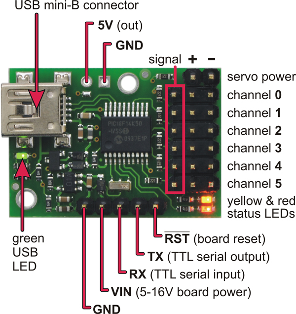

Sorry for the late update, but yes, Darthpaul. I am finished with the joystick servo project.
Its working very good.
Here is a pic of Player 1 servo, (I have a servo on both P1 and P2 Joysticks).
Here is another shot of the same servo:
And here is the servo controller I used:
The controller can control up to 6 servos, of course I'm only using 2.
The controller needs 5 volts Dc for power, and it talks to the computer via USB.
I am using Control Choose plugin for Mala to tell controller to switch between 4 way and 8 way.
Control Choose calls bat files that send servo positions to the controller.
Control Choose sends 4 way or 8 way commands based on Mame game usage, and also for each emulator used. (Example NES uses 4 way).

Here are the bat files that controlchoose calls.
They send a message to the maestro controller (app for the servo controller board), to switch joysticks to 4 way or 8 way.
I had to change extension to txt for this site to let me upload them.
These are batch files and have extension ".bat" in the real world.

I tried to post a pic of the controlchoose action list, but the site wont let me, says its a security risk???
Anyway here is the list typed out:
If Control= joy4way Then Run F:\Arcade\MaLa174\plugins\4way.bat
If Control= joy8way Then Run F:\Arcade\MaLa174\plugins\8way.bat
If Emulator= NES Then Run F:\Arcade\MaLa174\plugins\4way.bat
