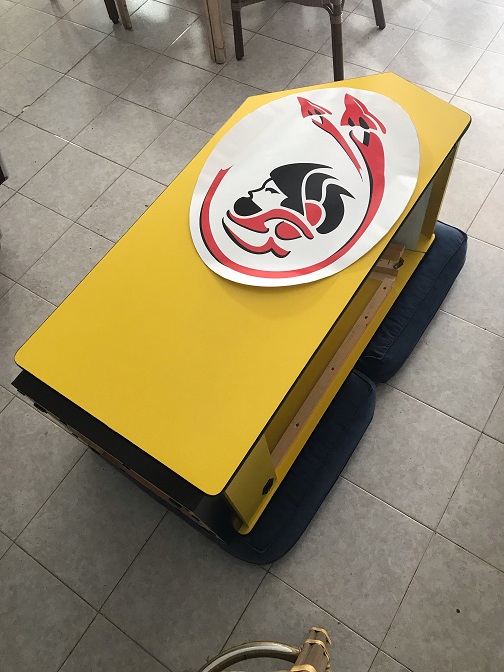

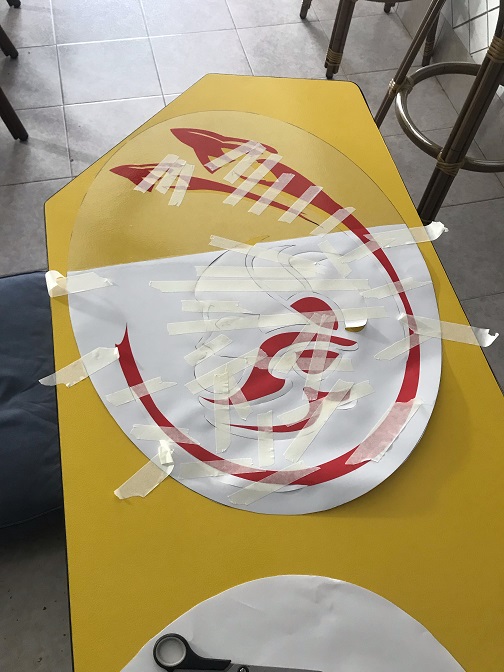

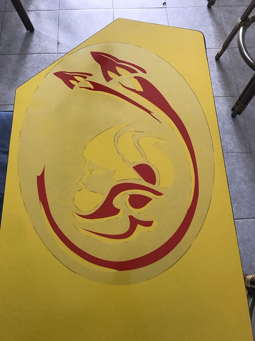

Ive finally found some free time this morning to tackle the bezel art.Been wanting to for days,but didnt want any disturbances mid job.
 First off I got the prints done at Rockstarprint in the UK and am really happy with the quality and price :applaud:
It actually came with a little instruction sheet,and told me something I never would have known otherwise.After cleaning the glass,and spraying water with soap all over,It advised to tape the centre section in place before removing the backing.
 This proved so helpful when positioning the bezel.The bottom edge is really quite narrow,and without the centre holding it all square,I probably would have got into all sorts of dramas.
So its all in place and ive squeegied all the water out and removed the centre.I had to remove a tiny slither from either side as it was just lifting as i tried to slide it back into the cabinet.But a brand new stanley blade,and a metal rule worked a treat.
After Ive got it all back together,was gutted to find that the sort of orange trim at the bottom isnt central:
After checking back in this thread,I can see it never was central and I just never noticed  :dizzy:
Totally confused now how I feel about it.Am going to spend the rest of the day staring at it and see how it grows.

Quick update,to spur me on this week more than being very interesting reading for others.
After finding out the transparent stickers would have looked crap as they were,I decided to cut them up to make stencils.Rather than tracing them as Id originally planned.
I wanted to cut the black parts from one,then use another with the red cut out.Problem was Id only ordered 1 of each,and it turns out they dont keep a record of the order and wouldnt be able to send me exact duplicates.
So I checked on my original prints and decided they were a bit too small anyway:
So I printed out some rough tests and decided on this size:
Today 2 of each side arrived.28 euros (32 dollars delivered). This time I didnt bother with the lamination as I knew there was no chance they were getting stuck on the cab:
Theres a bit more bend to these unlaminated ones,and they are printed on translucent vinyl again,as this should help with placement.
So in the next couple of days hopefully,Ill remove the monitor ( which I need to do anyway to make a cardboard bezel ) and can then lie the cab on its side and either transform its look...or totally ---fudgesicle--- it up.

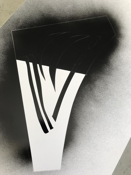

Started the stencil cuts today,started with the black half which will have to be laid down first.
 The black shadowing parts Ive cut inside where the lines are drawn,this will mean the black underlaps the red, rather than struggling with placement of the second stensil and butting the 2 colours together side by side.Hopefully.
With so many cuts,the vinyl becomes unmanageable.Im assuming a professional stensil would have a paper back.And also a clear front peeled off after placement.Mine has a load of painters tape so it keeps its shape during placement:
I bought a cutting board and plenty of fresh blades.This part took about an hour.Ive not had a drink since xmas so hand was steady.  ;D However Im just getting over a bout of bronchitis and am still a bit wheezy,All that holding my breath during the trickier corners has left me feeling quite ---fouled up beyond all recognition---,so Ill tackle the next step tomorrow.

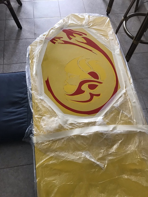

Want to get some of this done everyday now before my enthusiasm wanes.
 Removed the monitor and got the cab onto its side,decided on the placement with the as yet uncut red half of the stencil:
Swapped that over for the cut black paint stencil,Id done a test run with some offcut of the vinyl lightly spraying with soaped water.The vinyl slid about as expected,but the painters tape not as well.So deciided to apply it to the side dry.first half went down great:
Second half was a lot trickier,a bit like laying out a spiders web.Got there in the end and learnt a few things that should make the next 3 stencils easier.Looks great on with no lift or visible problem areas:
Next masked off the whole cab.Using that gossamer thin sheeting you get in DIY stores was more problematic than the stencil  :banghead: .You walk past that stuff and its up in the air like a cloud of smoke:

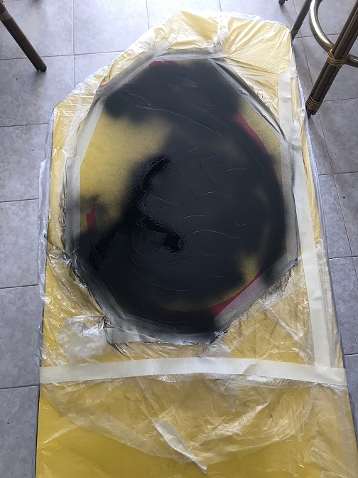

First lightish coat of black applied,and so far so good:
Made a small test peice using some offcut vinyl,and cut a random pattern into it,Was eager to see how bad the first coat would bleed under the stencil,so removed half of it after about 5 mins:
Peeled off really easy,and wasent seeing the spiders legs I was expecting from the uncured paint.Although the test is on laminate and smoother than my side panel,Im confident the cab will have a similar sharp line as well.
 Second coat tommorow.

Back on it this morning.Ran a couple of tests before starting on the real thing again.Watched a couple more YT vids last night,and one guy recomended lightly rubbing over your first coat with a washing up sponge.I gave that a try,and it does very slightly rough up the surface,but also really sharpens up your edge line.Any tiny lines of bleed were removed from yesterdays test peice.
 Gave it a rub over the first coat I had,It really exposes the edges of the stencil,and should help show where the paint needs to be concentrated:
I then got started laying the second coat down.Now the only thing Im still not to sure of is would the paint go on better if the cab was stood up and I was spraying a vertical surface ??
Anyway,I brought a worklamp to the job today and made sure I got full coverage,as there is no 3rd coat.My earlier tests had come up with 12 minutes of drying time seemed about right,so after 12 I removed the masking:
 I found it really hard to not wait longer and let the paint dry totally.But Id run a test earlier,and everyone says peel off while its tacky....So...
Smashed it  :applaud:
 Came off great,and am super happy with the result.
Couple of slight bleeds here and there.But the worst ones will have red over them.
 Going to wait 48hrs for this to fully cure before laying the red stencil.
