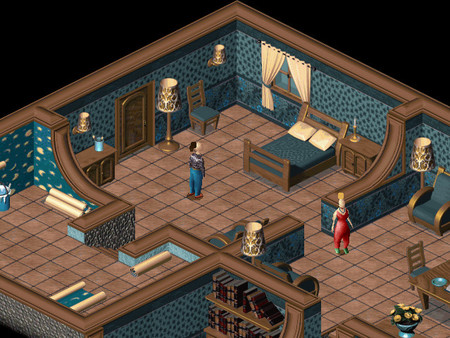

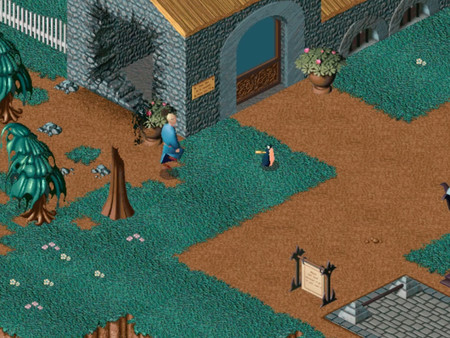

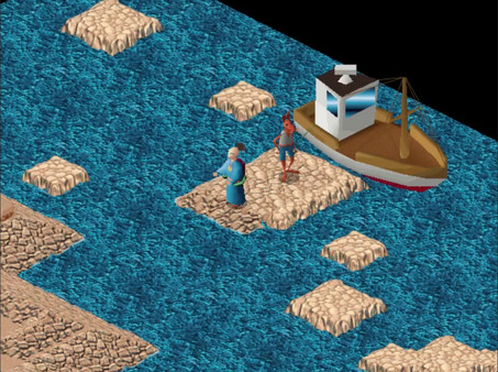

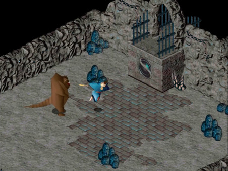

Seeing as the remake is out now and another remake of the second game is in the works.
Why not play the enhanced originals in there "native" resolution with bug fixes and support for gampads.
Twinsen's Little Big Adventure Classic
GOG.com
Steam
Native res is 640x480, scales perfectly in
320x240
Twinsen's Little Big Adventure 2 Classic
GOG.com
Steam
320x240

I don't know steam or gog version, as none of the images you uploaded are 320x240, but the original msdos version was 640x480. Maybe doesn't look bad at 320x240, but native res was 640x480
The images are actually from steam and are in 453x338 no idea why. I just used the forum tools and resized them. But will display correctly if you click on them.
You are absolutely right.
Error on my part.

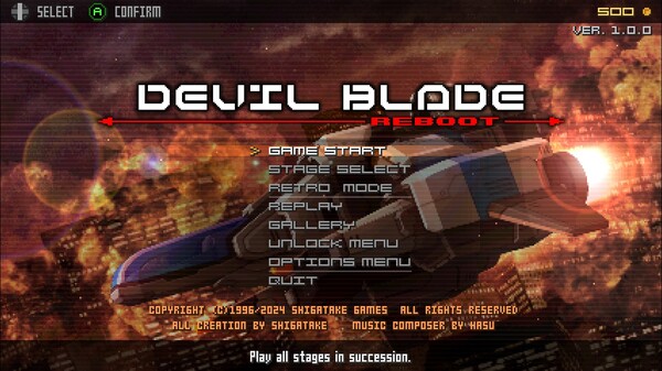

DEVIL BLADE REBOOT
Steam
Update v1.0.6 added proper 4:3 (320 x 240) display mode.
Latest version is v1.1.3
Steam discussion board 4:3 mode
320x240
