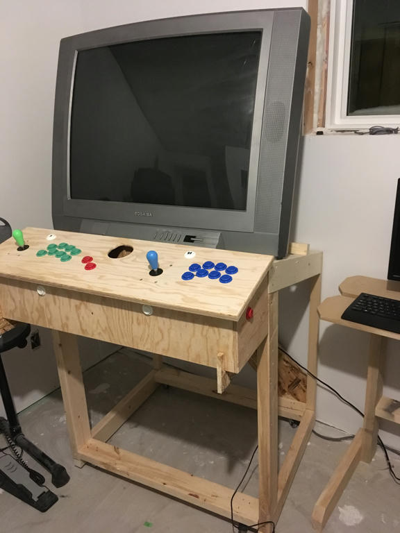

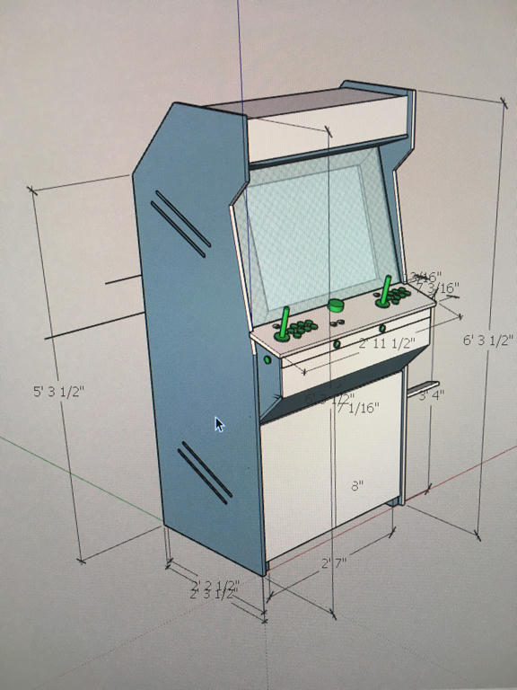

So I figued it was time to start a thread, would have much sooner (I could have really used a place to solicite feedback) but couldn't upload from my phone so easy..
So the journey begins in Sketchup

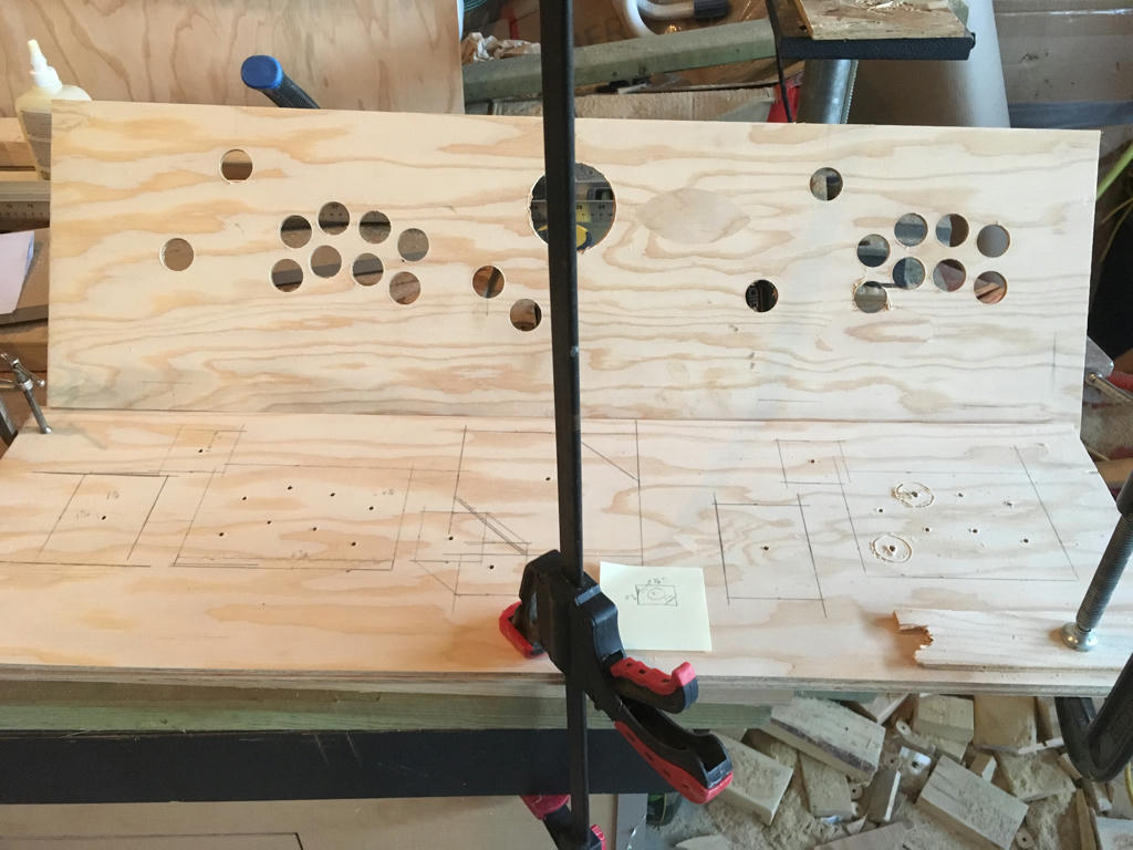

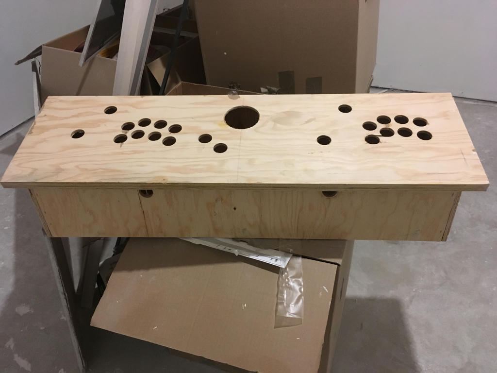

Then a control panel prototype

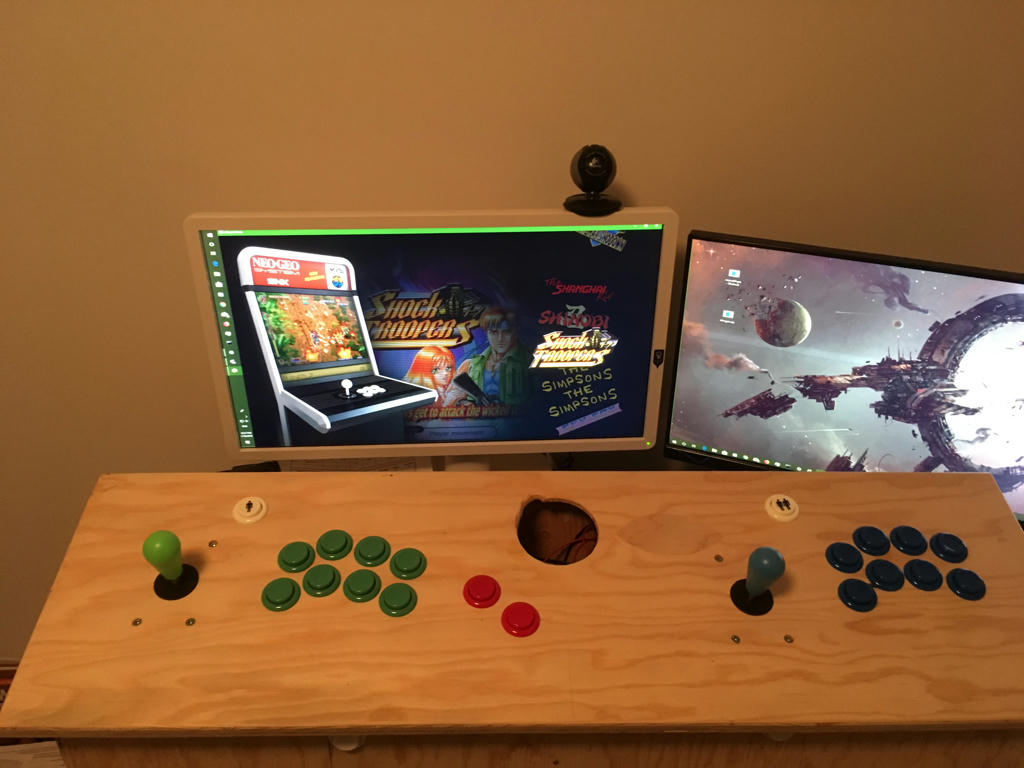

I believe this was the Sega Layout I found online.. now with some nice Seimitsu sticks and Fusion buttons from Retroactive Arcade

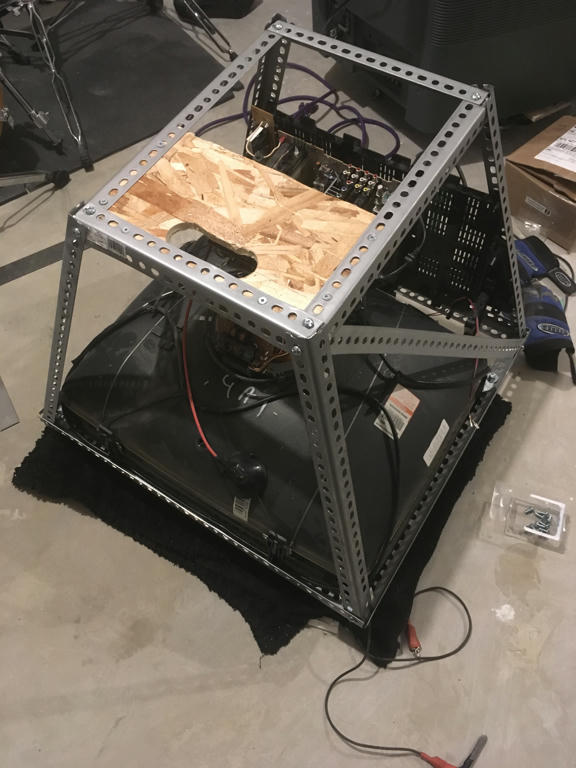

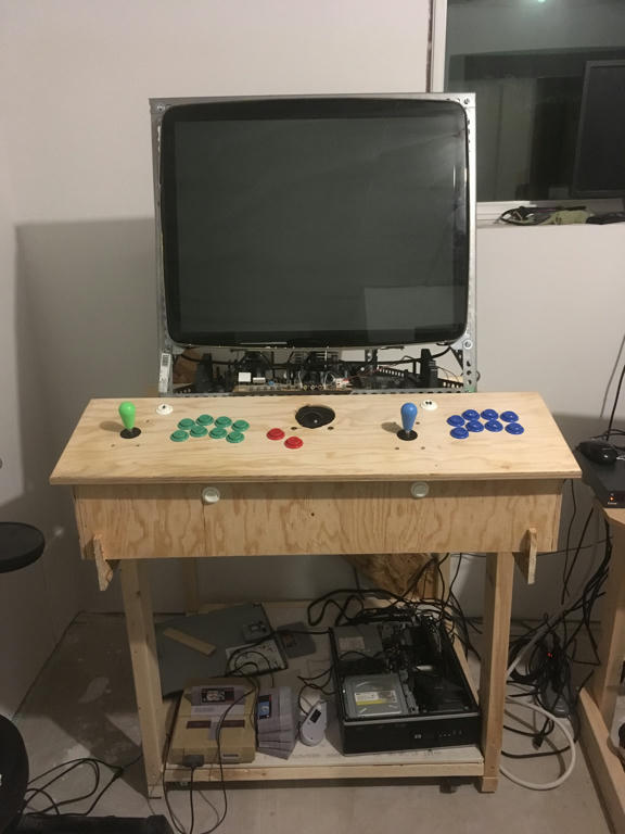

Messed around in MAME for some time, mostly figured that out, found the Attract Mode front end.

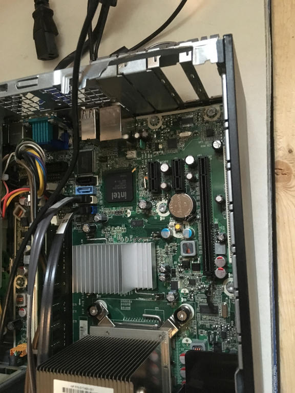

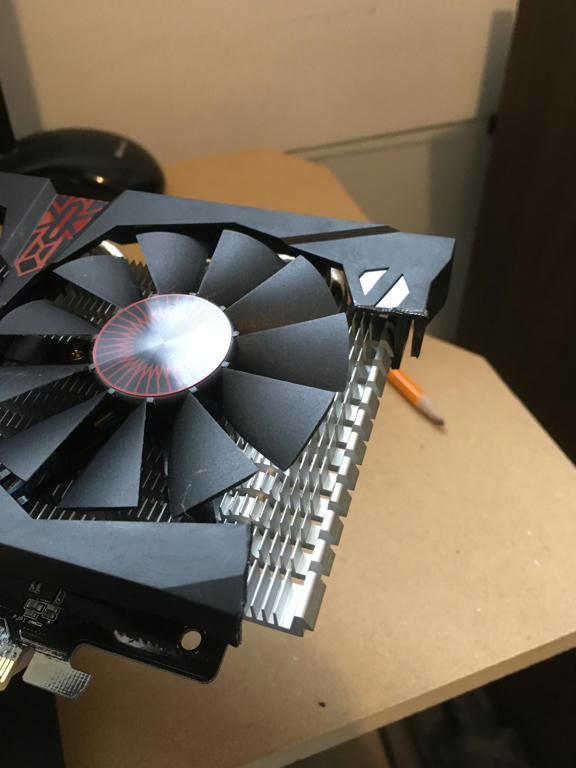

Picked up an old Dell PC, took the cover off, cut out chunks of metal, trimmed down the fans on my 750ti GFX card and slapped it in.
Now getting MAME running on a CRT television, testing with my 32" toshiba that decided not to sacrifice to this project.
What I eventually settled on after trying many things, and finding out that even though NVidia says it can run 240p it doesn't mean it's true, was the Extron VSC 150. It's a 480i image but does look pretty darn good on the Wega.
See this thread for my bumbling: http://forum.arcadecontrols.com/index.php/topic,159697.0.html

Decasing a CRT is another adventure, managed to ruin one 27" Wega by cracking the control circuit panel, I advise a second set of hands because the boards like to slide right out of these frames when you lift them from the front of the case. Ditched the speakers and built a frame that would allow me to build a cab that will fit through a doorway, want to be sub 28" wide.
The happy accident here is that the second Wega I found in the local buy and sell had a way better picture!  :applaud:

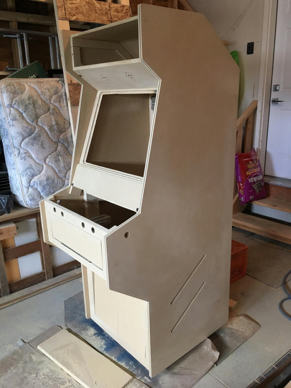

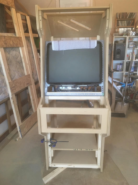

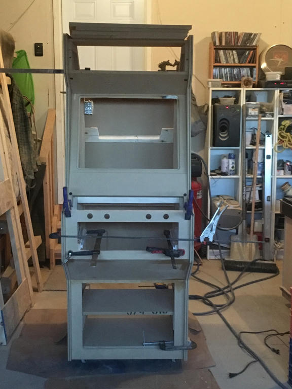

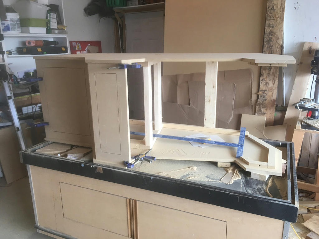

Cutting out the sides
Went with an inner 2x4 frame, caused perhaps more headaches than benefits. Was slightly out of square and spend a fair bit of time fighting it and trying to right it. If one just build off the perfectly straight MDF I'm sure it would line up much easier, maybe a little weaker? IDK
Test fitting the CRT, had to do some grinding and adjusting when I found out it was about 1/8" too wide  :banghead:     but got it...
Glue up stage, the time when you never have enough clamps or patience.. You may notice I screwed up my bezel because of being a router noob, was able to rebuild that corner with paintable silicon. So I hope that once painted black and covered with glass, the bezel errors won't be visible.
This is basically where I'm at today, I've since this installed all the hinges and a keyboard tray.
The next step will be more fit and finish, bit of filling. Take it apart and start to prime  ;D
Does anyone have an opinion on my speaker holes? I am assuming they will let enough sound pass through as well as the board will resonate well enough to provide decent sound quality.

Good quality work! Love the monitor.
I have a small suggestion for the speaker holes. I'd cut out the full sized holes and then accentuate them with either a cool speaker cover, some LED lights, or even some mesh wouldn't look out of place. If the question is, do I think enough sound will pass? Yeah, I think it'll be ok, but I think it would be better as a big hole, or maybe with more smaller holes.

Looking good. I was running a 27" Wega for Vertical Shmups and they are great tubes. Damned heavy tho. How much you fogure this will weigh when done? Moving it will be dun, but then youll be set. The 2x4 may seem excessive and add weight, but as i noted, that tube is damned heavy, a little insurance never hurt anyone. Well maybe their back, but thats what friends are for ;)
Those speaker holes should be changed. Thats a lot of resistance on a speaker. Youre bascally using a diaphragm to force air through those little holes and any backpressure is felt by the tiny cone of the speaker that im sure isnt made for insane amounts of pressure. It will skew the balance of frequencies. It may be a bit louder if loaded right, but that more of a science, and kind of pointless, and frequency dependant. High frequencies will be very muffled.
That auction site has nice little speaker covers for small drivers that look like the grills off a Vewlix, very unobtrusive. If too bland, they make ones with chrome trim too. Theyre cheap. Look pro. On my cab, I just cut holes and put some perforated steel on the backside so it looks kind of factory as opposed to just sticking a piece over the hole and looking kind of thrown together. Speaker grills look best unless you want to try the slots in wood trick Nintendo used, and I suck at it hahah.
I had similar issues with stuff being square etc. At end of the day, the material is only going to be as square as the toold we use. Finding a saw that can stay square and cut reliably is my biggest want. After that, buildng anything out of different woods will be a treat. If i have to buy my material though, I am buying ply next. The MDF dust, and the way it crumbles easier on sharp edges than real wood can be a bit frustrating, and thats before you even go to paint it.
My biggest reservation is that MDF was never made to be in a damp dank basement, garage etc over long periods of time. That ---steaming pile of meadow muffin--- swells and goes crap right quick if given the right conditions. I feel like if they had used MDF like we know it today in 1982, Im not so sure how some stuff would hold up. Even that particle board seems better than MDF. And i say that as someone who uses MDF for certain applications, even tho I would prefer ply unless I had to do other.
Keep up the good work. This is gonna look great.

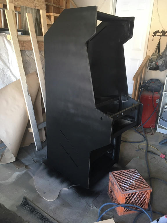

Not totally sure, but I think the empty cab is like 200lbs and finished 300+. Built it so one could move it with a dolly from behind, plenty reinforced, but will likely assemble it all in the basement where I can just roll it around on its casters. I'd better listen to the advice I'm getting on the speakers, might have made it a little trickier now with the speaker panel glued to the bezel  :embarassed:

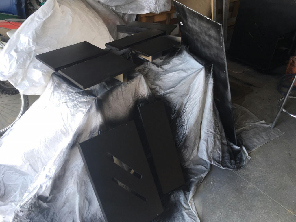

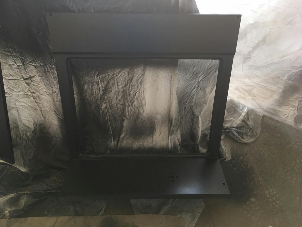

Painting now, 3 coats of primer and up to about the same in paint. Using a melamine-finish black furniture paint, turning out pretty nice so far.. kinda wet sands weird, pills up and clogs up the 220 really quickly. Maybe I'm not letting it dry long enough before sanding?

Last summer I redid a bathroom Vanity using that Melamine paint. It was sold as the ultimate product.
Whether due to weather, or what, it was one of the worst products I've used. It showed EVERYTHING as it's quite glossy. It took forever to dry, and even then it was not easy to sand and just gummed up the paper as you noticed.
I resanded and tried again. So much so that by my third attempt I just made MDF flat panel doors to replace the originals and painted it all in an Eggshell latex that gave me the finish I wanted in a timely manner.
You're lucky you chose black... My navy blue melamine paint turned out more Electric Blue than the swatch due to how it caught light.
Last week I threw out the old cabinet doors after sitting for almost a year in the house, and that melamine paint still looked like crap and was more sticky than hard. I've got another can I'm tempted to just take to the Re Store and let some other brave soul try it.

Oh dear, that does scare me a little. I made a few mistakes that I had a hard time ridding and went through a pile of sandpaper, it’s soft right now but I assumed it just needs to cure. It is maybe a little too glossy as well, if you can see in the pic there’s some streaking on the sides, I had my air pressure too high for my sprayer. I’ll give an update as to whether it hardens up or not.
Spent some time assembling yesterday and hooking up all the components  ;D

Yeah I'd cut down the height of that control panel by 1/2.  And what's up around that trackball?  The first picture you posted where you cut the holes the trackball hole looked fine and then the next pic with the buttons installed it looks like a chunk is missing at the top left of the trackball hole.  Then the next picture with the trackball makes it look like it's not centered with another chunk missing lower left and it doesn't appear to be level with the surface.  I also don't think you want those 2 red buttons getting in the way of using the trackball.  Another thing that happens with a 2 player layout like this is 95% of the time you are using it by yourself and it will feel like you are too far to the left.  I know because mine is built that way.

No no. That’s my prototype control panel. I threw it together to try button layout and set up my games etc, actually it was built around a 32” T.V. but downsized to a 27” now
The CP is going to be a flat 3/4” slab with about a 1” overhang. Question, I envision using ash or maple with a clear coat, thoughts?

1.) Getting that CRT to look good you should really be using an AMD graphics card and install CRT Emulation drive to get a beautiful picture (with GroovyMame)
2.) I hesitated to say it but that tube will give you trouble with a number of games and their proper vertical size and refresh rates:  (http://forum.arcadecontrols.com/index.php/topic,159464.0.html)

Working on the CP today, got a good fit, going to trim it with 1” maple
The big question is clear coat or stain? I’m leaning towards some dark have stain I’ve got.

yamatetsu
  • Posts: 2734
  • Last login:Today at 06:31:32 am
  • Just because.
Re: My 27" WEGA Project
« Reply #37 on: June 09, 2019, 05:37:11 am »
The CP does look good, but IMHO it doesn't fit stylistically. The whole cab is painted black, no wood grain visible, and you've got one piece that is left 'natural' and very bright to boot. If I look at the cab, my eye is immediately drawn to the CP, because it's a bright spot that doesn't fit. It's like those pictures you have to look at and tell which piece doesn't fit.
I'd at least use the dark stain on a piece of scrap wood and see if that would make the CP darker and still looks good. You'd still have the contrast between the painted and the natural look, but it wouldn't be that glaring.
Other than that, I would do the whole front of the cab in maple, so the look of the front is consistent and has a nice contrast to the painted side panels.

« Reply #38 on: June 09, 2019, 12:20:46 pm »
Yah Yamatestu, that’s what I’m worried about. I’ve been stuck on the wood grain cp, maybe I’m just sick of working with mdf. The entire front in maple is a cool idea, but may have to save it for next build, I could trim the marquee with it rather easily.
Here’s today’s update, spent hours yesterday sanding and tweaking, next dilemma is how to mount the ipac, no room will have to build a stand off to keep it attached to the CP.
This picture is prior to routing etc, I’ll update in a bit.
Edit, new pictures
« Last Edit: June 09, 2019, 02:05:38 pm by MiteWiseacre »
