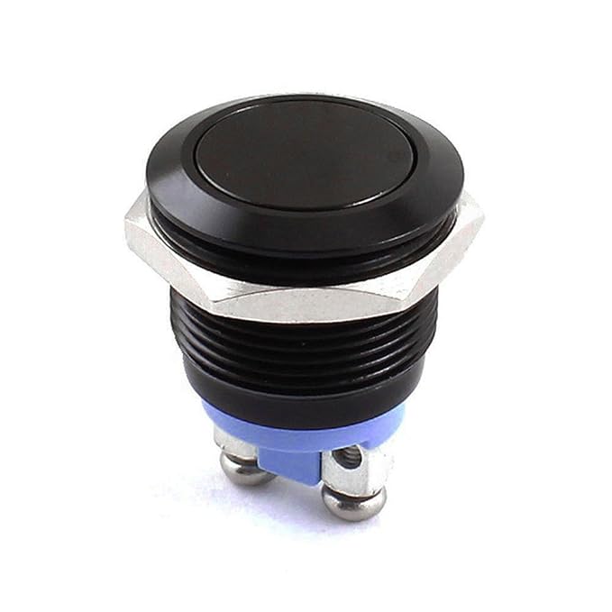

First question for you guys.  I’m building the rear panel and trying to decide what to put back there.  I have a power socket that will go on the right side and a power button and volume knob that will go on the left.
I’m ripping apart a pair of $10 AmazonBasics speakers and I plan to relocate the volume knob to the back panel.  I want the ability to control the volume even though I could shift that function.  The knob will be out of sight and this needs to be simple to operate.
I have 2 buttons I could use for power.  One crappy 1/2” red button that will be fine and one cool looking PC button that has an illuminated blue ring of light.  The problem is that no one will see this and I do not want it on the front of the cab where it could get accidentally hit.
So my question- which power button would you use and how would you lay out this panel?  The socket could be installed vertically or horizontally and power and volume could be side by side or on top of each other.

I'd use the lit button just due to the fact that the other one sticks out and could get bumped accidently.  Or just pick up a vandal button separately.
Hmmm... the vandal button looks pretty nice.  $7.49 shipped from Amazon so I ordered.  I'm probably overdoing it but whatever...  I'm a little over $200 into this thing already!
Ouch they're only $0.99 shipped from Honk Kong If you don't need it right away ! - https://www.ebay.com/itm/16mm-Anti-Vandal-Momentary-Steel-Metal-Push-Button-Switch-Flat-Top-New/282875701924?epid=28016226143&hash=item41dcb4aaa4:g:Kv0AAOSwpFtaoNvh
Gah! Oh well - I don't really care but the $7 savings would have been nice!  Mine is set to arrive Saturday, which is perfect because I plan to work on this thing over the weekend.   :cheers:

Good choice on the vandal switch :) As for the panel, I would mount it horizontally,  have power socket one end, volume in middle and vandal switch at the other.
A horizontal mount for the socket seems good but that means the plug is sideways... not that it matters.  I'm leaning that way.  I'm going to keep the power button and volume knob to the side because I want them to be easily reachable.  If I put something in the middle it could be a pain to use.
I might go with on/off on the left and both the power socket and volume knob to the right.  This way there is no way to accidentally turn off the cab when you just want to change the volume.  I'm still playing with it.

Put the volume knob and power button on the top near the back.
Good idea.  Power for sure since it is flush with the top panel.  The volume knob will stick out and annoy me but this will free up room on the rear panel for volume on the left and power socket on the right.  Problem solved... I think.

I managed to find about 90 minutes to make a little progress today.  Slow going with all the kids activities as the school year winds down.  Now that the sides were cut, I could start making the interior panels.  They are all 9-5/8" wide so I had the guy at Home Depot rip down a piece of 1/2" MDF to that width so all I had to do was measure the length of each piece and cut the panel with the chop saw.  Easier said than done.  Each panel is a little bit tricky because of cutouts or angled joints.
I started with the top panel above the marquee and the panel on the top rear of the cabinet.  Measuring the length was easy but these panels meet at an angle and that took me a few tries to get just right on the saw.  The top panel also gets the power button (thanks Mike A - more on this later) and the top rear panel is gets three 2" holes for ventilation.  I used forstner bits for all of the holes.
I must have measured and cut this angle 3 different times to get it just right - the angles on each piece are identical so once I figured it out it lined up perfectly.  To glue the panels together I just used my hands and a lot of patience.  I held the panels in place for about 30 minutes making small adjustments as needed and using my fingers to make sure all edges were flush.  I was a little nervous but it worked.  I tried clamping initially but the pieces wanted to shear away from each other when I tried to tighten things up (even with a jig I tried making).  I'll sand the excess glue away before painting.
Everything was going smooth until I went to drill out the hole for the button.  The package said a 3/4" hole would be sufficient so that's what I did.... except when I went to install the button I realized it was not long enough for the fastener to catch!  I needed to drill a larger hole on the inside but only go about half way through the MDF but without a center point this is difficult to do accurately. I ended up cutting a piece of wood to fill the hole the best I could, found the center point of that and then drilled the hole.
Success!
It has just enough clearance on the inside too.  I chose the left side of the cabinet to match where I'm going to put the power socket on the rear bottom panel but I guess it could have gone anywhere.  The location is perfect - easy to access but out of the way of everything else.
I really like the look of this button so it was worth the extra $7 to me.  This panel will eventually be painted black so the button will blend right in.
