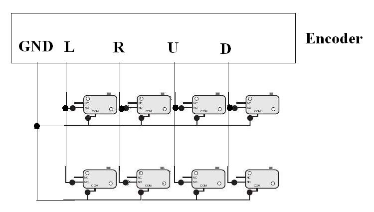

Are you thinking about the panels that have a dedicated 4-way stick for Donkey Kong, Pac Man, etc. ?
I think so, what kind of card do people use in order to hook the 4 way stick up?  The same i-Pac type thing?
You can use whatever encoder(s) you prefer as long as they have enough of the right kind of inputs.
See part 5 of the FAQ about Encoders for important considerations when selecting the encoder(s) for your build.
(PROTIP: Read the whole FAQ.  It's there to help you.)
You can wire a dedicated 4-way stick in parallel with the P1 8-way stick.
Each row of microswitches is a separate stick.
When lines cross, a dot = connected and no dot = not connected.
Your choice on whether you want to "daisy-chain" each directional input as shown or run a separate input wire from each microswitch to the directional input.
