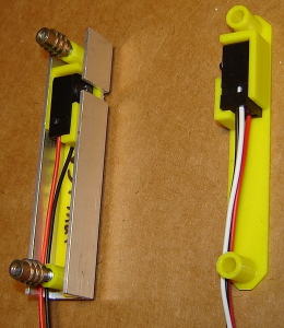

Bounce Issues with Optical switches - may help someone with conventional whisker switches as well...
I just finished converting to optical switches and had issues with random multiple scoring. The solution for me was to go into windows, Settings, Accessibility, Keyboard, selected "Filter Keys", and switched "Ignore Unintended Keystrokes" to "On", and lastly set "Wait before accepting repeated keystrokes" to "0.3 seconds". After a restart, no more multiple scoring.  Different versions of Windows (I am running Windows 11) may be worded differently, but the same theory applies. Since the IPAC board for my setup is considered a keyboard to the computer, this eliminated the double bounce scoring issue for me.
Hope this helps someone else if they are experiencing bounce scoring.

I did the same thing But now if you tap the right or left arrow to fast it wont let you scroll through the games. You have to hit it at a slow rate.
