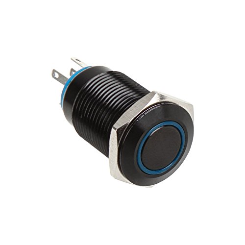

Hi Bperkins01 - quick question - how did you end up wiring it so that the power strip would be powered upon the start-up of the computer?  I didn't see any mention of how you tied the powerstrip or power supply.
I went with a smart strip and the panel mount switch.  Connectors, heat shrink insulation.  I rather like this part of the process – getting all of the wiring in place.
This next part I will go into a lot of detail – not necessarily because it is particularly complicated – but because I could not find this information anywhere – I scoured the internet and found nothing on this specific type of power switch..  So Google, Bing and any other search engines – find this so it can help some others out!
The PC I got is a Dell Inspiron 3668.   My plan is to put a lighted LCD switch below the CP.  One switch powers on the PC – the power strip senses the power coming on and turns on everything else in the cabinet.
The internal switch on the PC is an 0HKFHK7 (Above).  All of the Dell power switch connectors I found documentation on were 10 pins.  This is an 8 pin power switch connector.
Below is the connector on the PC for the power switch that I could not find the pinouts for.  But… I was able to figure out what the pins do to set up my remote switch.
1 –  LED negative
2 –  LED 5V+
3 – Momentary switch
4/5 – Unused
6/7 – Momentary Switch (must be tied together or the BIOS will report defective switch hardware)
I cut the original switch off, saved the connector and added dupont pins.  Cutting open the switch and a little testing got this part figured out.

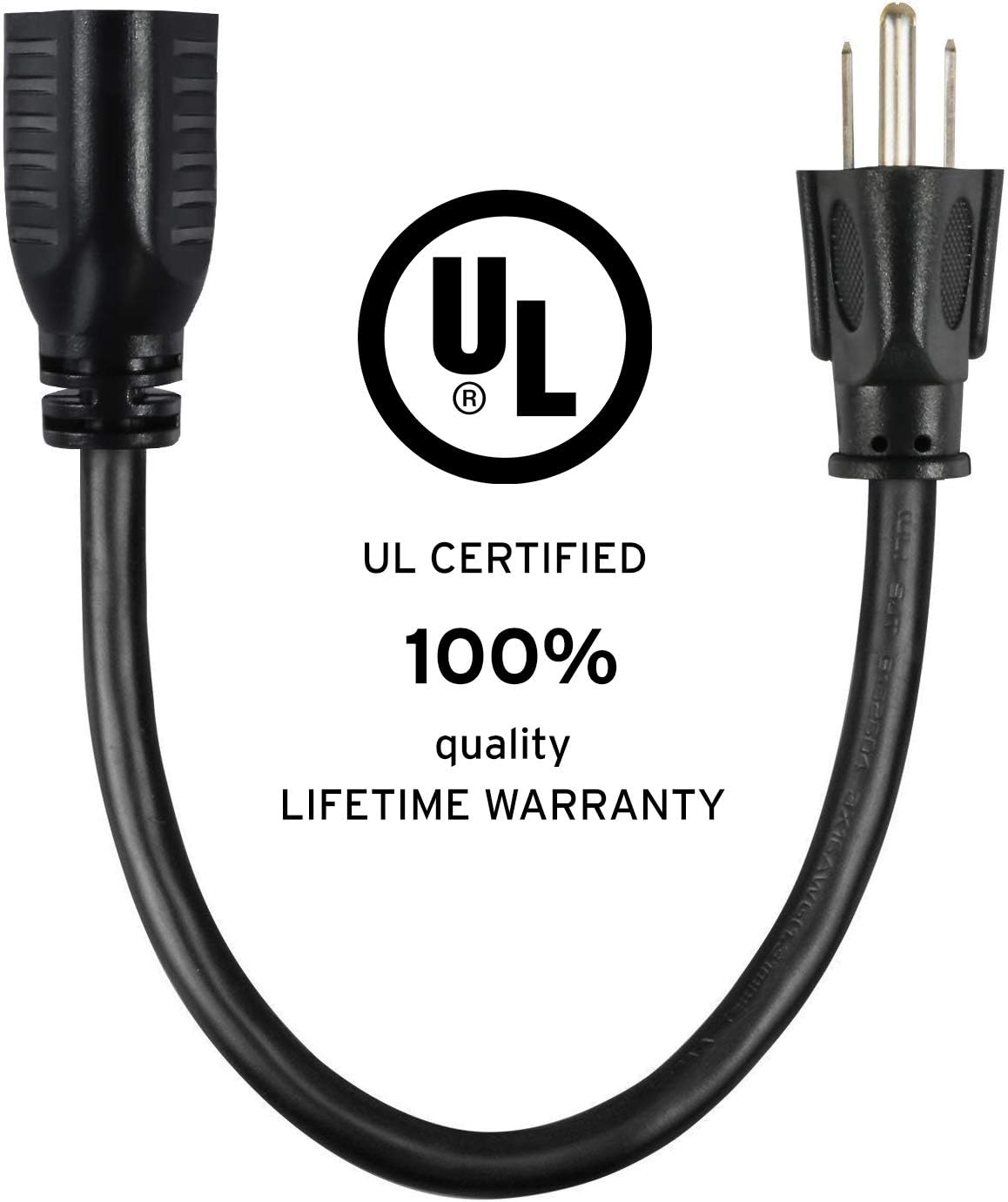

I saw that you did this, next go around try these,  this way you dont ruin a 40.00 smartstrip, and way easier to replace the smartstrip should you ever need to.
Cut it in half, used female side to plug in smartstrip now you have your bare wires for the cabinet plug with the smartstrip still in tact.
Thanks - but the smart strip is part of the cabinet and the adapter is just a failure point to me.. If it fails - its getting replaced.  Also notice I cut off a good 3-4 feet of extension cable on the smart strip.  I prefer a clean wiring job.
  Thanks for the suggestion however.  You read through a lot of pages to get to that part   :)
