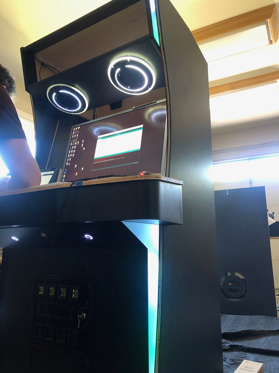

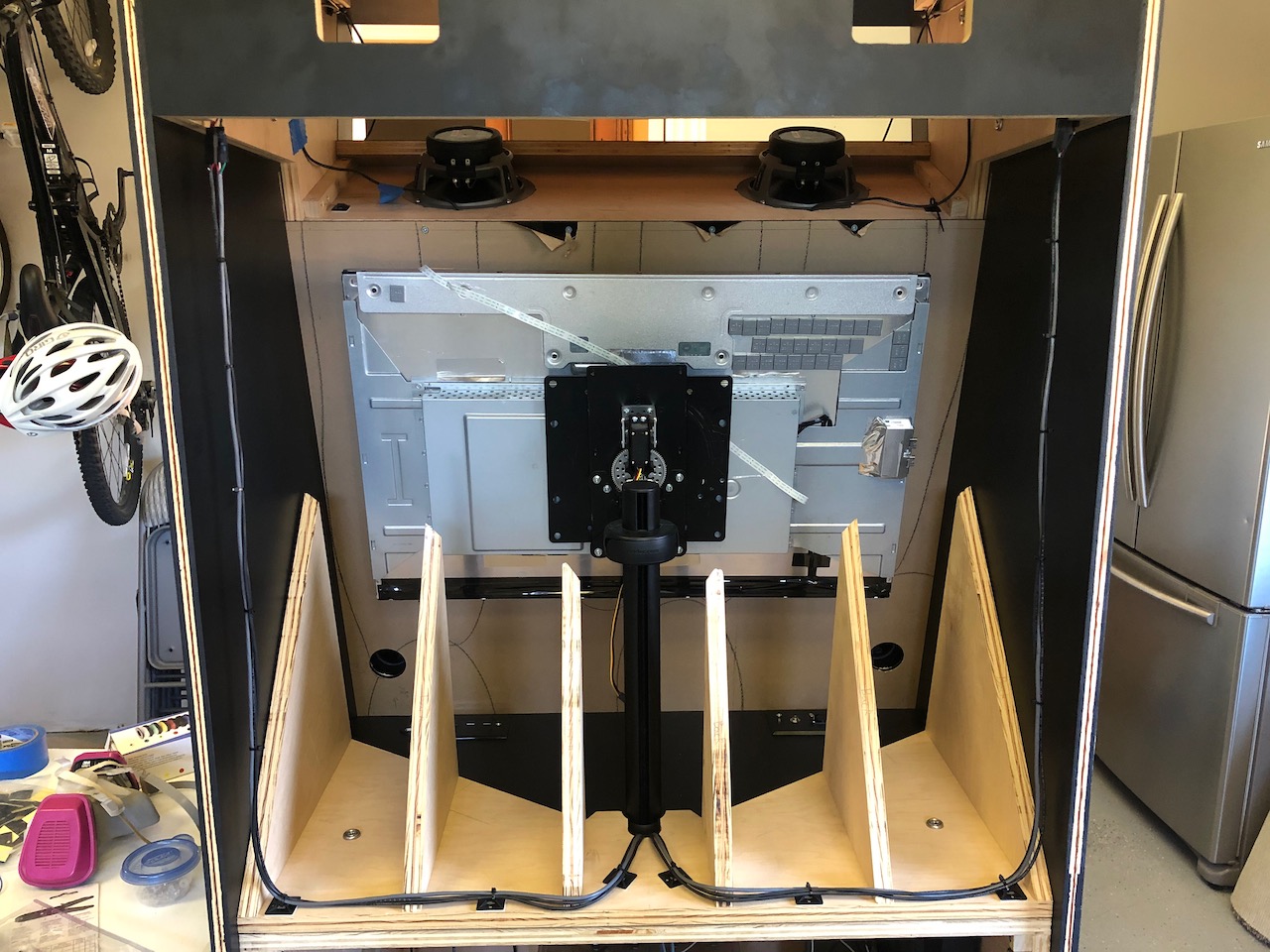

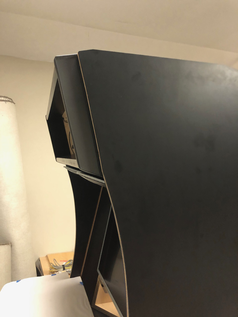

Time to update this thread.  A little over a year into actual construction and overall I’m pretty happy that I’m this far along considering my glacial pace of decision making.  Having said that I really want to get this thing wrapped up as I have other projects I want to get to…..so:
Got the pole for the monitor mounted and in turn the monitor:
Had to modify my design to accommodate the circle cut outs.
Needed to mount the smoked Acrylic (37% light transmission), however couldn’t have it sitting on brackets, so I needed to slot cut into the sides and bottom.  Used the plunge base that came with my Makita for the first time.  Tried to get cute with making the slot fit the Acrylic which is almost a 1/32” shy of 1/4” and it was a waste of time.  Instead used a 1/4” bit and it fit perfect:
Lined up good thankfully.
Also installed the power & communications ports as you can see two pictures above & below:

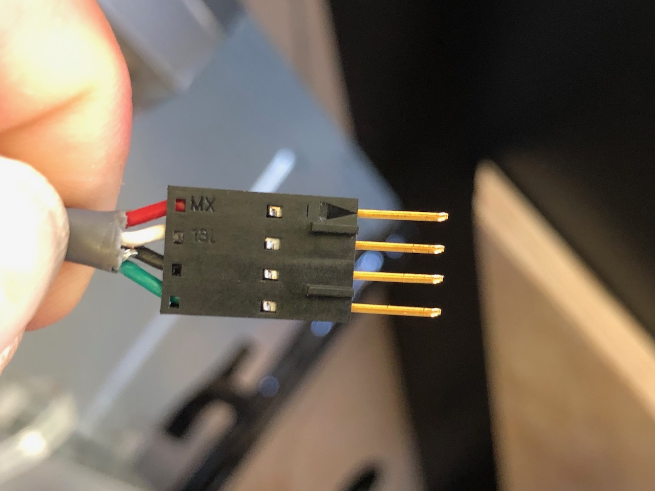

Used the traditional DC barrel for the 5V line, and used a XLR communications port and head for the 24V and 12V lines.  Was a little concerned about using them for power but tested them drawing max current for many hours and they were cool to the touch.  I didn’t want to use the same connector type for multiple voltages so I or someone else couldn’t accidentally plug the wrong voltage in and blow PCB/LED’s.
Finished off the back interior of the control panel.  I had mentioned over on wp34’s thread that I am using the “hinge” technique for a lot of laminating now.  In doing so I have learned that it is really helpful to mask off the surrounding sides with tape so that any excess contact cement can be lifted off.  This is very helpful when applying because if you leave the contact cement it can grab onto your piece and screw with your alignment:
About to apply using hinge in the corner:
I had pre-cut for length the laminate and tested it many times before I felt comfortable on the width as there was no way to trim it after installing.
Next was slot cutting around the marquee for t-molding:
Close up of the embedded acrylic that shows the unlit color more accurately:
I found that pressing the t-molding in with my thumbs and palms was just as effective as using a rubber mallet and microfiber.  In some ways preferable in that no matter how thick I made the microfiber it still left minute impressions in the t-molding (I’m very picky though).
Anyway close up of the molding:
And current state of things (poor lighting):
I’ll be working on computer mounting, power, wiring, monitor surrounds, etc.  Also have something special I’ll be working on in the next few weeks.  Need to nail down marquee and then work on CP.  ---steaming pile of meadow muffin---’s gettin real.

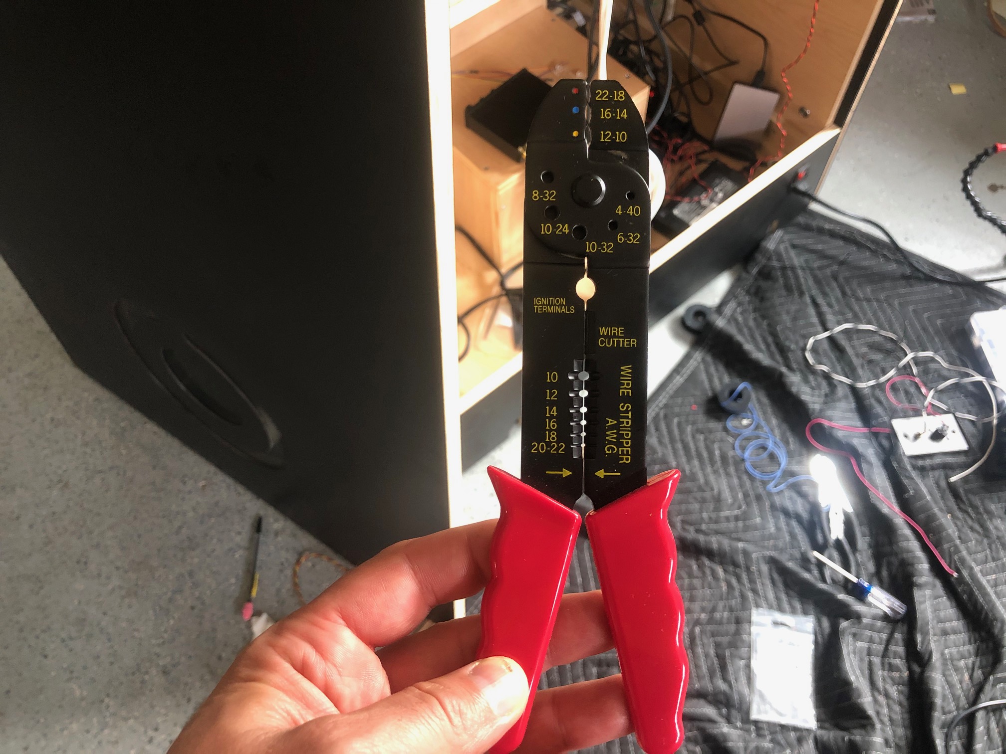

Wow, it’s been way too long since I updated this thread.  (WARNING - long post incoming)

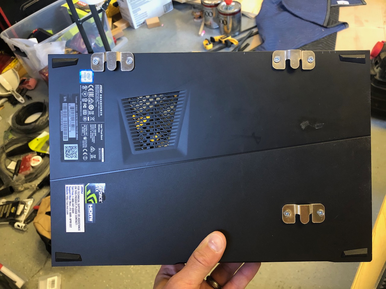

Started on the electronics.  Figured I’d mount the larger items first, started with the computer.
Bought some picture mounting hardware and managed to get three of them on there before it started to get dicey with interfering with electrical components.
Next was wiring up the 120V outlet.  Used 16 gauge wire, 0.187” quick disconnects with shrink tubing to keep electrical insulation in place.
Crimped the quick disconnects on the power cord of a power strip that I bought as well

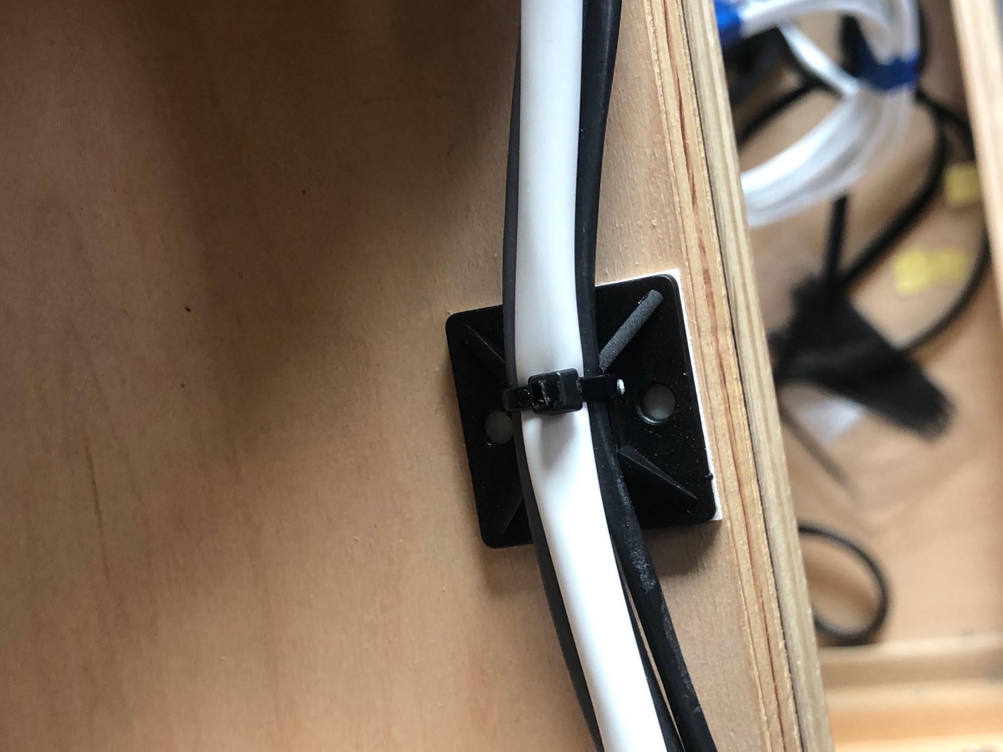

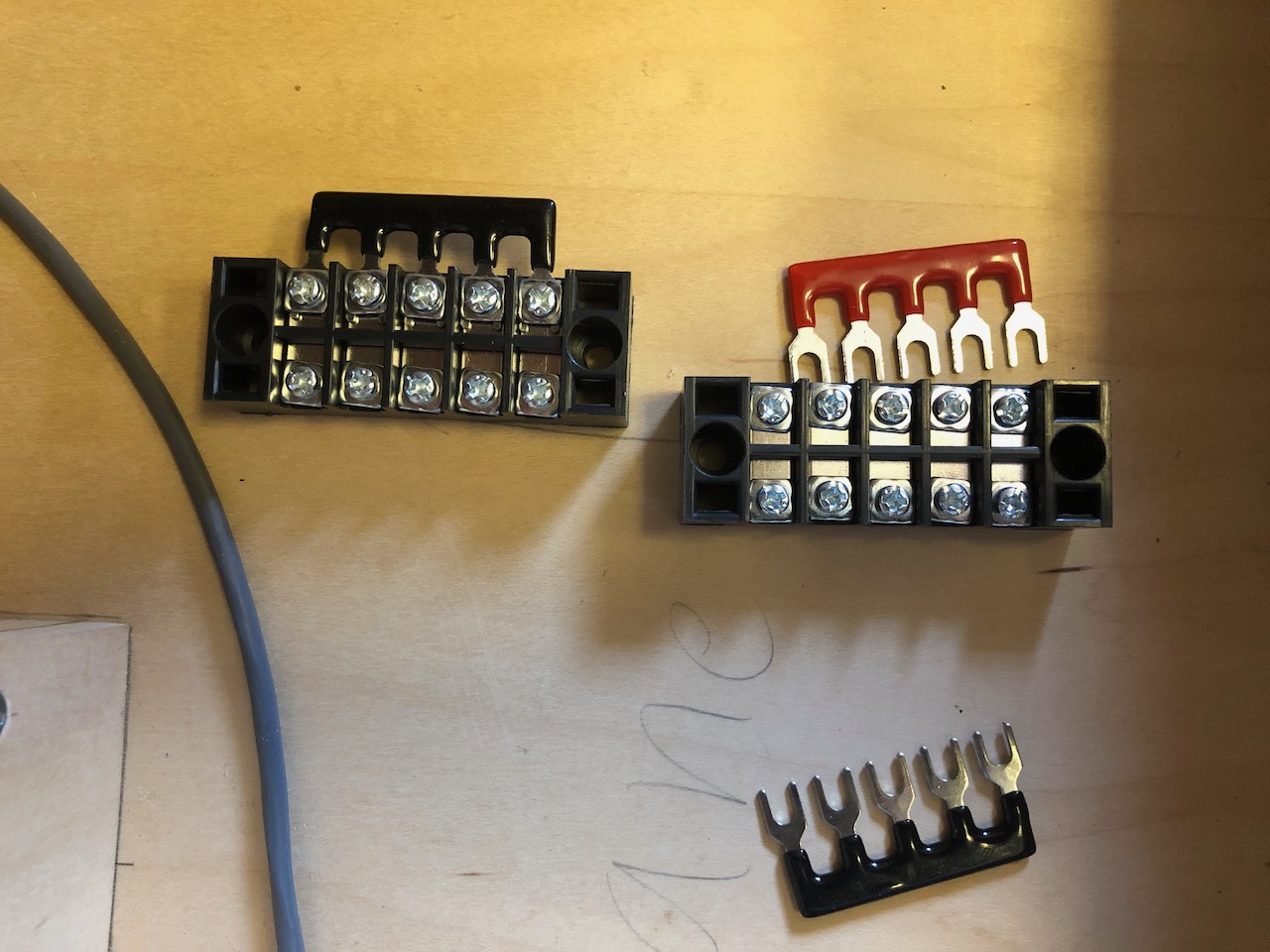

As I have quite a few LED strips I wanted to keep the wiring clean, so I used a Euro Terminal block, but this one was cool cause it includes conjoined spade heads and saves you some work and trouble:
Ran power from the +5V and 12V from the arcade power supply I got at Paradise Arcade:
This way I now have 4 additional terminals to connect the wires to for each voltage (ground up top in black, and positive in red).

Here are the upper LED, and Disc LED cabling neatly zip tied with connectors near the top (hard to see):
The zip ties behind the monitor will be replaced with velcro strips so I can easily remove them.  Speaking of which these are attached to these guys:
They are cool double side taped plastic squares with holes to feed the zip ties to.  Bob turned me on to the them and they are very handy.

Here’s the LED wiring coming into the Euro EDIT: Standard terminals:
Those are insulated 18-22awg spade heads that have a very different crimper than the others:
Anyway the red wires are for power, the black for ground and the green are data lines that get fed to the Arduino Uno (one picture up):
To test the LED’s I needed to break down and remove the tape from the acrylic inlay.  There was residual residue from the contact cement where it met the acrylic.  I used some canola oil to wipe it off (most people don’t know that this works well with most adhesives).  However I should have used rubbing alcohol as it dries on it’s own.
Close up of the residue:
Cleaned up nice though:
Lite em up:
I plan on using these subtly, and in frequently, soft glows and occasional movements, not bling it out.
Here’s a quick animation so you get the idea:
Lastly after some time I got the monitor rotating in the cabinet for the first time.  I actually had to go back and refer to my tutorial in the Automated Projects thread because it has been two years since I got this thing moving (damn time flies).  Glad I did that because there were a few things that I couldn’t remember.  I even needed to spray a little WD40 between the magnets and the VESA mount to make it spin smooth :laugh2:
Here she goes:
This is a really cool/subtle use of the lighting.  Not too flashy but still catches the eye.  Very nice!  Man, I wish I had a clue how to add LEDs to even a control panel...
Here she goes:
SICK!!  Rotating monitors never cease to amaze me.  They are just so cool.  Does your front end switch to the proper orientation or does exiting a game always rotate back to horizontal (assuming you are vertical)?  You are going to be able to play so many games on this thing.
Going to continue to work on the software and LED programming while I can, and cleanup this wiring mess.
Keep it going - finish line seems close now!   :cheers:

Awesome update. I've used those little adhesive squares for many years. They are really handy. It helps if you put a small dab of glue on them as the adhesive will come away after a time otherwise (although you might get away with the ones on a horizontal surface).

Nice job getting it all together Arroyo - Glad to see its all together one last time.   :cheers:
Nice wiring job.  fwiw - you can use the opposite side of those wiring blocks too - even though the jumper is there..

Here she goes:
That is sick!  I love that you are taking your time with this project because it just keeps getting better and better.
I love how subtle the lighting is turning out as well.  Great job Arroyo!
That's a good point, I suppose you can cram a spade head into the jumper side as well, hadn't really considered it, but should work.
