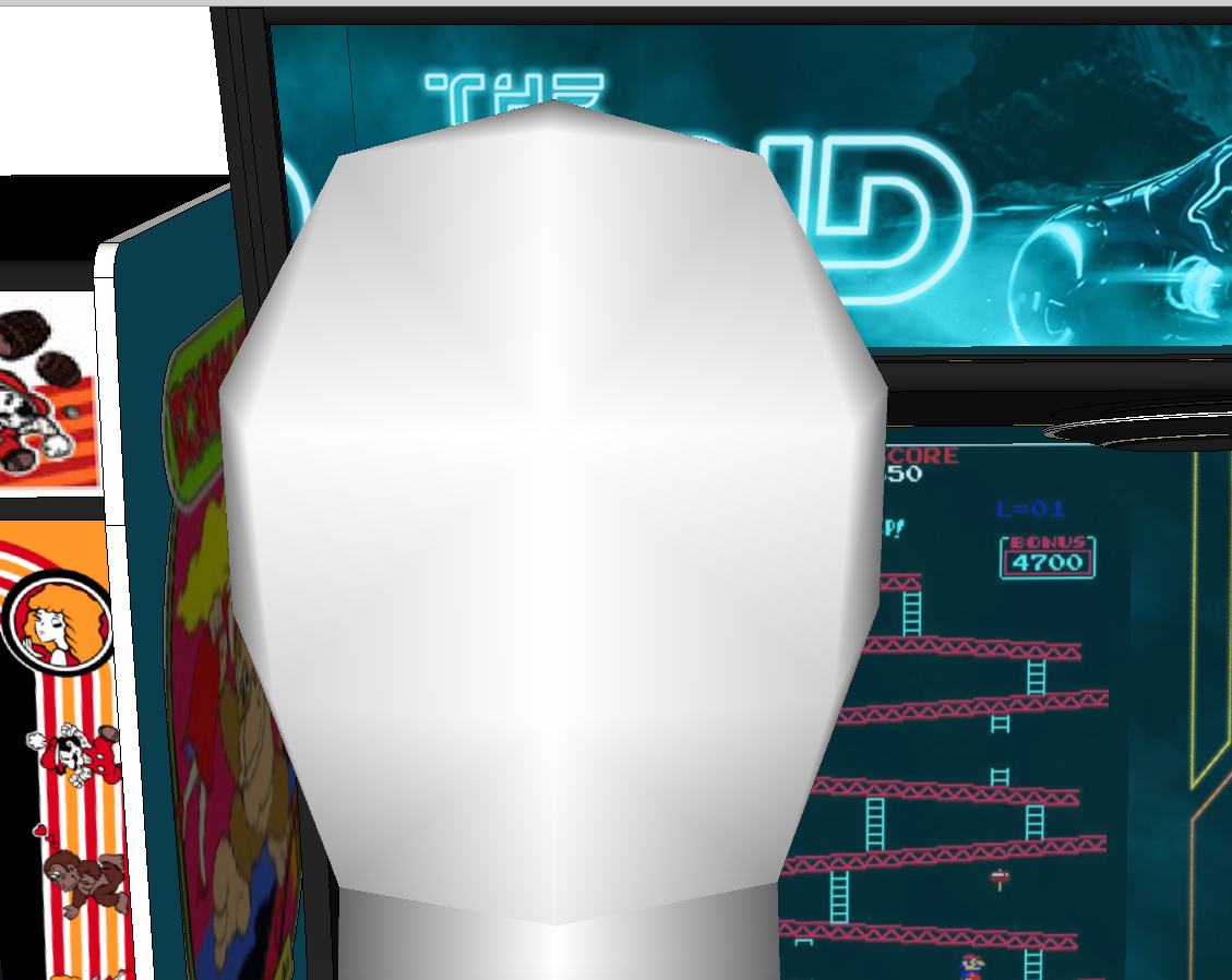

vertexguy
  • Posts: 325
  • ...but this one goes to 11.
Re: The Grid....
« Reply #445 on: January 04, 2020, 02:31:14 pm »
This build is looking really sick!  I love the Tron look and how you are going out of your way to capture that glowing digital theme.  For what it's worth I thought your original artwork attempt looked pretty good too.  Your 3D design work is great with all the detail.  The only food for thought I could offer you at this time is the placement of the Tron stick on the CP.
I debated this one for a while on my build design too.  What I don't like is that it's really tall and way too close to the screen.  This obscures the screen which bothers me.  From any reasonable distance it's a big obstruction but even up close playing it will get in the way.  If you look at the original Tron cab, the bezel was fairly high from the CP up to where the actual screen started.  That plus the angle of the screen. and the fact that it was one player at a time cab design helped keep the stick from obscuring the screen for the player.
I would be bothered especially when trying to play other games since the vast majority won't utilize that stick.  This in part is why I decided to go with a mini grip stick to keep it shorter, and pushed it as far down the CP as I could so it won't obscure anything and even looks decent from a far.  You can probably still get it to work nicely with an authentic Tron stick if you play with the position and maybe raise the screen a bit.
Definitely following this thread for other ideas and wood working concepts!  Can't wait until you get to cabinet lighting as that's a big unknown for me.

Re: The Grid....
« Reply #446 on: January 08, 2020, 01:42:51 am »
Jesus has it really been a month?  Time fly’s when you are constantly hosting people for 3 weeks straight, but hey that’s what it’s all about, drinking beers and playing games!
Thanks for chiming in Vertexguy, it’s a good thought and one I grappled over for many an hour.  Ultimately I think it will be fine.  I used the Mannequins (Bi-pods?) to give me a sense of the perspective by taking advantage of SketchUp’s look around feature:
What I do is zoom inside the head of the Mannequin, and once I am at the eyes I hide it and look around from the fixed position to see if I notice any problems.  Works well for me, and yeah the Tron stick was a concern but it should be fine.  I guess you never truly know until you build it. :dunno:

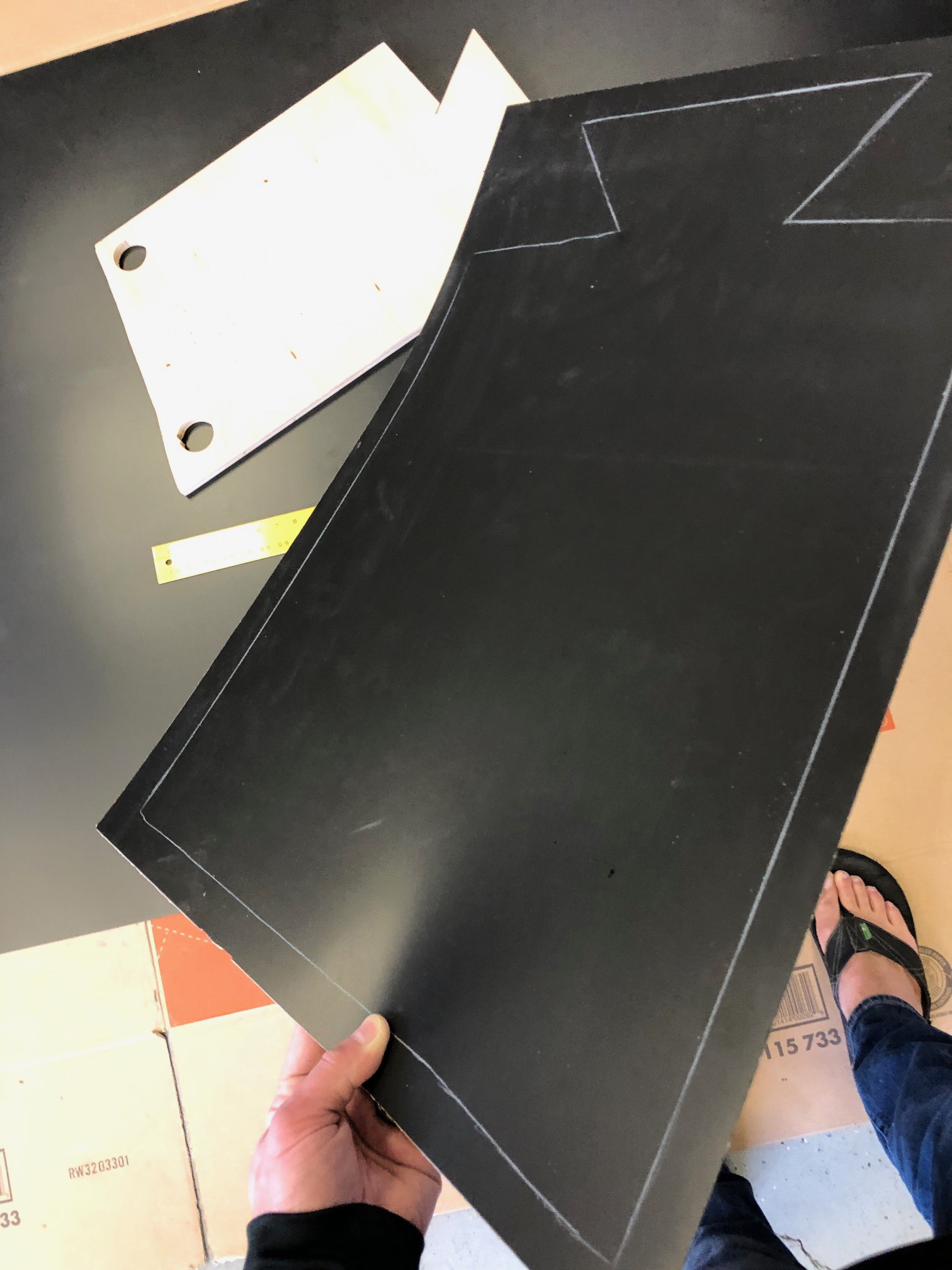

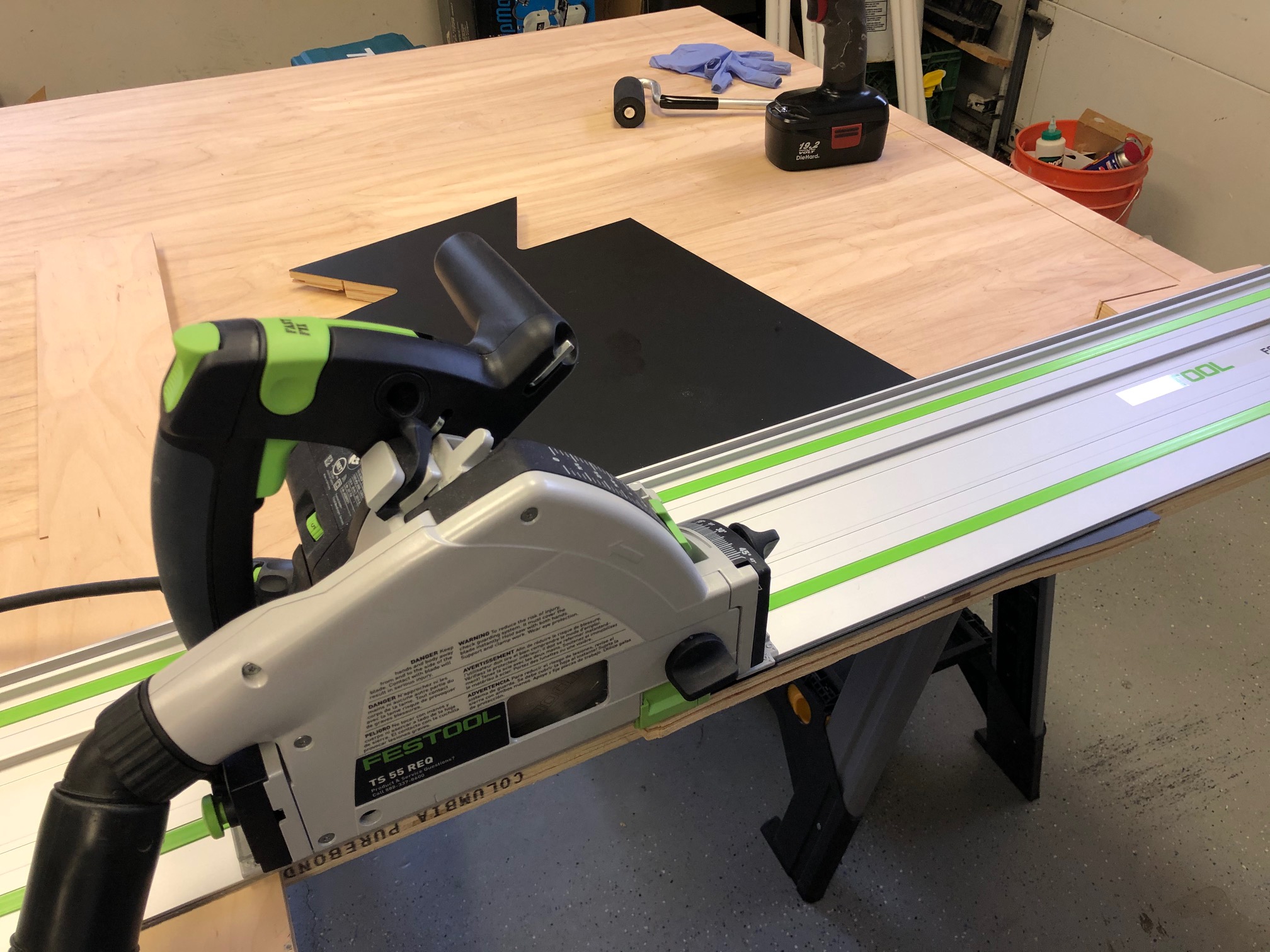

I needed to get over my fear of laminating things so I decided on a test piece:
I’d been using that board for all kinds of testing and it seemed a perfect fit to try this out.
I had order a few rolls of 4’x8’ Matte black Vertical Grade Wilson Art laminate I bought at Cabinet parts.com.  This should be a perfect fit with the 3/4” plywood which is really closer to 0.72”.  When mated with the laminate on both sides it should make a near perfect 0.75” for the T-Molding.
Anyway:
White color pencil outline, and cut out with a straight edge and the laminate cutter that I referenced on post #154.  Also on Post #154 is a GREAT tutorial bay Szabo’s arcades on laminate application, everything you would hope to know.
Bought some 1” PVC pipe like suggested in the video and chopped it up with this hand saw from Home Depot into 4ft pieces.
Bought the contact cement and foam rollers from Amazon.
Applied cement, waited, and followed the application techniques called out in the video.  Trimmed with Router an flush trim bit to fit.

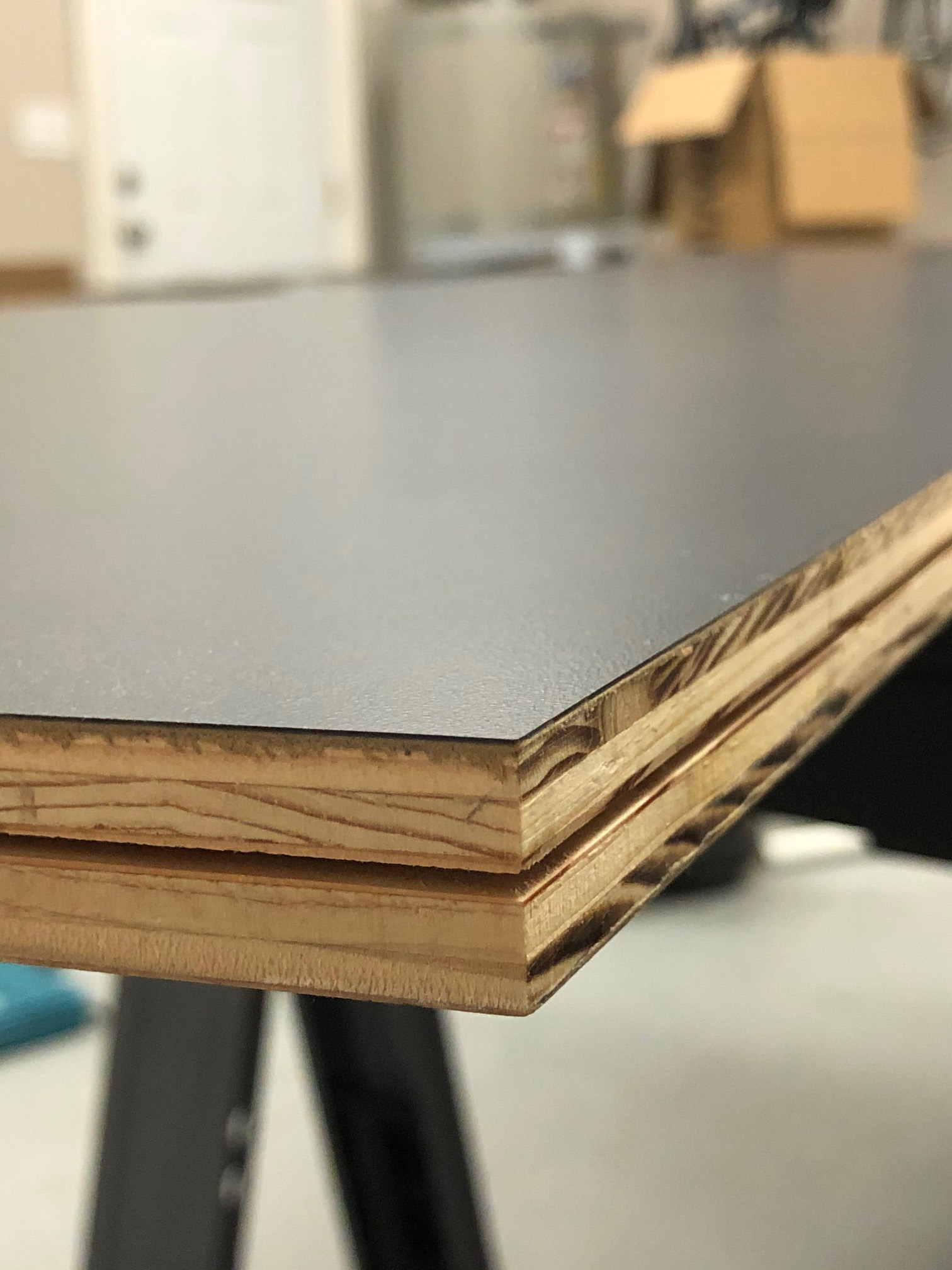

I wanted to test this test piece to see how various cutting methods would hold up in the laminate.
First was using the track saw cutting from the top laminate side:
This created some chipping (although mild, but still noticeable):
Tried flipping over the piece and this got better results (which makes sense since the blade would cut the laminate into the wood rather than pulling it up off the wood):
Better results:
Also wanted to test cutting lines with the saw and drilling, overall the laminate held up really well:
That’s that the track saw at 1/4” depth and a 6mm drill bit (supported by  previously drilled 6mm hole in plywood clamped above).

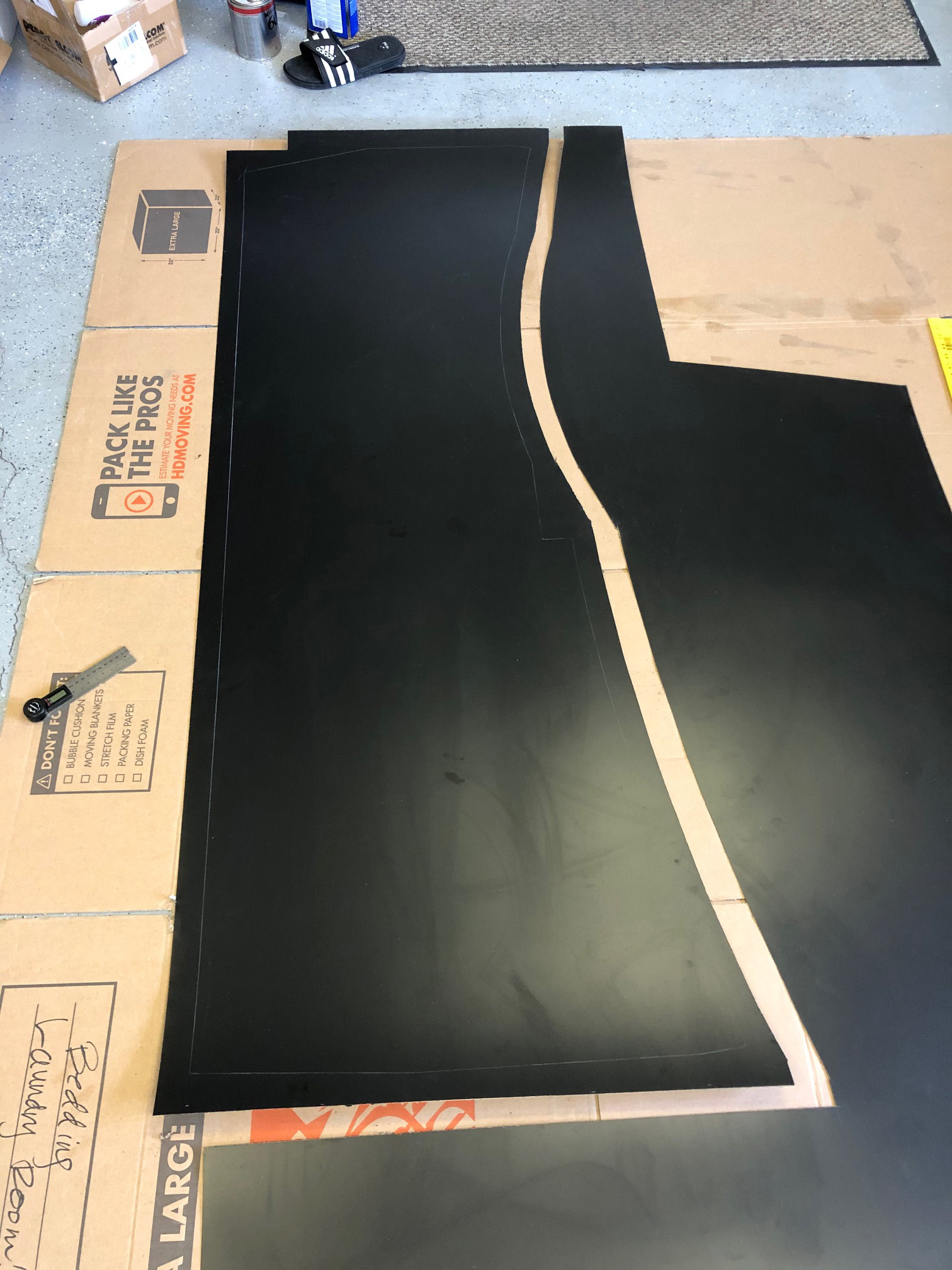

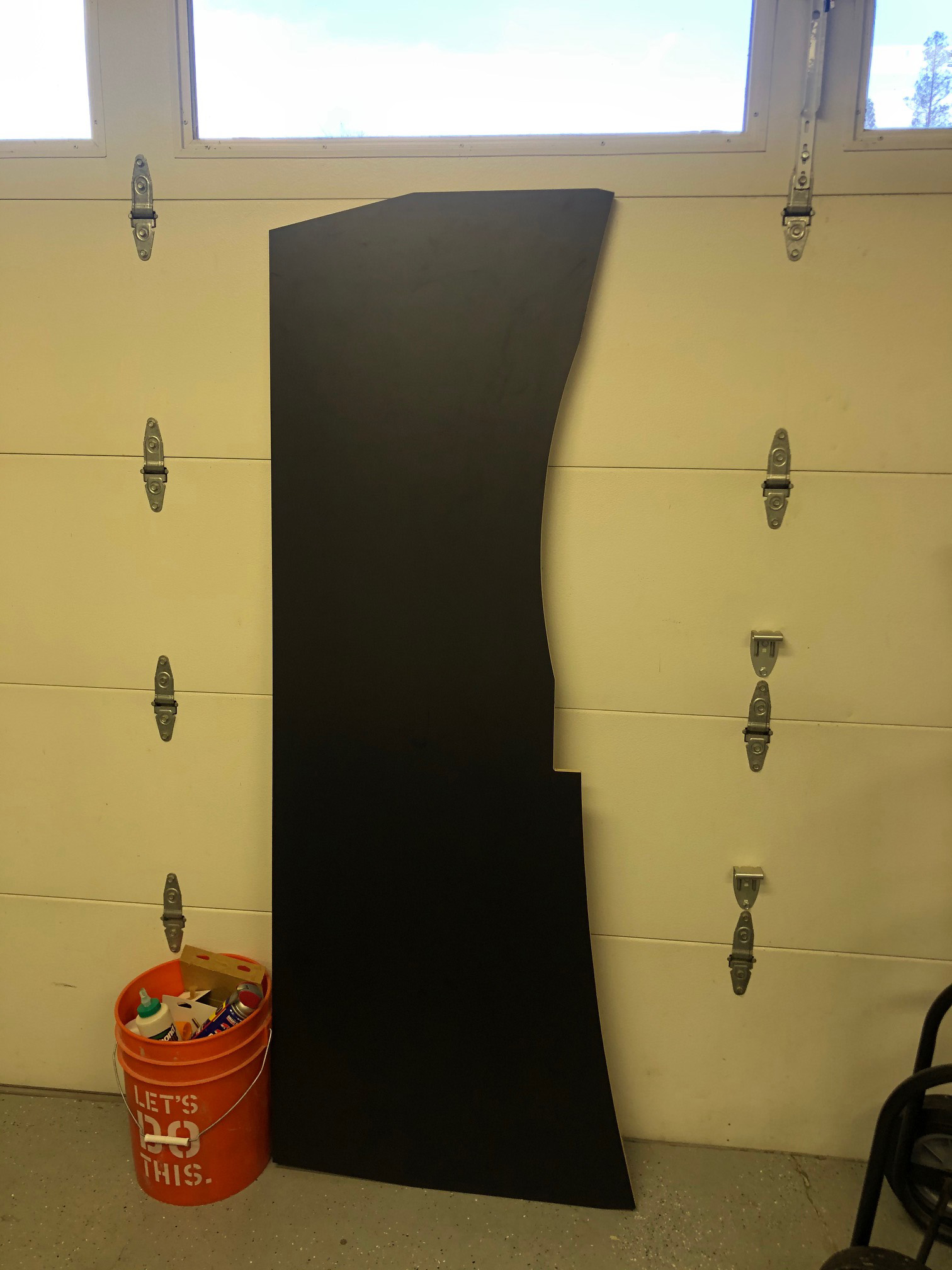

This gave me confidence to try it out on the actual pieces:
Used the previous router templates as guides for cutting and left a 1.5” fudge factor on the cutout when applying:
Pleased with the results after trimming with flush cut router:

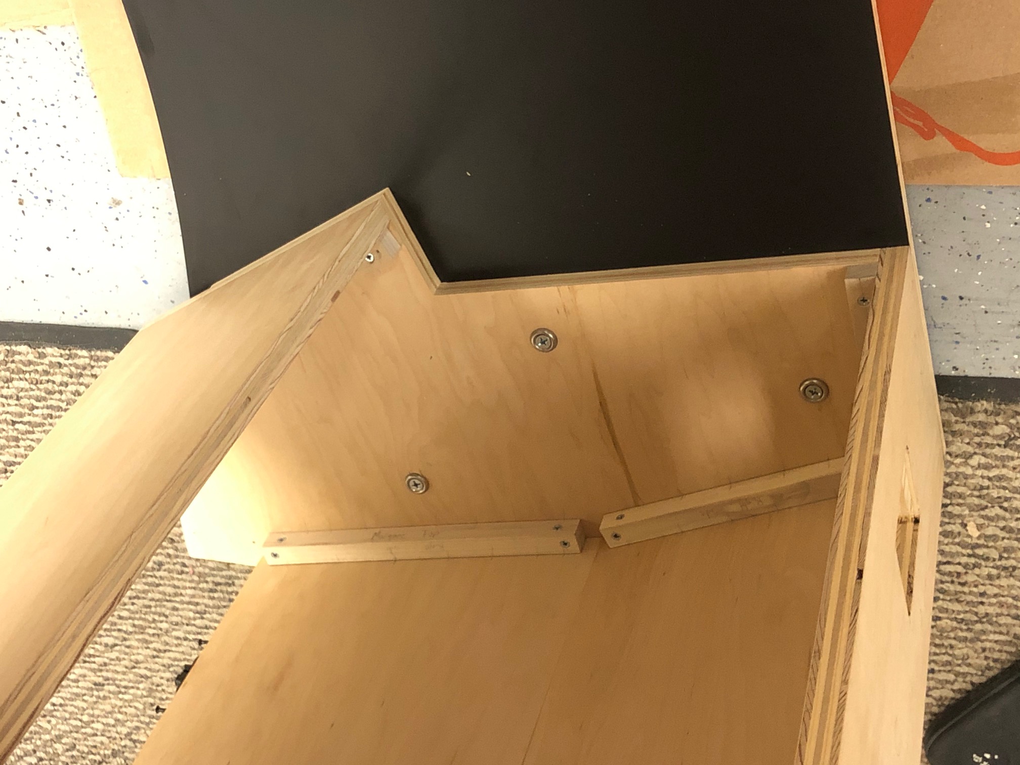

Next was assembly.  As usual Bob was a big help pointing me in the right direction.  I needed to attach the big panel sides to the small box below.  Threaded insert seemed the way to go.  So as per his suggestion went with 1/4-20 screws and corresponding 1/4-20 threaded inserts (1/2” length).
These are designed to screw into the front of the panel (closest to the piece it will be attached to).  In my usual over engineering, and paranoia, I was concerned about this being strong enough (looking after testing it probably is, but I like to go overkill).  So I tried a few different ideas to attach from the back side, one of which was T-Nuts, which would probably work well, however they weren’t attached all that well to the wood, jus the spikes sticking in, and the screw would push them back out often.
So I came up with the idea to use the screw to pull in the threaded inserts from the back (they aren’t designed to do this, and if you pick them up you will know what I mean).  This way the more it gets screwed in the more it tightens into the wood (as they were designed to do from the other side).  Hard to explain but hopefully the vide helps:
I drilled a 3/8” forstner, then a 1/4” forstner, and then added a 1/2” forester on top to prevent the screw in from bending the wood in when it got sucked down.  Here’s the result:
Bob gave me the tip of using a wax toilet bowl ring to lubricate the inserts before screwing them in, and it definitely helped:
Applied this technique to the lower and upper half:
The washers around the screws above are called finish washers and they are awesome!

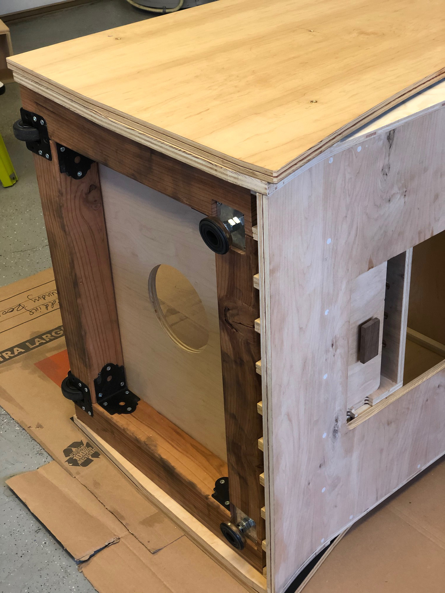

I wanted to tackle the speaker area, as I knew it was going to be difficult.
First was laminating the panel, which seemingly wasn’t a big deal, except that one of the sides (well two but I neglected it) was at a severe angel (60 degrees).  So using the usual flush trim bit wasn’t going to work as there wasn’t a surface for the bearing of the bit to ride on.  So I used I method I’d seen done on other builds:
Laid down the laminate, and trimmed all sides Except the one with the angle.  Used the Kreg Straight clamp and lined up the side with the edge of the piece (see pic above).  Then flipped it over and used the router and top bearing flush trim bit to cut a perfect straight edge:
Next was tackling the speaker and discs.  I knew that I wanted this to be as clean as possible which initially led me down the path of inserting the 5.25” speaker grills from the under side of the panel to give a clean look:
Looked pretty good, but it created a few problems.  1.) Was the mounting depth for screws was little (to not poke out the other side to the laminate).  2.) The speaker grills didn’t quite mount as high up as I wanted to make it look cool with the discs.
BTW - After lifting the piece off of my pivot point from the circle jig I realized I hadn’t initially cut the hole big enough.  I hadn’t marked the lines for the circle so I needed to find center again.  I picked up a neat trick from javeryh, which is to draw 90 degree straight lines just touching the outside of the circle until you have a square.  Then use a ruler to connect the diagonals and find center:
(Hopefully the picture describes it).
Anyway what I settled on was the speaker grill actually looked best when it was mounted On Top of the laminate as it was higher up and filled the hole in the discs better.  BUT I needed a way to secure the speaker discs.  I grappled over this for a long time.  I wanted something that would be strong but the least invasive on the material.  I settled on using the existing screw holes.  The problem was I needed to match the screw that it came with only in a longer version.
To do this I needed to know the thread count an size of the screw.
I picked this thread gauge up a while ago when doing research on screws:
it measures the thread count or “Pitch” (depending on if we are talking US or metric) so that you know if you are getting the correct screw.  Next thing you have to ensure is the diameter of the screw (furthest points meaning including the threads, I used calipers to get this).  Once you have that you can look up online the standard diameter notation and the thread count.  This one happened to be #4 (0.11” and 25 thread count).  I couldn’t find an exact match, however I found out that sheet metal screws could easily be found in #4 with a 24 thread count.  Because of having this tool I realized that the screw would work with a 24 thread count (at least for the distance I needed).  So I ordered 1 1/4” and went to work:
Sharpied the inside black and Voila:
Very happy with how this came out.  Now to finish the other disc and move on to finishing up the body and acrylic work.

« Reply #463 on: January 24, 2020, 11:10:44 am »
Here’s a pic of that angled cut:
If you look close you can see the cut is perpendicular on the laminate.  This DID end up creating a small gap when I place it flush with the wood piece that rests on the angle.  There is a little wood color that sticks out.  I’ll sharpie color this in, but yeah probably would have come out better if I laminated then made the angle cut.....so hard to see that far ahead.

« Reply #464 on: January 24, 2020, 11:55:25 am »
That's a great approach for general accuracy, but consider kid height views as well in the equation.  Also be cautious about the biped accuracy because as I discovered with mine, it didn't appear they would reach the CP correctly at the height I had it at, yet in real life it was fine.  That's one thing I liked about doing a prototype CP with cardboard.  Easy to test with a variety of users in mind.  Also it depends if it bothers you looking at the cab from a distance with it obscuring some of the screen.  BTW does your tron stick rotate left and right at all?  That's one thing I'm not sure I like about the mini grip stick I got.
Speaker assembly is looking great!  You're making me want to consider options for my own.
Nice pic!  That is exactly what I was looking for.  The laminate is so thin I'm sure you won't even notice the gap.  What's on the other end?  If you cut off 0.039" to get the laminate angled will it affect anything?   :cheers:

Alright Bobby, here you go:
bperkins01
  • Posts: 895
Re: The Grid....
« Reply #477 on: January 25, 2020, 11:10:13 am »
ok - that is very badass!
You made a whole pile of people happy this AM  :)
There is a way to do this after the fact:
Leave the laminate a little long and you can do it two ways:  small SHARP block plane, or sandpaper in a sanding block..
The laminate is so thin just a few swipes to knock off the corner.  Sharpie works well too..  Its a tiny gap.
