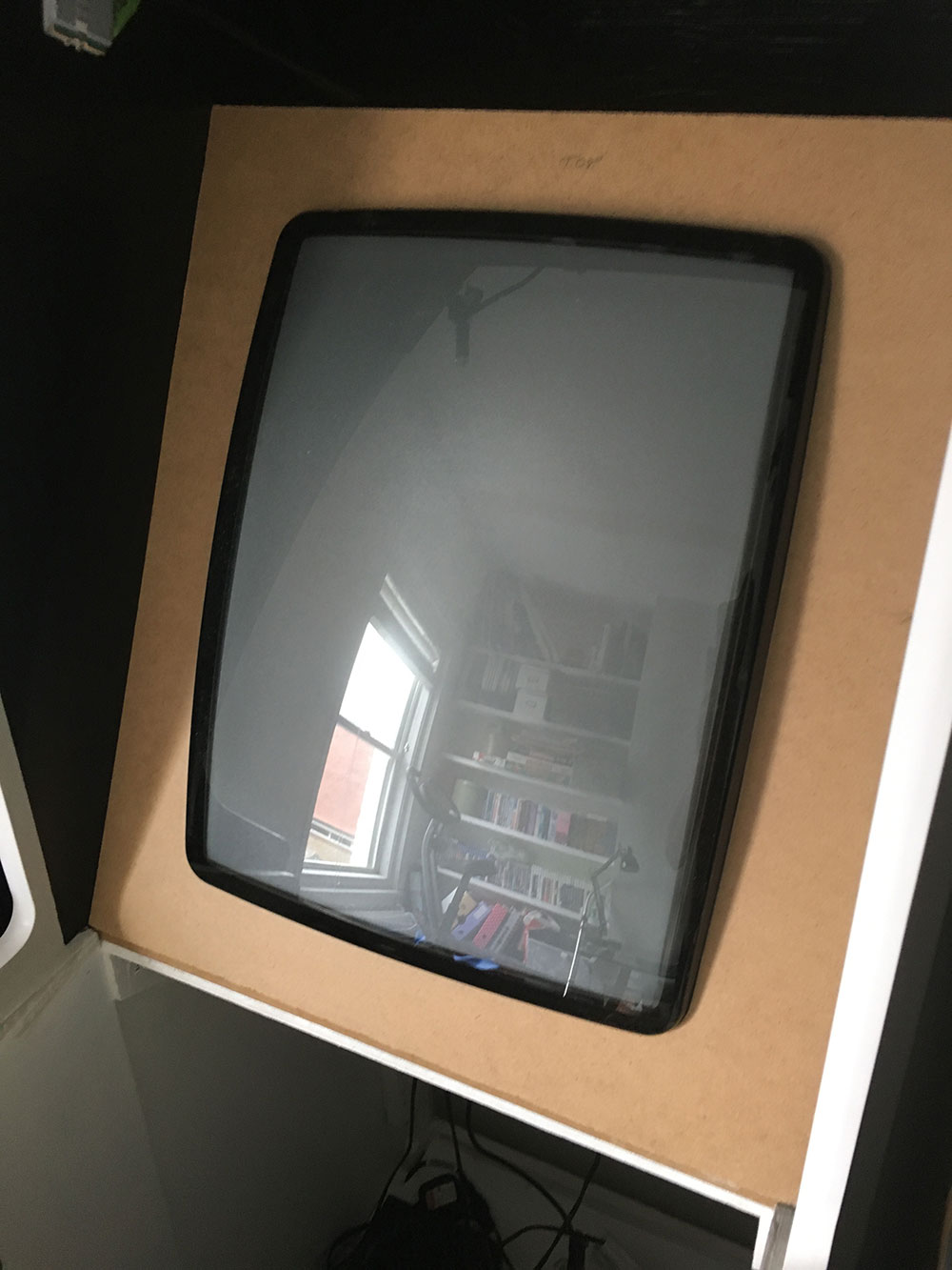

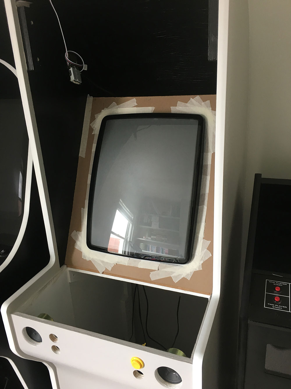

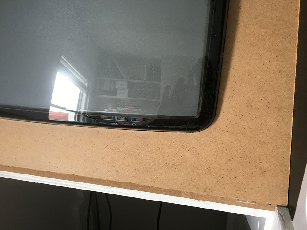

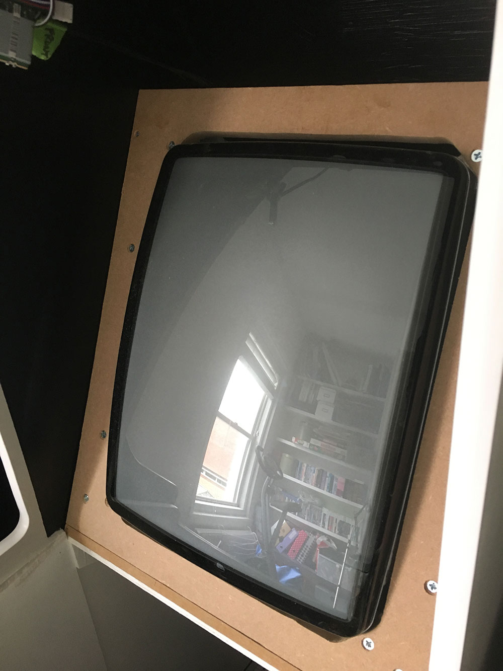

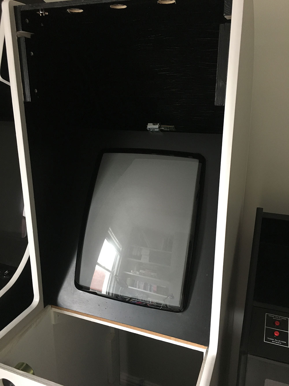

When i made the mount for the crt i didn't really try to get it too accurate. It was quite a pain getting it mounted without scratching the screen or damaging any of the chassis so i overcut the hole for the screen. When i mounted it into the cab this looked pretty obvious.
So i thought I'd make an inner bezel to cover the gaps and screw holes. The crt is curved so this was a bit tricky but i had the idea that if i cut some cardboard the same size as the monitor frame but made a big hole around the monitor i could use masking tape to create an accurate template.
I then traced this onto 3mm wood that i had laying around (from a previous failed attempt at the front panel!). A bit of work with the jigsaw - and a lot of work with a hand file, i eventually got a semi decent bezel.
Looks good enough for me
TBH i could have just made this out of matt back poster board but i thought I'd use my scrap wood up. In the future I'd probably go that route though as i wouldn't have had to paint it.

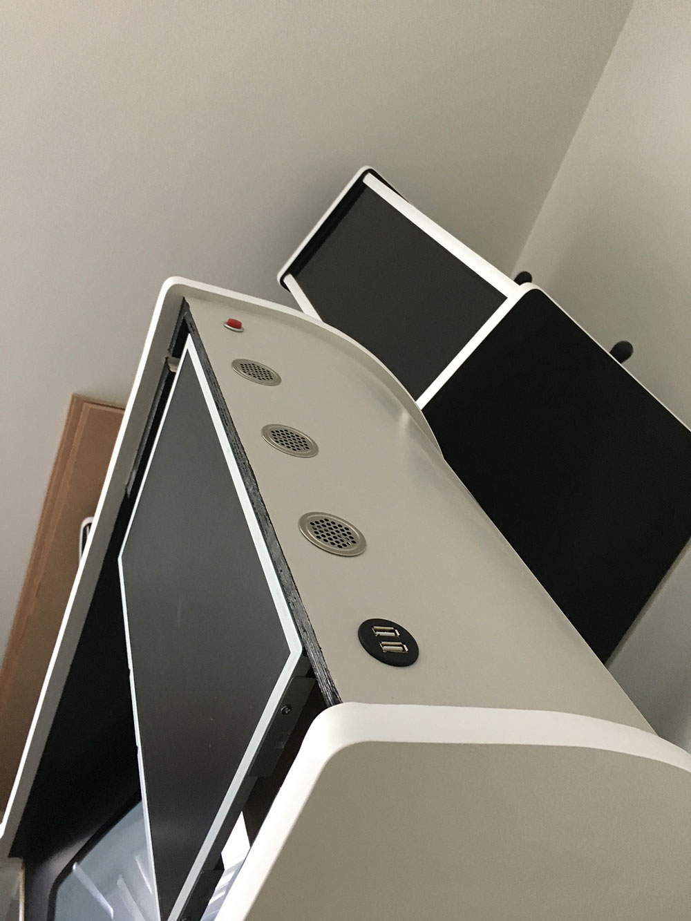

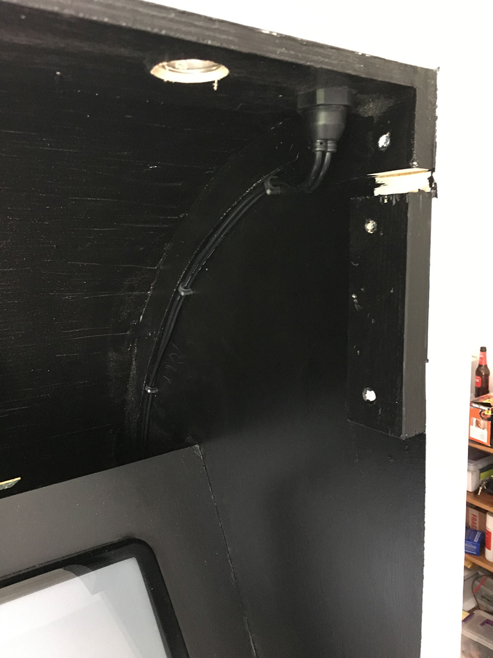

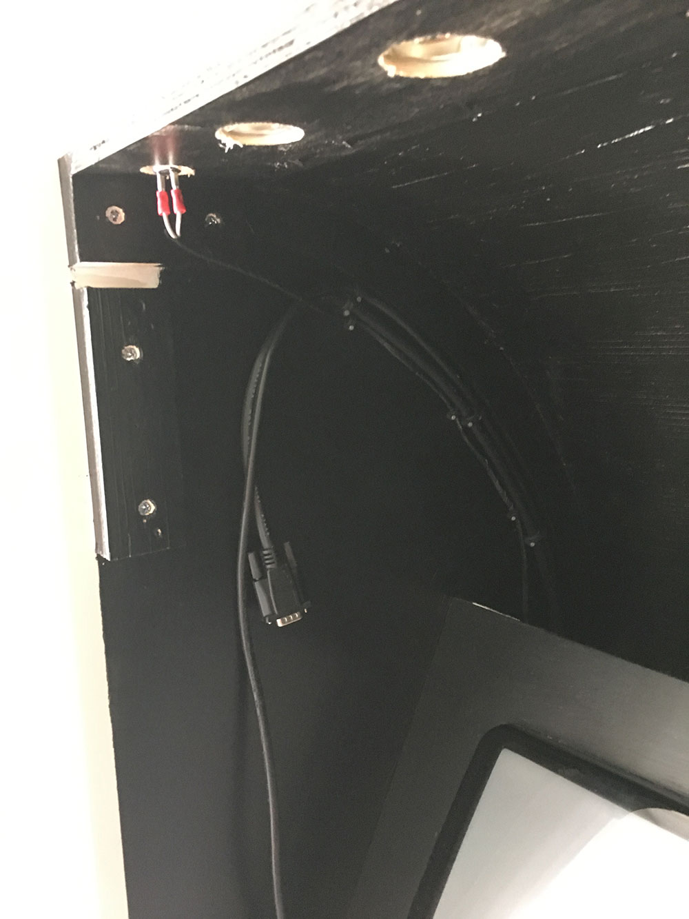

Before i put the marquee monitor in i needed to channel the cabling as it would be near impossible to do it with a monitor in the way so i wired up the cabling for the marquee monitor, pc power and external USB ports.
Then added the marquee monitor. This is just some 12mm ply screwed to the monitor using the vesa mount. I didn't paint the ply because a) you won't see it ultimately, and b) i forgot.
1% A, 99% B tbh…
And here's a shot from the top. I've added a couple of vents so the the LCD doesn't get too hot.
And that's where I'm up to as of 4 hours ago. A few crappy jobs done but at least I'm not falling over monitors in my spare room now :)

Firstly, my crt died. I was very upset. Having spent hours decasing/mounting/bezeling the tv it was a massive kick in the balls when it stopped working.
It’s a Bang and Olufsen MX4000 which I chose because I’m a big fan of the picture quality, and they are ridiculously shallow. The downside (as mentioned above) is that the circuit boards are a bit scary when you first see them as there are about 6 of them all connected together via a plastic cage.
I completely missed that this was a MX4000!  They are supposedly great RGB consumer monitors. We never saw these in North America, but I've read about them from all the UK people who are into RGB monitors. Luckily you found a replacement, but that sucks that another great monitor that could be used for gaming bites the dust.

Yeah - was a massive pain getting a new TV and swapping everything over but the picture is much better and brighter so I'm not going to get too upset about it. It was quite a relief that the new TV used the exact same size tube so my bezel board just fitted straight on.
I've slotted the new one in now and apart from a few geometry issues that I need to sort out - which is a massive pain on MX4000's I'm pretty much done.
I'd read that Trinitrons were the be all and end all when it came to scart TV's (other than PVM's) but I tried one of those first and preferred the MX4000. The second TV I got has an older firmware and less circuit boards but the picture quality is something else. I'm definitely going to pick up a spare though as the cabinet is built around it so I cant just slot it any CRT TV.

Anyway - picked up a spare tv and it turned out to be even better picture than the one i was using so swapped it. It’s an mx4200 which is a flat tube. Not ideal but the clarity (and nigh on perfect geometry) made it worthwhile. Stored the old tv and recreated the mount for the new one. Old hat at this now tho so only took an hour.
Did the same bezel stuff only used poster board this time and it was much easier.
