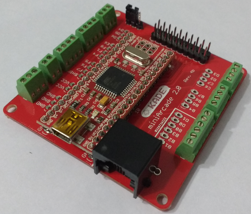

Sega Saturn RJ45 output cable for the Multi-Out schematics:
Code: [Select]
RJ45 Saturn
1 GND
2 D0
3 D1
4 D2
5 D3
6 S0
7 S1
8 VCC
Sega saturn controller port reference:
http://www.gamesx.com/controldata/saturn.htm
Images of the new Multi-Out PCB (for updating the user manual image):
Top:
Bottom:
I will release a new mapper package when PL1 send me the updated user manual
« Last Edit: July 29, 2017, 06:51:18 am by bootsector »

The only thing remaining is to find good pics of the Saturn Controller Plug (nothing yet) and Console Jack (two possibly-usable images so far) for the pinout image.
If anyone has a Saturn controller and can take some decent pics like these of the connector(s), your assistance would be greatly appreciated.   :cheers:

Thatpurplestuff came through with some great Saturn connector photos.   ;D   :applaud:   :notworthy:
Once he confirms his photo credit, I'll generate the new User Guide PDF and post the update files (PDF + 3 new images) to the usual location, Bruno.   :cheers:

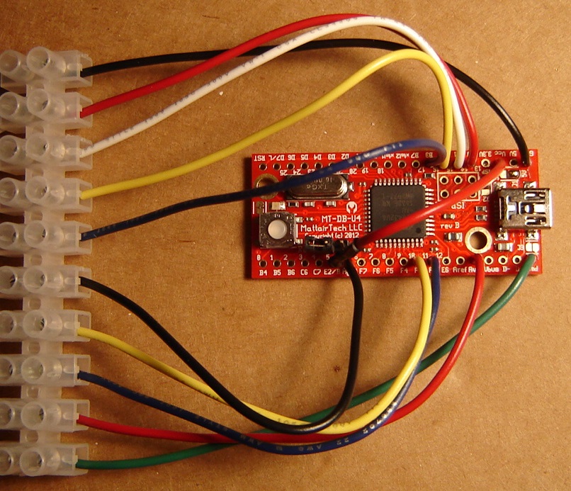

Since im cheap and also because I rarely go in my cabinet, i just built a lazy 6 button Jamma Harness converter out of some pro micros loaded with this firmware.
How it works is, i have the pins on one side, spidered out to handle 6,5,4,3,2,1,R,L.  And have 4 jumpers as D,U,Start and on the P1 side, coin.

Since I know that you're looking for a no-soldering solution, here it is.
The Arduino Micro knockoff board here sold by "gowoops" comes with header pins already soldered onto it.   ;D
Wiring Option 1:
Use pre-fab 4-pin harnesses like this and a daisy-chan ground like this from Paradise Arcade Shop. (If you ask Bryan and Susan, they might be able to substitute a daisy-chain ground with one female dupont pin on one end instead of all 0.187" Quick Disconnects)
Wiring Option 2:
Connect dupont jumpers like the ones here to the desired header pins.
Cut off the other end of the jumper, strip the wire, and feed it into one side of a euro-style terminal strip like this.
On the other side of the terminal strip, connect pre-crimped wires cut from a JAMMA harness. (cut off and discard the big edge connector)

oh wait so if i buy the kade 2.0 from bruno it doesnt come with the smaller board in the middle with the usb port ?
If/when Bruno re-stocks, it comes as shown -- a 32u4 AVR board (small board on top with USB) and the daughterboard. (large board on bottom with ethernet, Dupont pins, programming jumper, and screw terminals)
The daughterboard is convenient if you plan on swapping controller adapters via the ethernet connector, but the daughterboard is not needed -- it's just convenient for hooking up controls/controllers without soldering.
problem for me is the shipping cost from brazil to the netherlands etc
If you don't plan to use the miniArcade 2.0 for a multi-system/multi-controller setup, you can save lots of money by ordering a 32u4 AVR board and soldering some wires to through-holes on the AVR board to "roll your own".
If you have zero soldering skills, just order an Arduino Micro like this one or this one that comes with the pins already soldered,  some Dupont jumpers, and a euro-style terminal strip for an easy no-solder setup.   ;D
If you want to save more money and don't mind reassigning a few ports in Mapper and soldering, you can use the very common and inexpensive Arduino Pro Micro.
- 5 ports to reassign (XBox defaults not available on the Pro Micro): B7, C7, D6, F0, and F1
- 7 available ports to choose from (not used as XBox defaults): B1, B2, B3, D0, D1, D4, and F7
