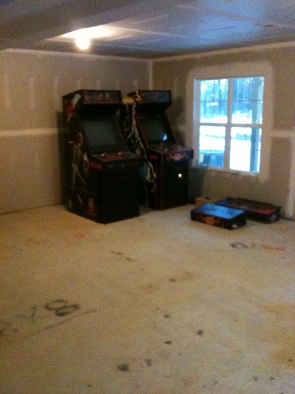

I havent taken many pictures, its a cruel reminder how slow I am.
Here's back when I first moved in:
Maybe I will start a thread, it might motivate me!
