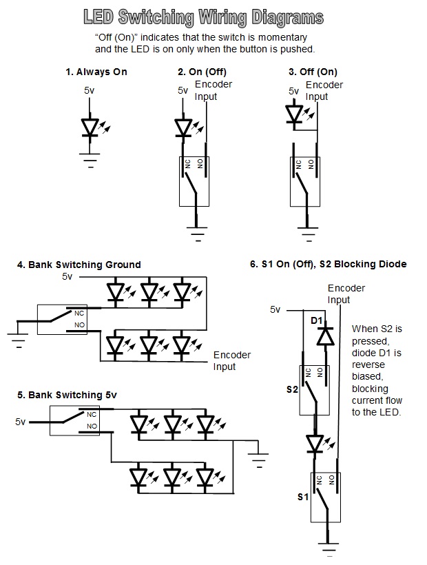

I havent seen the movie, but heres my take. Use a kaimana mini for led control, ano ipac key encoder, and a raspberry pi to play audio. You can use led joysticks and buttons, and try to find some industrial fuse box power cut levers and solder your connections to it.

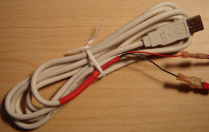

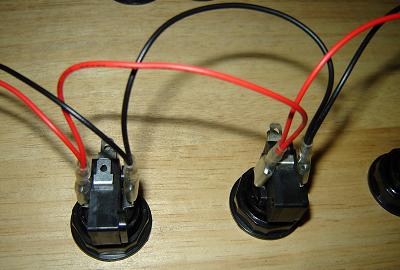

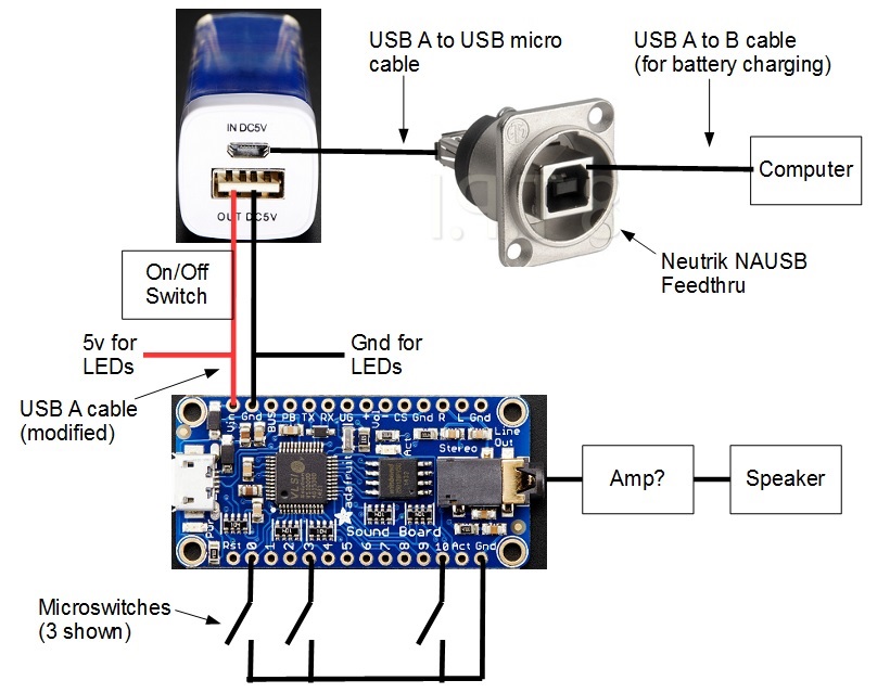

I found EXACTLY what you described, WannabeJoy.   ;D
Adafuit makes several no programming sound FX boards.
https://www.adafruit.com/search?q=audio+FX
These two look rather promising.
Adafruit Audio FX Sound Board - WAV/OGG Trigger with 16MB Flash - here
Adafruit Audio FX Sound Board - WAV/OGG Trigger with 2MB Flash - here
The boards have momentary/looping/latching/random/sequential playback options set by filename.  Brilliant!   :applaud:
How complicated is it to wire it up with 10 buttons, an on/off switch, a battery pack and speaker?
You can also print custom pushbutton inserts like these on Avery 18665 inkjet labels for LED pushbutons.

THIS IS AMAZING! Thank you!

One other part that might come in handy is a Neutrik "NAUSB-W-B" feedthru -- lots of vendors including Allied Electronics and Mouser carry them.
It is easy to reverse the center barrel for an easy battery recharging connection.

Given these things, what would be my best power source here? I'm open to battery or plug in but I'm clearly a noob and don't know what would be my best option to get the right voltage to power the LED buttons but not fry the sound board.
This Adafruit page mentions several ways to power the sound board.
The 5v 2200 mAh USB battery pack here is probably the best way to power both the board and the LEDs.
mAh = milliamp hours -- If you are powering a board that draws 50 mA and 10 LEDs that draw 60 mA (110 mA total), the charge will last 20 hours. (110mA * 20 hours = 2200mAh)
The LED buttons you linked do not indicate whether the LEDs are 12v or 5v.
The good news is that 12v LEDs will still run on 5v (slightly dimmer) and draw less current (5.83mA vs. ~20mA) so the battery will last longer.   ;D
How do you want the LEDs to behave? (Always-on is the easy way to go.)
You may also want to include a USB on/off switch like this (hard to mount on the outside of the case :( ) or make your own by splicing a panel-mountable switch into the middle of the USB 5v line.
Before you go too much further or order any more parts, we should diagram how everything is going to fit and work together electrically.
Give me a little while to draw up a diagram based on the features and info in this thread.

Here's a starting diagram that doesn't show the LED connections but fully covers power distribution and several trigger inputs.
For always-on LEDs, just wire them in parallel like this using a 0.250" Quick-Disconnect daisy-chain.
Let me know if you want to use a different approach or different components.
If you do need an amplifier, get a 5v model and power it with the same 5v/Gnd that you use for the LEDs.

I'm hoping to make the buttons light up when pushed and play whatever corresponding sound they're attached to.
OK . . . .  The breadboard that you ordered might come in handy because LED "animation" is going to require different wiring -- much more complicated.
It will also require some experimentation with the board and LEDs to see if it can be done since the sound board doesn't have an LED controller built-in.
Possible "animations" include:
  1. Button pressed ==> LED on
  2. Button pressed ==> LED off
  3. Using a microswitch to provide/interrupt LED voltages (i.e. press the joystick toward a picture of "Sadness" to light some blue LED buttons and/or have some yellow "Joy" LEDs go out)
Which of these do you you want to attempt?
If we can't get these various "animation" techniques to work, you still have the "LEDs always-on" option that definitely will work.

You're welcome, but I was referring to diagrams that I haven't drawn yet.   ;D
I'm not sure if you want:
-- The LEDs lit all the time and the buttons/joysticks only control the sound clips (this is the easy way and 100% guaranteed to work)
or
-- The LEDs to light/extinguish when a button/joystick is pressed. (a bit more complicated wiring, but it adds some visual changes to triggering the sound clips)
There are three simple "animations" that should be relatively easy to wire.
(The alternative is custom-programming some kind of Arduino LED controller.   :scared)
  1. Starting condition (LED off) ==> Button pressed (LED on + sound input trigger) ==> Button released (LED off)
  2. Starting condition (LED on) ==> Button pressed (LED off + sound input trigger) ==> Button released (LED on)
You can even piggyback method #3 on methods #1 and/or #2.
For example, you could wire a red LED button with method #1, and a green LED button with method #2, and use a joystick microswitch to switch the voltage from lighting the green (method #2) button to lighting the red (method #1) button for as long as you press the switch.
I'll draw diagrams for any/all of these animations that you want to attempt.   ;D
« Last Edit: September 11, 2016, 12:16:15 am by PL1 »

« Reply #36 on: September 12, 2016, 04:45:29 am »
LMK if you have any questions on these diagrams.

How do I get power to the LEDs? I'm setting up to wire but unsure how to wire in the power to the LED lights. Thanks!
Before you start wiring things up, load some sound clips (with correct filenames) onto the sound board so you can test it.
Here's the general hookup diagram . . .
. . . You'll need to make a "USB A cable (modified)" like this one from GGG to connect the battery pack to the power switch, LED power leads and the sound board.
5v wire is pin 1, ground is pin 4, trim the data lines so they won't short to the other wires -- picture of pinout here.

Power switch wiring:
                               Power switch
    USB 5v wire____(NO)_\_(COM)_____Euro-strip 5v
    USB gnd wire____________________Euro-strip gnd
1. Wire the USB 5v wire to the power switch NO (Normally Open) tab and another wire to the power switch COM (Common) tab.
2. Connect the wire from the power switch COM tab to a terminal on the euro-strip like the red wires above.
3. Connect the USB gnd wire to a terminal on the euro-strip like the black wires above.
4. Connect gnd from the euro-strip to the sound board.
5. Connect 5v from the euro-strip to the sound board.
6. Connect the amp/speaker.
