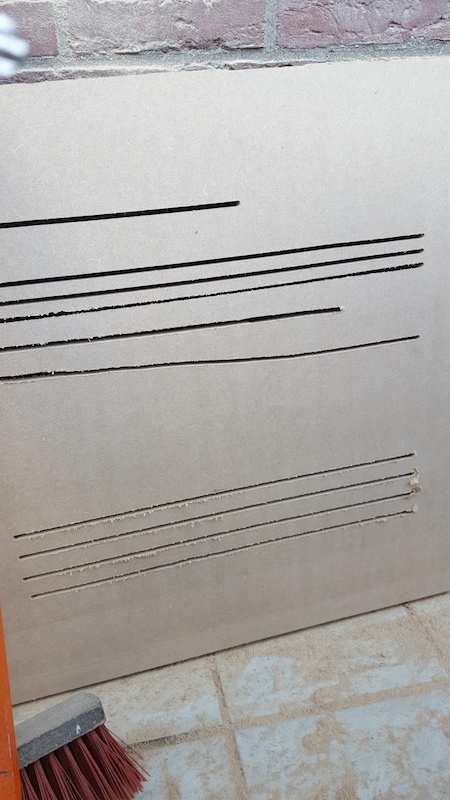

This afternoon I have sawed the first side panel. I am happy with the result. This weekend I will have more time to continue woodworking, then I will also clone the second side panel with a router.
« Last Edit: October 24, 2015, 03:58:19 pm by Niels Arcade »

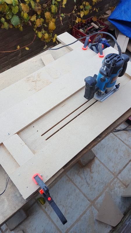

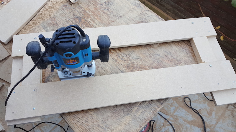

Today I have finished the second side panel. The first thing I did was outlining the original side panel on a MDF plate. I roughly sawed out the shape of the side panel leaving about 1 or 2 cm around the edges. I used my router with a flush trim bit to copy the original side panel.
For those who might not now how a flush trim bit works (neither did I until recently): The second panel was on top of the original, to be cloned panel. The end of my router bit has a small metal wheel which follows the lines of the original panel while cutting 'the fat' of the new panel at the same time.
The result: identical twin panels and lots, lots of dust.
After I finished cloning and sanding the edges I continued cutting the t molding slot. I also used my router, this time with a slot cutter bit equipped.
A few tips for people, like me, who are not that experienced using a router:
- Whenever you use a new type of bit/technique you're not familiair with, perform a test run by using some scrap mdf.
- Move the router in the opposite direction of the moving bit, to prevent the router taking a uncontrollable run by itself.
- Make sure you keep the router straight and prevent it from leaning over during routing. Especially when using the slot cutter you will misalign the slot when the router is leaning over even just a little bit.

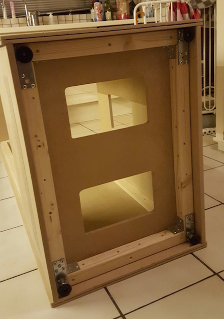

Today I have created the base plate for the cabinet. I sawed two holes in the plate so I will be able reach the height adjustable feet. Whenever I would be in need to move the cabinet around I made sure I have a dolly that fits under the base plate.

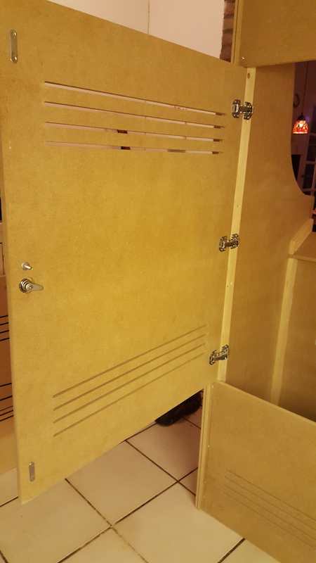

With my router I cut ventilation slots in the plates for the backside of the cabinet. Before I started, I made a guide for my router using some scrap (yet straight) MDF.
Since I had never done this before, I made a bunch of test cuts until I got it right.
Using my router with the guide.

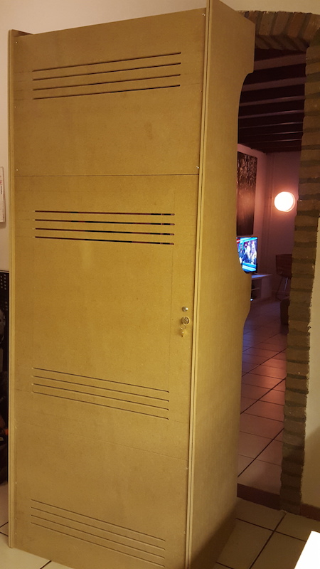

And the result of a lot of routing (and a lot of sawdust).
Service door with hinges, lock and magnets on top and bottom for perfect closing fit.
Base plate installed.
Picture of the front, really starting to shape up now!

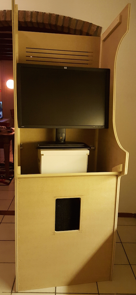

I have had a change of heart regarding the LCD screen I was intending to use. The 23 inch 16:9 monitor I wanted to use creates a lot of extra unwanted bezel space above and below the screen. When I was toying around with Mame I was also a bit disappointed in the screen size left when I would play 4:3 arcade games. I also think the viewing angles would not be that great for people (like my child) who would differ a lot in size.
Luckily I got a great deal on Marktplaats.nl (Dutch craigslist) for a used 30 inch HP ZR30W IPS monitor. This screen is awesome! With it's own bezel it is 69 cm wide, while my cabinet interior width is 70 cm, so it is a perfect fit. It has a 16:10 aspect ratio, so that's a plus v.s. the former 16:9 as well. The actual screen dimensions are 64 x 40 cm, pretty descent. Since it is a IPS screen, instead of TN, it has far better viewing angles, while still sporting a 7-12 ms refresh rate which is not bad for a IPS screen.
Since the admin panel I planned was also a way to break the big bezel space, this is not necessary anymore, so I will drop the admin panel and place some discrete admin buttons on the cp.
