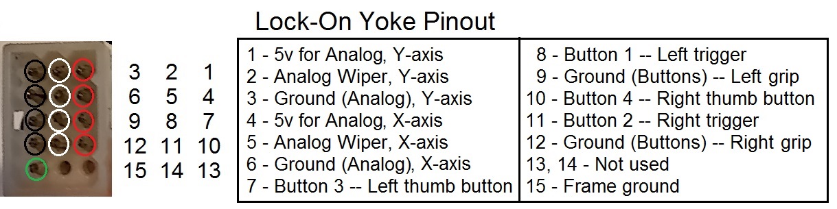

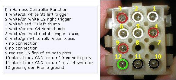

Here's a likely Lock-On Yoke pinout for you to check.
EDIT: Lock-On yoke pinout confirmed and image updated.

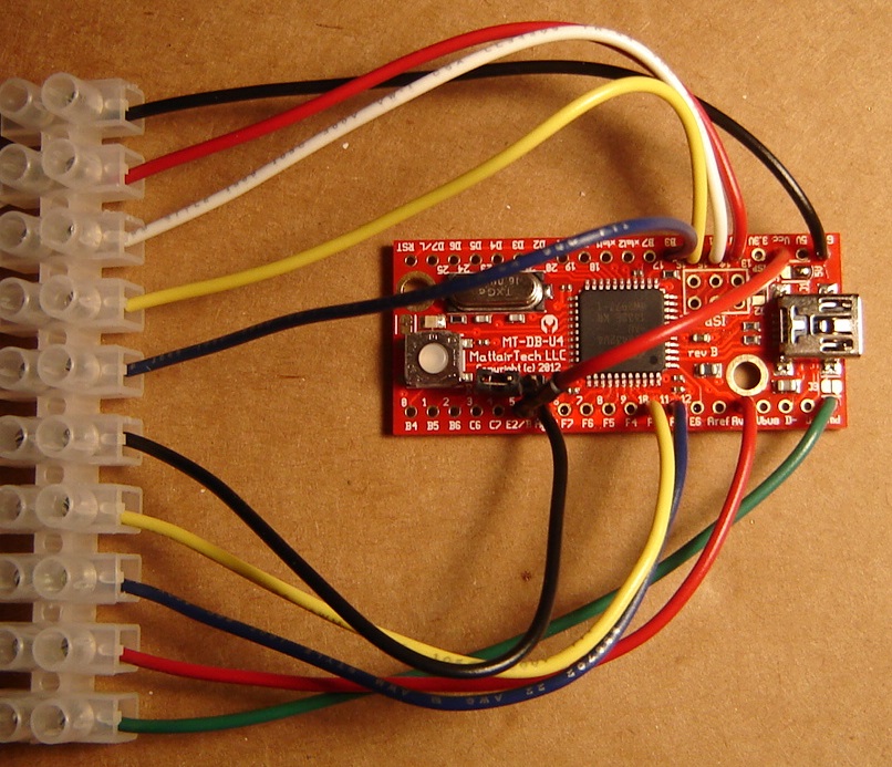

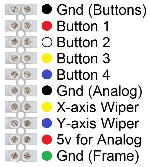

It looks more complicated than it is.

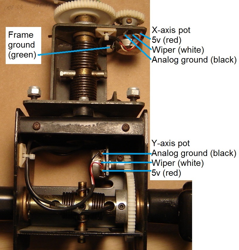

Anyone who has wired up a control panel already knows how to do the buttons -- they are almost half of the wiring involved in this.
There are 4 buttons, 2 potentiometers, a frame ground, and a pullup resistor.
Each button has an input wire and a button ground wire shared (daisy-chained) with another button.
Each potentiometer has 3 wires -- 5v, wiper, and analog ground.
Total of 13 wires for this yoke.
If you take it one wire at a time, it's easy.   ;D

I noticed that you have yoke pins 3 and 6 going to the "ground (analog)" on the circuit board, but you only labeled one ground analog pin on the board, where is the other one for the other yoke pin?

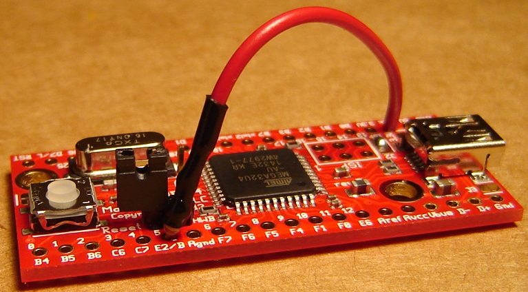

Also, where exactly does the resistor go? I can't really see where it was put on the board from the pictures.

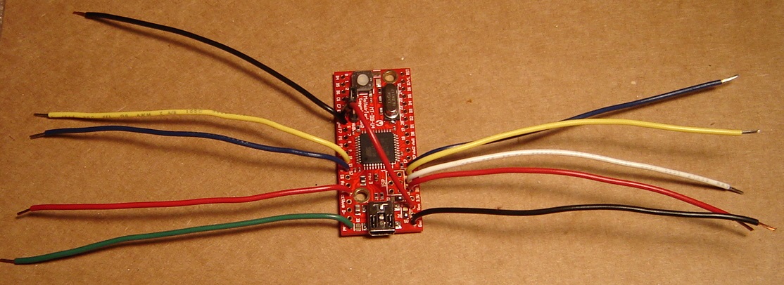

The easiest way to connect several wires to one through-hole on the board is to use one wire from the board to one side of a euro-style terminal strip and hook the two wires to the other side.
It also makes it easier to change wiring if you accidently hook something up wrong.

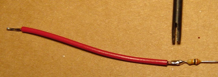

It's under the black heat shrink on the red wire connected to "Vcc" in the lower left of this pic.
Vcc -- resistor -- wire -- E2/B or Vcc -- wire -- resistor -- E2/B (either way works)

EDIT: Found a better picture of the pullup resistor. (Pic by Le Chuck)

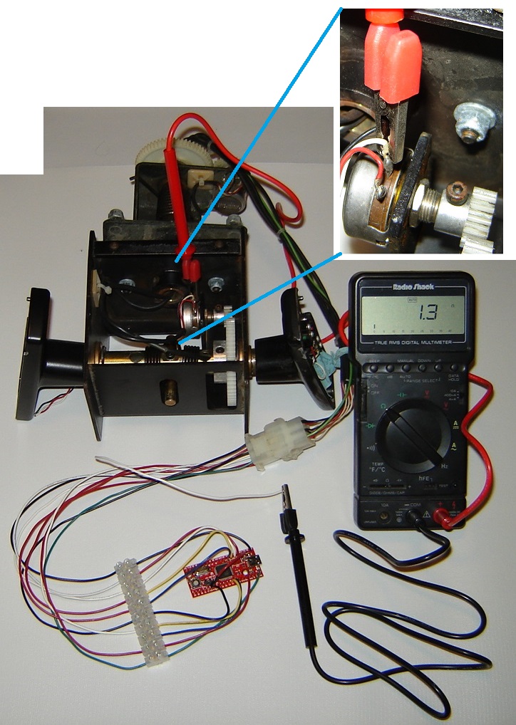

Here are a few pics to help identify the wiring.
EDIT: Added more build pics.
« Last Edit: October 11, 2015, 01:26:26 am by PL1 »

I think I'm going to really need a step by step tutorial to pull this off.
Already working on it.  (See the wire identification pictures in the earlier post.)   ;D

* Board received
* Pullup resistor installed
* Board programmed
* Jumper wires connected between the board and the euro-terminal strip
+ Make molex adapter cable (if I can talk you into not hacking the original harness  ::) )

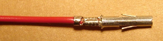

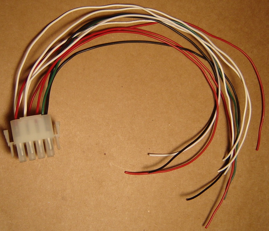

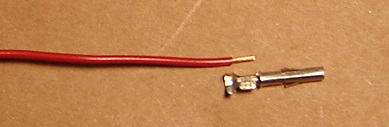

It isn't hard to crimp these pins onto wires and make an adapter.
I did this before getting a decent pair of ratchet crimpers  :embarassed: -- looks terrible, but works fine.
Pretty sure the connector on your yoke harness is a Molex 15 pos Plug 3x5 .062 (part number 03-06-2152) with male pins.
The corresponding connector is a Molex 15 pos Receptacle 3x5 .062 (part number 03-06-1152) with female pins. (part number 02-06-1103)
You may want to get two receptacles and 30 pins -- enough pins for practice and a backup housing if you mess it up.
The idea is to hook it up like the attached mockup.

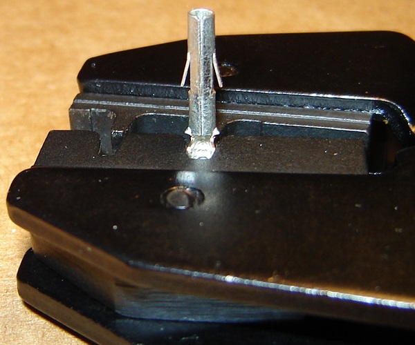

Second, I'm going to grab the receptacles and pins, but should I grab extra wires too?
Your best choice for crimping is stranded (not solid) wire.
22 gauge is big enough to easily work with and small enough to fit perfectly in the through-holes of the AVR board -- great size for arcade controls.

1. Cut/strip/lightly tin a 2.5" - 3" wire and and bend one end into a U-shaped loop.  Cut one lead of the 10k ohm "pullup" resistor to ~1/4" and bend it into a U-shaped loop.
2. Solder the wire loop to the resistor loop (shown below with the end of a wire-bending tool) and insulate the connection with heat-shrink.
3. Solder the resistor and wire between the Vcc and E2/B holes on the board.
4. Use FLIP to load the firmware on the board using the procedures here.
5. Solder 4" wires to the following 10 board holes:
* Gnd (lower right) - Ground (Buttons)
* B0 - Button 1 (left trigger)
* B1 - Button 2 (right trigger)
* B2 - Button 3 (left thumb button)
* B3 - Button 4 (right thumb button)
* Agnd - Ground (Analog)
* F1 - X-axis Wiper
* F0 - Y-axis Wiper
* Avcc - 5v for Analog
* Gnd (lower left) - Frame ground
You may want to use color coded wires.
6. Connect the 10 board wires to the terminal strip. (strip shown was cut to 10 positions)
7. Make a Molex adapter cable.
- You may want to use color coded wires that match with your yoke harness.
- Crimp pins onto enough 12"(?) lengths of wire to connect each pin from the yoke harness to the terminal strip.
-- The "14" slot on the HT-236-2U die works well for 0.084" pins
-- Pic below shows a molex pin properly positioned in the jaws of a ratchet crimper with the wire end of the pin toward the slightly wider side of the crimp die, the "ears" on the pin pointing into the U-shaped side of the crimp die and the already-round part of the pin clear of the crimp die by just over a thumbnail-thickness.
- Insert the crimped pins into the molex housing.
8. Attach the Molex adapter cable to the yoke harness.
9. Carefully remove the outer grips (don't lose the springs on the thumb buttons or triggers) and the cover from the yoke so you can check the wiring.
10. Verify the wiring using your multimeter set to either continuity or ohms mode.
- Clip one lead of your multimeter to a wire in the yoke and touch the other lead to one wire after another in the molex adapter cable until you hear a beep (continuity mode) or read less than 2 ohms. (ohms mode)
- Connect that wire to the associated terminal on the strip -- some terminals may have more than one molex wire connected
- Repeat until all molex wires are identified and connected to the correct terminal.
Pic shows continuity from Y-axis potentiometer wiper (red lead) to the corresponding wire on pin 5 of the molex adapter cable. (black lead)
Star Wars harness pinout
Lock-On harness pinout

Axis reversed (i.e. crosshairs moving left when the yoke is turned to the right)
Reverse the axis by swapping the 5v and ground wires on tabs 1 and 3 of the pot.
Jitter (i.e. shaky crosshairs)
Jitter can be caused by the pots and/or the wires. (probably the pots)
To eliminate the wires, use a jumper wire with insulated alligator clips or a screwdriver to short the center tab (wiper) of the pot to either the tab with 5v or ground.
If the wires/connections are good, the crosshairs should go all the way to the edge of the box and stay there without jitter.
- Jitter when shorting to 5v, but not when shorting to ground = bad 5v wire/connection
- Jitter when shorting to ground, but not when shorting to 5v = bad ground wire/connection
- Jitter when shorting wiper to 5v and when shorting wiper to ground = bad wiper wire/connection
If the wires/connections all check good,that just leaves the pots.

Sorry for the delay. As I was checking the continuity of the wires, I discovered that some of them were cut. Some looked like they were squished and cut as a result, and some looked like they were cut on purpose (have no idea why). I had to reattach and solder new wires before I could continue checking the continuity.
The pics attached below have the picture of the pinout given earlier, and a table showing the wire color, corresponding pin, position and location within the yoke.
Hope it makes sense.
« Last Edit: October 11, 2015, 11:32:19 am by greenmanjph »
  • Posts: 9794
  • Last login:Yesterday at 10:50:06 pm
Re: Help with Star Wars yoke adapter
« Reply #28 on: October 11, 2015, 12:51:35 pm »
Thanks!  Your notes confirm everything precisely.    :cheers:
Updated the "Lock-On Yoke Pinout" image and added it to the tutorial.
There will be three terminals that get two wires from your molex adapter:
  - Gnd (Buttons) - Pins 9 and 12
  - Gnd (Analog) - Pins 3 and 6
  - 5v for Analog - Pins 1 and 4
For the rest, just match up the wording on the pin and terminal.   ;D
LMK if you have any questions or suggestions on improving the tutorial.

I'm almost halfway there, I forgot about the crimping tool, had to order one. Waiting for it to arrive to continue building.

P.S. Looks good so far other than the Avcc wire being on the Aref pin.
How well did the solder joints turn out?

The Avcc wire is in the next to last hole from the bottom in the terminal (that's where it looked like it went in the other pictures) the way I took the picture and because all the wires are the same color may make it look like it's in a different spot.
I had a problem soldering at first (it's been at least 20 years since I've done any soldering work on circuit boards and I'm a bit rusty), and I figured out what the problem was. I messed up the first most important thing to do with my soldering iron, tinning the tip :banghead:. Once I did that, everything went together no problem.
  • Posts: 9794
« Reply #32 on: October 14, 2015, 02:20:59 am »
Actually, it looks like it's soldered in the wrong hole (Aref = blue arrow) on the board.
It should be in Avcc. (green arrow)

I double checked it this morning (started to get a little worried). Luckily it was just the camera angle, the wire looks like it's in the right spot.

The tutorial shows 10 wires from the AVR board going to 10 terminals that connect to the 10 wires in the Star Wars molex adapter.
You've got two wires from the molex adapter going to each of these three terminals.
It sure looks like you're doing it right.   ;D
No word from Justin yet.   :dunno
Does Windows even try to load drivers when you connect the board to a USB port? (Do this before you try to run Flip.)

I seems to try and load the drivers, but I don't think it's able to.
I'm also confused about this part in the firmware procedures (part 4)
"Once FLIP is installed, the DFU bootloader drivers can be loaded.
Install the HWB jumper (or disconnect the pullup resistor) and power up the board (or press reset) to enter the DFU bootloader.
Windows will then prompt you for the ATmega32U4 driver -- point it to the Program Files/Atmel/Flip 3.4.2/usb directory and install.
If the Atmel drivers do not work, you may need to install the signed drivers from http://www.avrfreaks.net/index.php?module=Freaks%20Academy&func=viewItem&item_type=project&item_id=2196.
Once the driver is loaded, the device will appear as an ATmega32U4 device under Atmel USB Devices in the device manager."
I already installed the pull up resistor in step 3, but the firmware instructions say to disconnect it. Pressing the button on the board doesn't do anything either.
