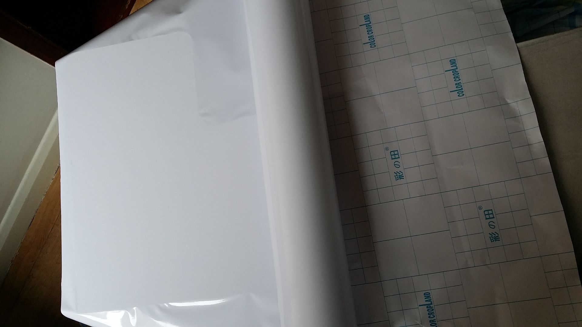

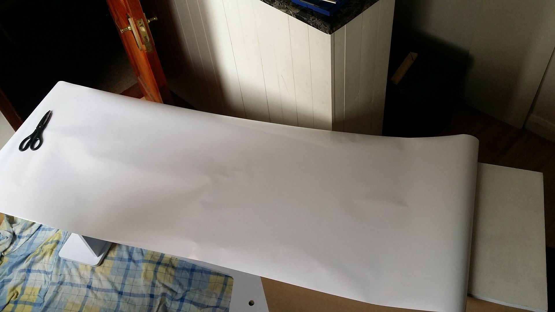

I have propped up the sides put some boxes up and put the mon itor im going to use to give me a guage. I even had a quick game of "Air Space Invaders" to see if the height sat right for me.
I have decided not to paint the unit but will use gloss vinyl rolls on the cabinet.
I have prepped MDF with primer 1st. 1st sheet went on very easily and was really impressed with the finish.

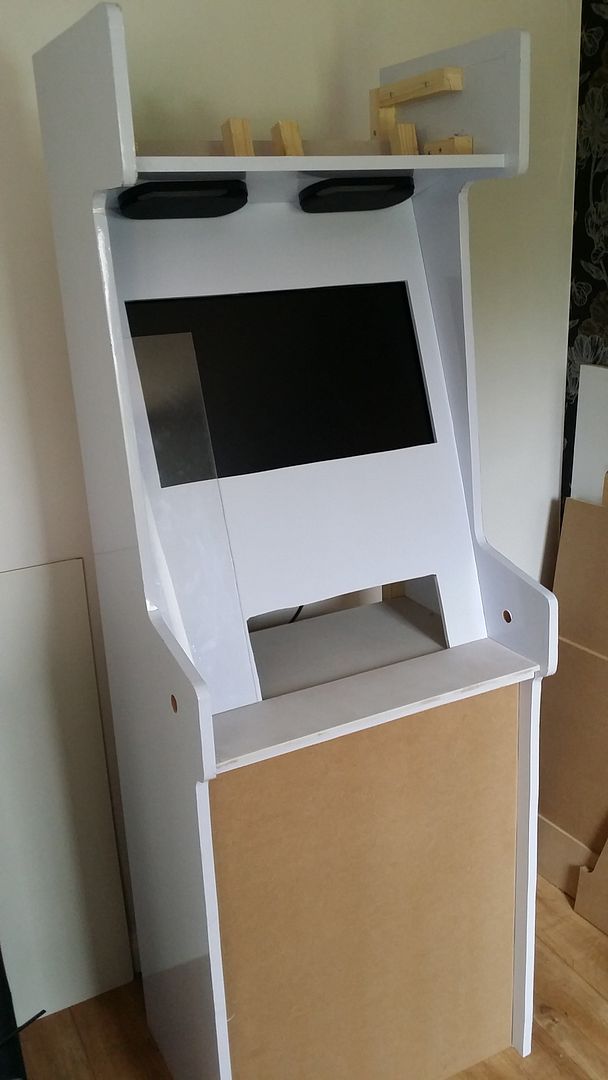

Been busy as I really want to get it done before the end of the month.
I have decided based on a couple of builds to go for front and rear access so I fitted a door to the front. Was remarkably easy to do and fit. I did have a bit of offcut wood cladding I used to offset the internal hinge so the door sits properly.

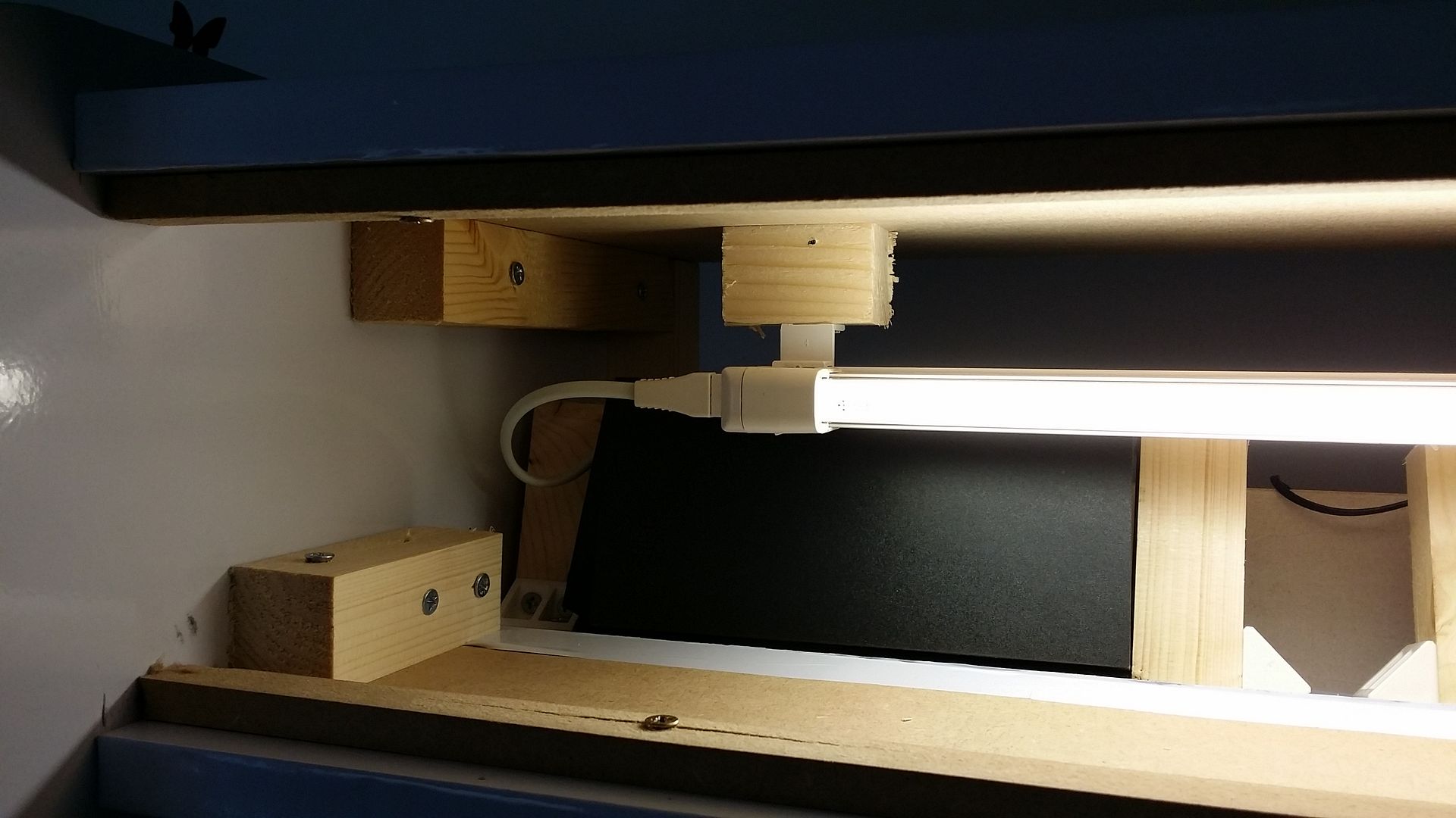

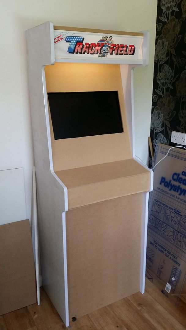

Lined monitor and angle by stacking on boxes. Used 18mm mdf offcut to screw monitor.
Fitted a strip light and and printed a crude marque to get a feel of what it will look like.

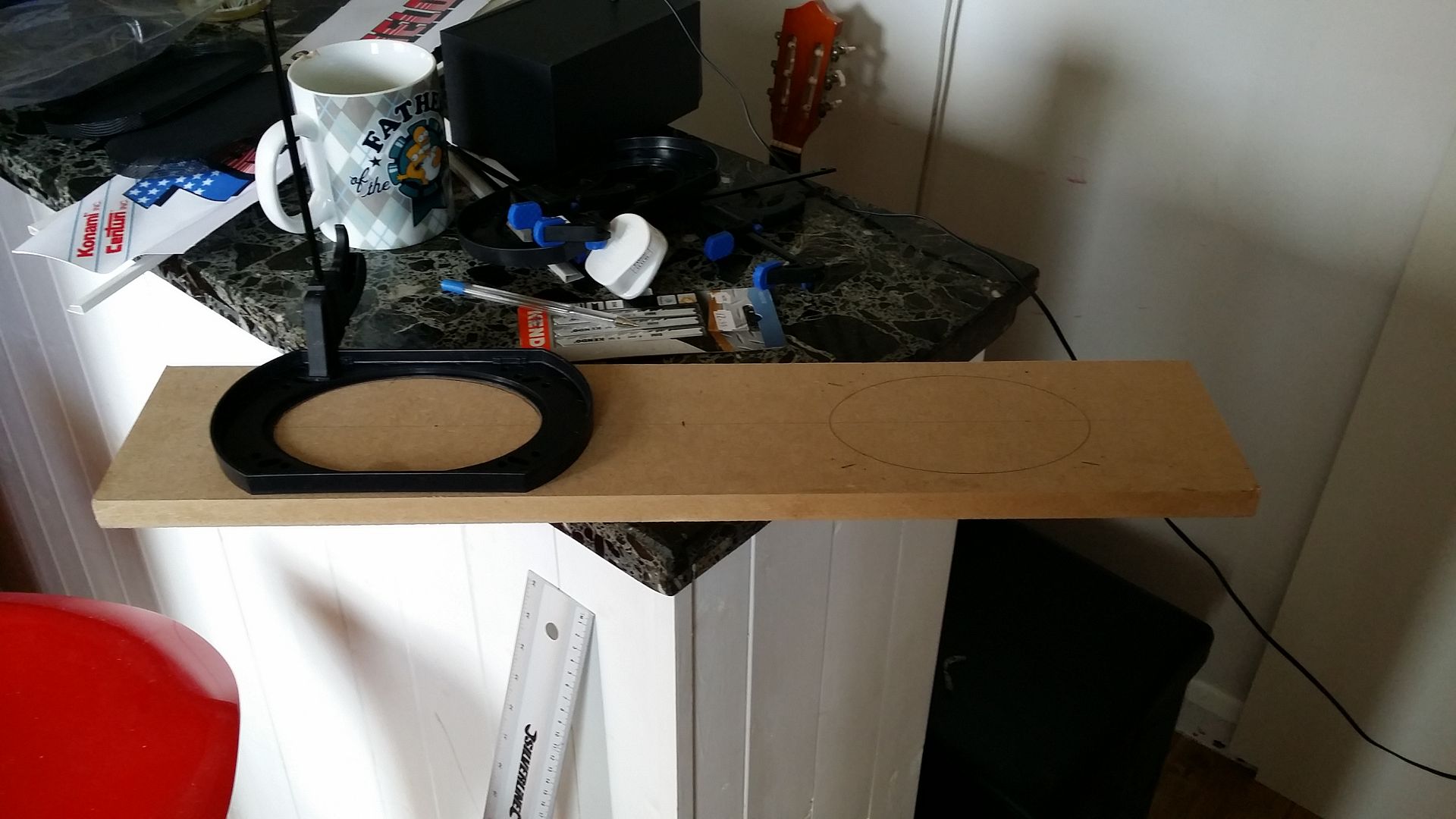

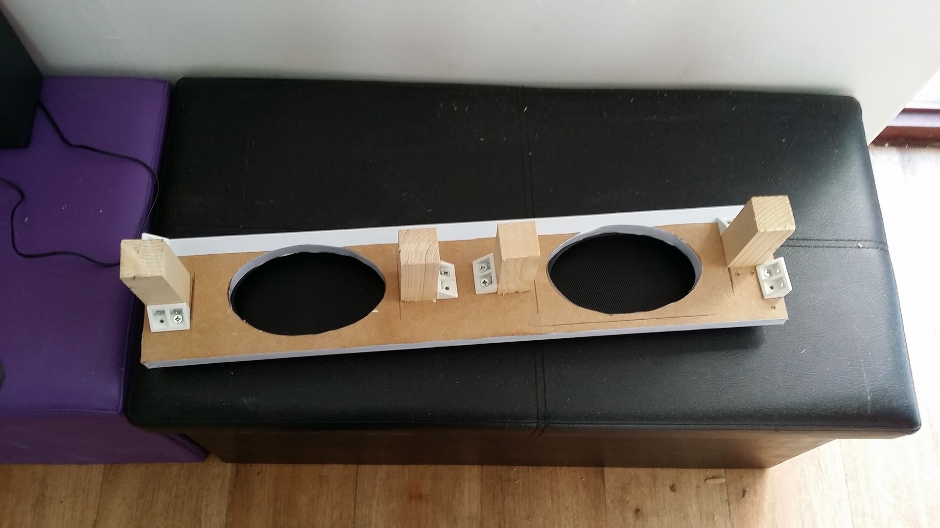

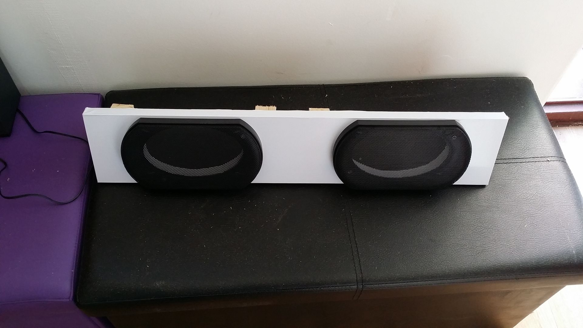

Next job was to tackle the speakers. I wanted a 3.5 input so I can play music through it aswell as a external volume control button. I went for Logitech Z3333 as they fitted the bill. I was going to use car speakers, but when I plugged them into the base unit, they did not sound as good as the dedicated speaker. I decided on a couple of speaker covers, and mount the PC Speakers inside.
« Last Edit: May 13, 2015, 04:41:21 pm by deano71 »

Final job tonight was to fit the vinyl on the outside panels and the Bezel and mount on to cabinet.

Hi, 5 Meters x 610mm cost £6.94. I needed 15meters in total. Much cheaper and quicker than paint and gives it an excellent finish. You also have a large range of colours but the wife wanted white.

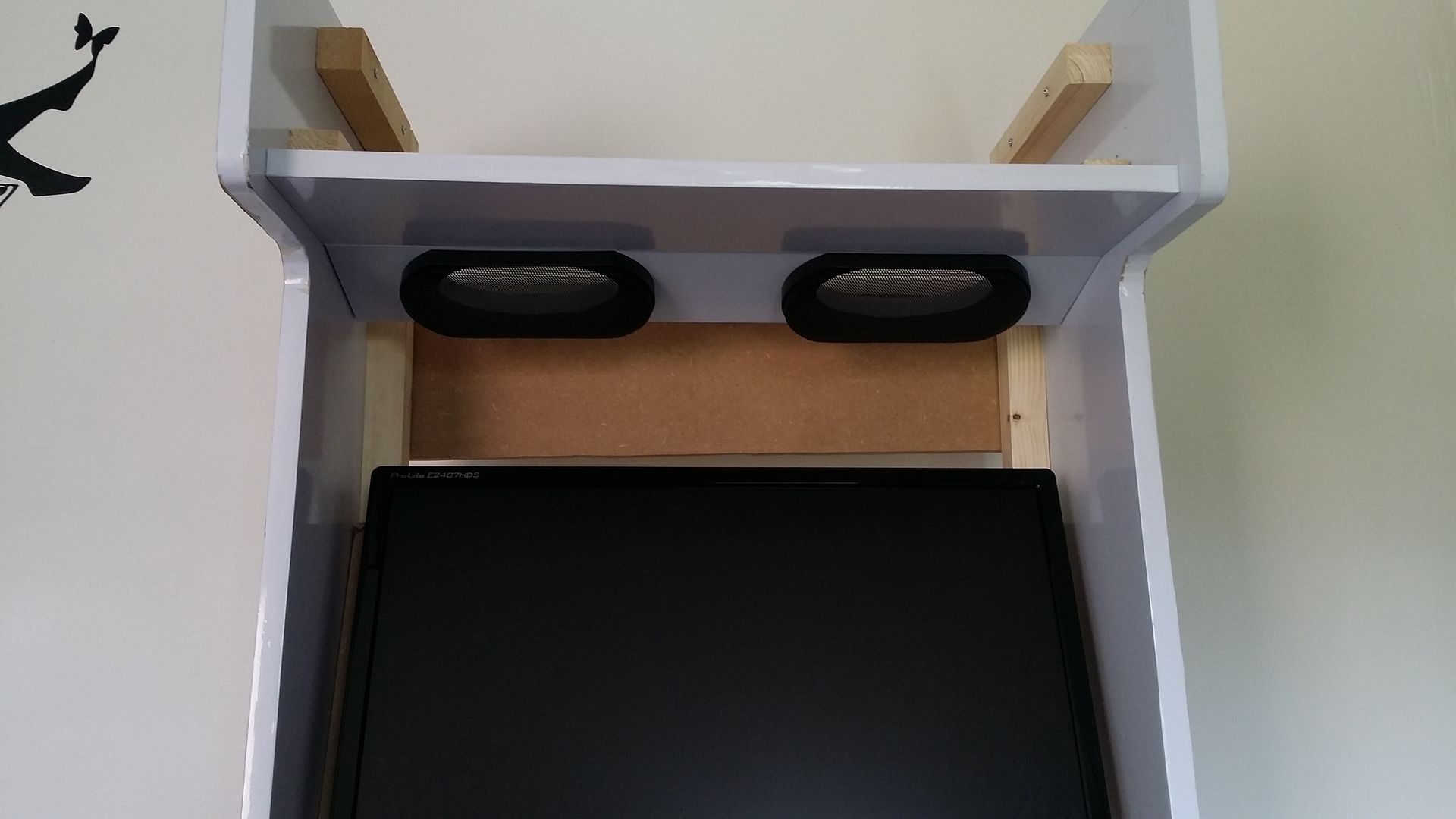

I fitted speakers and was lucky they just fitted.

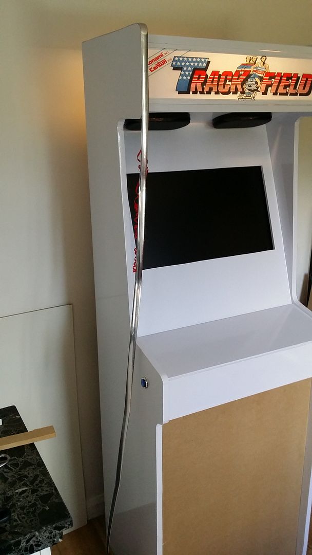

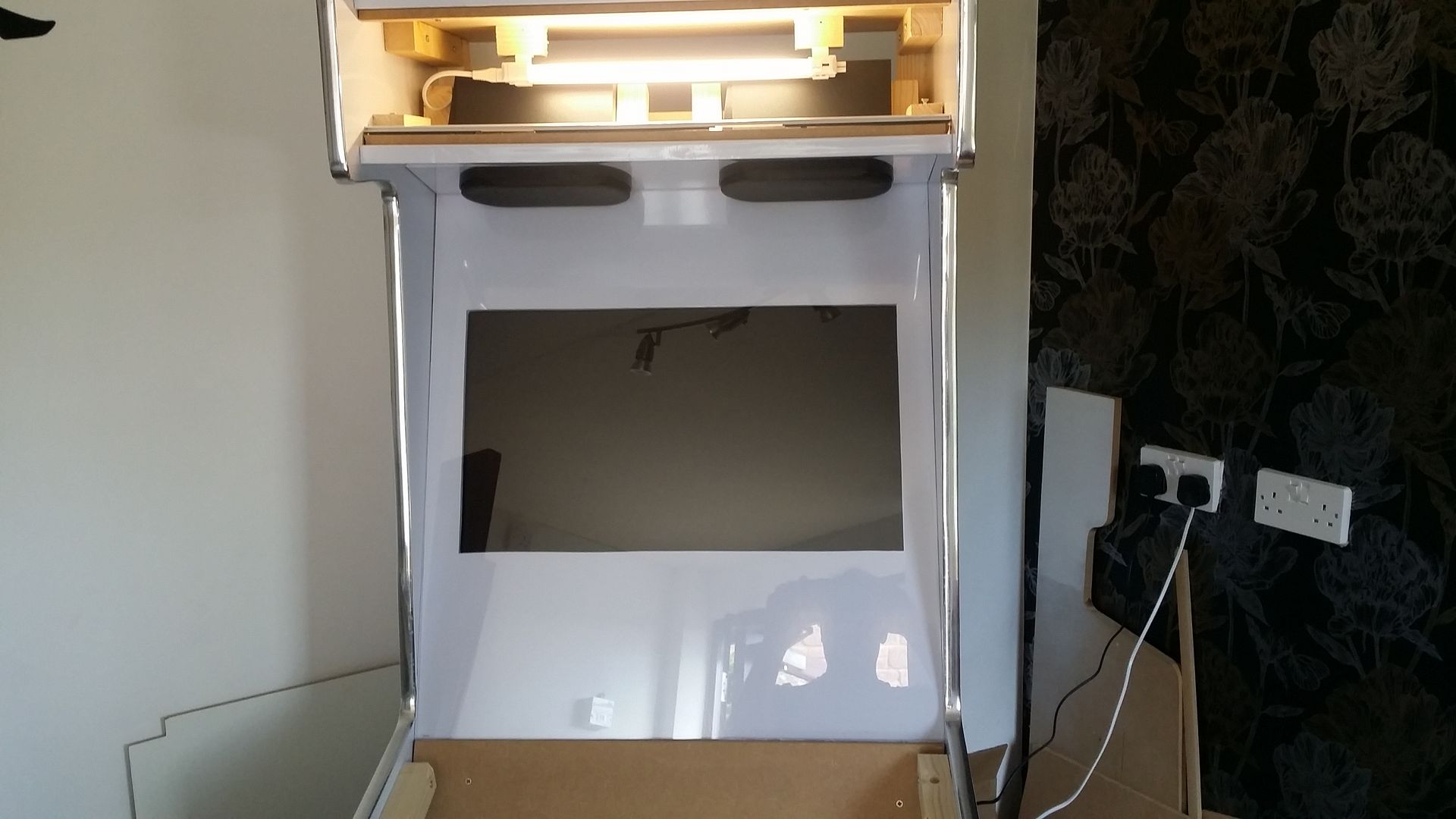

As I was on a budget and I dont own a router I was looking for a alternative to T Moulding. Also in the UK we use metric and the T Moulding is in imperial. As I was using 18mm thick board I sourced some chrome car trim for £8 for a 15 meter roll. This was more than enough for my cabinet and it is adhered by strong 3m tape. I was delighted with the results and it was dead easy to apply.
deano71
  • Posts: 58
  • Last login:August 30, 2015, 08:30:15 am
Re: Budget Slimline Cabinet
« Reply #21 on: May 14, 2015, 06:01:47 pm »

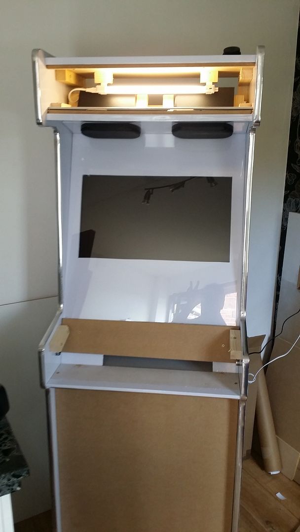

Final job today is to cut the plexi glass. This was easy to cut with a jigsaw using a plastic blade, but it did melt one side of the edge due to heat. For the control panel Im going to scribe and cut. Seeing the plexi in made a real difference to the cab and gave it a authentic look.
My screen was filthy as it was an old one im using. A good tip for cleaning is white vinegar and water 50/50 mix. Wiped on lightly with a lint free cloth brought the screen up looking like new.
« Last Edit: May 14, 2015, 06:17:00 pm by deano71 »

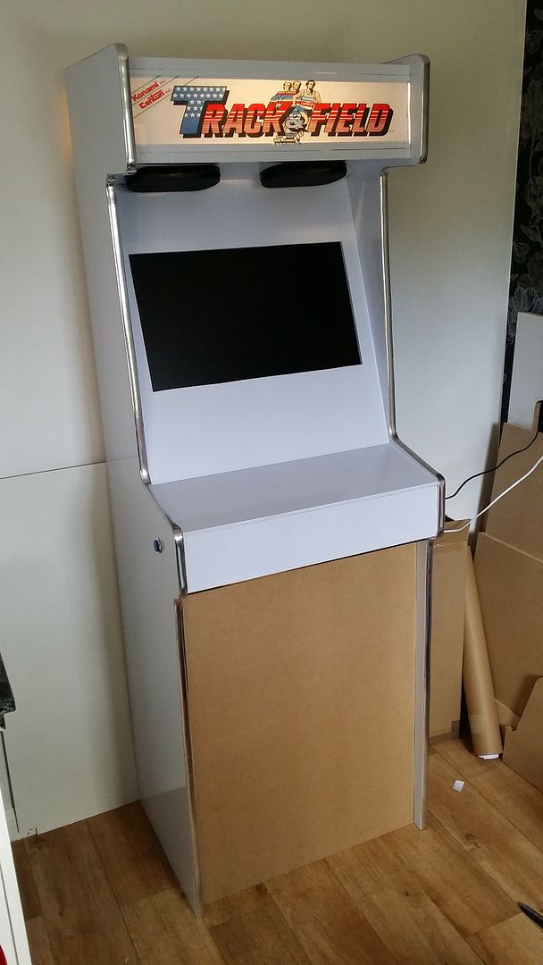

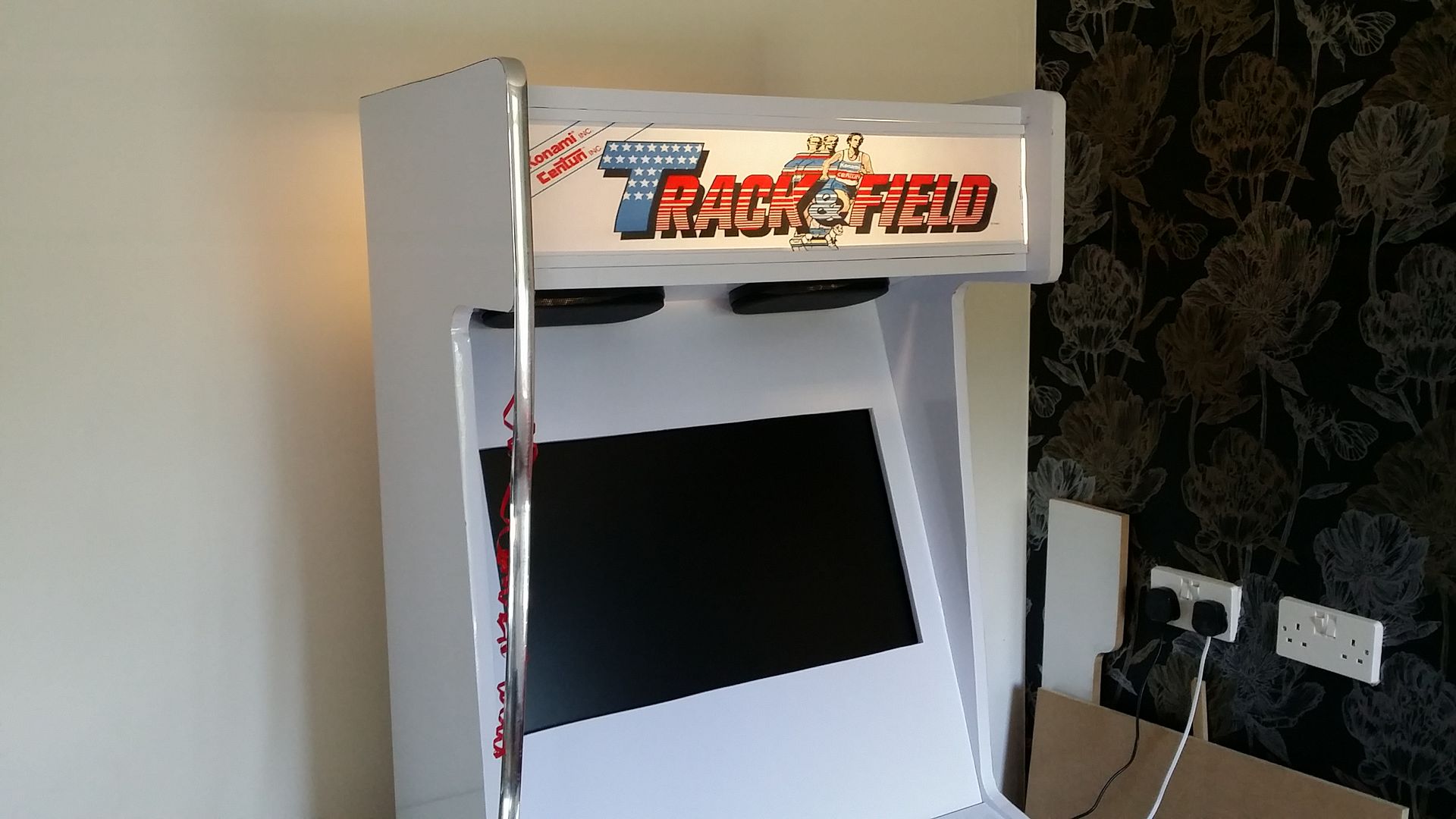

This is where I am up to now. Im happy with what I have achieved so far as I have never built anything in my life and Im restricted on the tools I have. Its taken about 10 part days with about 30 hours work in total to get to this point from the 1st cut.
This forum has been invaluable for ideas and workarounds so thankyou to everyone who has posted here.

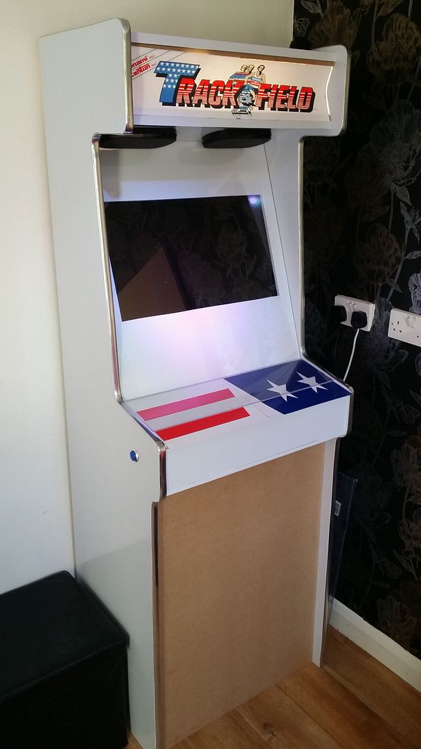

I am at a point now where I fit the control panel and get the computer set up.
I am  looking for a high quality Track & Field Marque image I can print if anyone can help as I cant find anything on the net?. I want a T&F type theme as I spent hours in arcades playing this game and it was like most of you  a dream to have a machine at home that had unlimited credits.
 I am also undecided as to leave the control panel white or put graphics on. As you can see in the pic I used a image from a bezel I found of the internet to see how that looks on the panel. Anybody know of any panel artwork that I might be able to use that would go with this theme? The original T&F panel is not going to match the marque. I am useless when it comes to Photoshop so I am not going to even attempt it!

SUPER clean, and you may be onto something with the car trim ;)
Also, I might have missed it, but why Track and Field?
deano71
  • Posts: 58
« Reply #26 on: May 16, 2015, 02:24:22 am »
I suppose its the game i played most in the arcades as a kid. The wife also wants it to be discreet as possible as its going in our cocktail bar and she is the boss hence the plain white finish.

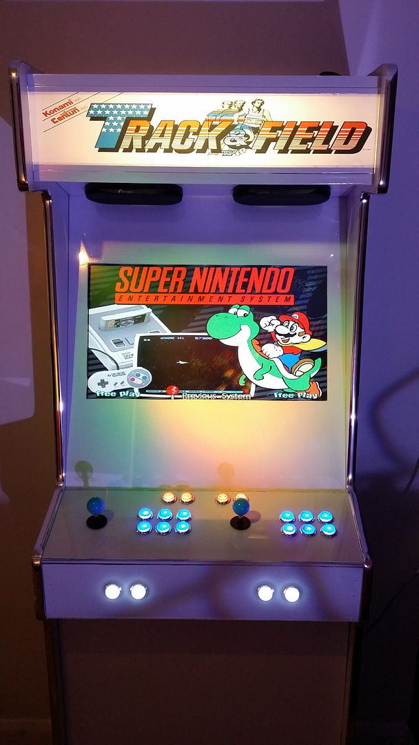

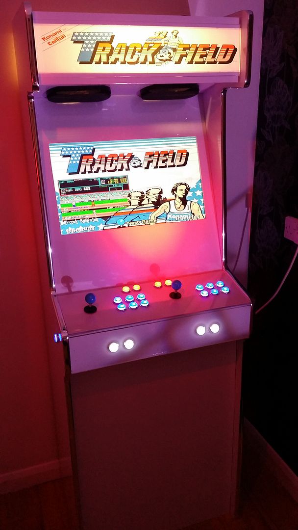

Well after a lot of headaches with Joy to key software I am finally up and running  :D I still have some emulators to set up and Im sure I will be tweaking the next few weeks.
As I said it was a budget build and costs are as follows-
Wood £46
Control Panel £56
Plexei £14 (Wish I used glass as plexi seems to scratch too easy)
Speakers £30
PC £30
Video Card £15
Monitor Free as I allready owned one that was sat in the garage.
Chrome Trim £8
Vinyl £25
Screws and Brackets £10.
In total I have spent £194 so inside my budget £56.
