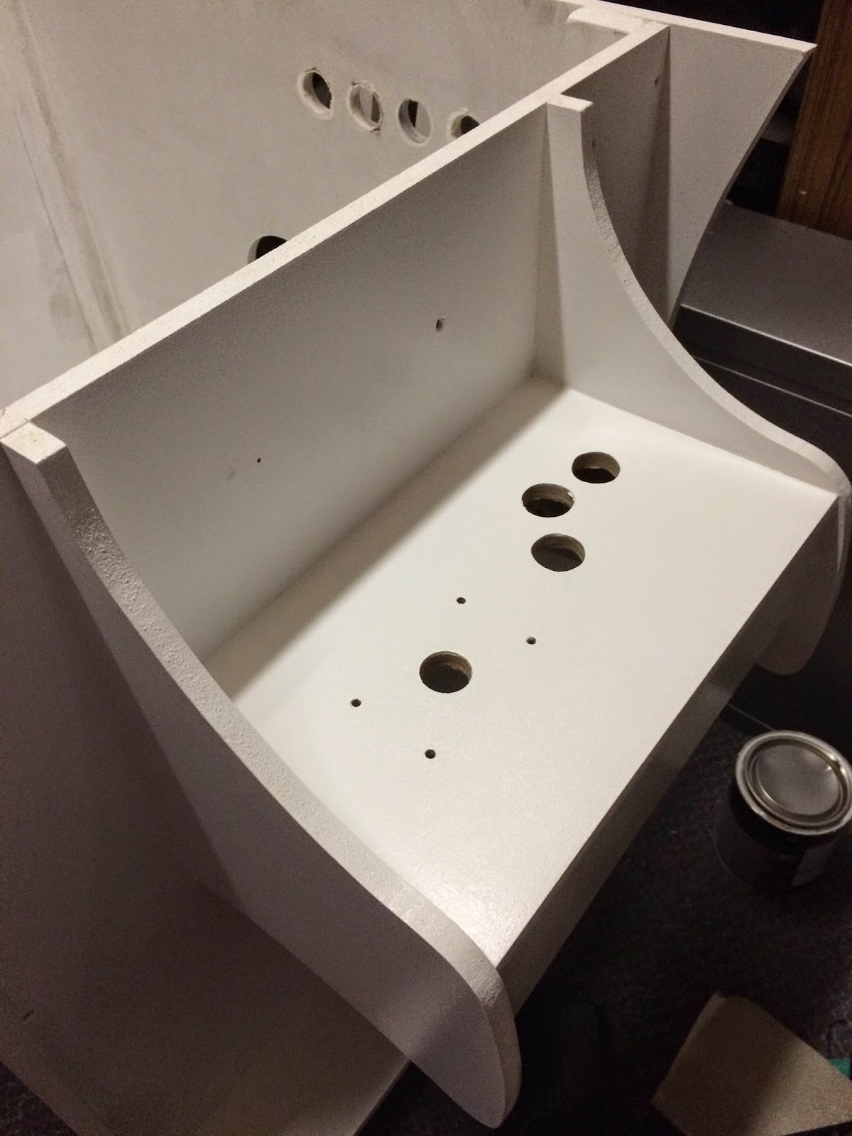

Do the buttons look too far apart? I am thinking i have made the controller box too wide.
jdbailey1206
  • Posts: 2656
Re: My new Cocktail Table Project
« Reply #8 on: March 19, 2015, 08:57:50 am »
My understanding is just from the Pac Man series cocktail cabs have 2 different sized control panels.
Pac Mans control panel was 11'' which can be referenced from this picture from arcadeshop.com
Also if you reference the Pac Man drawing package here you can see that on page two there is a detailed drawing that shows the total width of the control panel assembly is 12 1/2''.  This includes the two control panel sides that are 3/4" a piece and the internal metal control panel that is 11".
Ms Pac Man is a little different.  Her control panel only comes in at 9".  See below.
Just by guessing, and I feel I'm light in my estimation, it looks as if your CP is over 13".  Just on the inside.

If these buttons are to be action buttons, not admin buttons, they are definitely too far apart. Take a look at the following link (main forum, sticky 'Control Panel Database: Post a picture of your Control Panel!'), where you'll find 24 pages with pics of control panels. I doubt that you'll find a panel that has the action buttons so far apart.

Cheers for the replies. Think i will start again with the board.

I took some advice from contributors on http://forum.arcadecontrols.com/ about the spacing of the buttons. So i decided to reduce the gap between them and shorten the width of the control panel.
It look fine, so I am quite happy with it.

Spacing of play buttons looks much better.  :applaud:

Thanks. Now im thinking of adding a fourth. What do you reckon?

I think it looks better with just 3 buttons. I would have made the CP like this if I would use 4 buttons: (a Neo-Geo layout)
