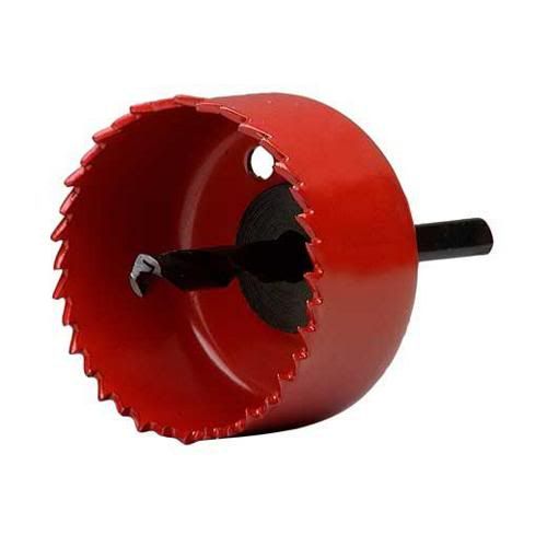

As for the trackball:  I have a GGG RGB 3" "high profile trackball, which is essentially a modified 3" Suzo-happ trackball.  I get the general router out the moutning plate, so that it will lay flush with the CP, and I will have to trim out the "football" shape for the trackball.
My concern is how do I cut the plexiglass?
 And what dimensions do I need to cut the hole?
rablack97
  • Posts: 2215
You have to have your CP layout pretty much complete
cut a 3" hole in your CP first where you want the center of the trackball to be, with a 3" hole cutter.
Lay your plexi on the CP and flush cut your buttons and the the t-ball hole, with a router and flush cut bit.  If you dont have a plunge router, carefully drill out holes big enough for the flush cut bit to go through.
Then go back and mount the t-ball, ball should fit right in the 3" hole.
MCSEFORSALE made a template for the happs t-ball, the thread should help you as well
http://forum.arcadecontrols.com/index.php/topic,119081.msg1261379.html#msg1261379
