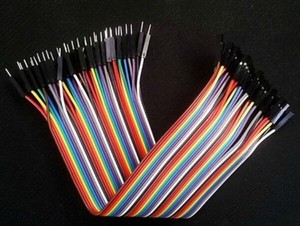

I've attached a pic of the connector for the trackball and the extra P1 wires. Since I am so new, I have no idea what to even google search for as far as connecting this guys to the J-PAC. Same with the speaker 9 pin thing. Got any advice?
The trackball cannot connect to the J-PAC.  The JAMMA standard only includes joysticks and buttons.
From what I see, I think the trackball is probably a standard (non USB) trackball.  If that is the case, then you can use a standard optical encoder interface to connect it to your PC...
Opti-Wiz (you want the no-solder version)
http://groovygamegear.com/webstore/index.php?main_page=product_info&products_id=260
Opti-PAC...
http://www.ultimarc.com/optipac1.html
You have to do some detective work to figure out which wires go where.
Here's the part of the Arcade Legends 3 wiring schematic that shows the trackball connector...
According to the schematic, it's a 12-pin connector with .100 spacing (.100 inch spacing = 2.54mm spacing).  So what you're looking for is something like the 6-pin male connector on this cable.  I think they call them "dupont connectors".  Basically, as long as the pin spacing is the same, it should work...
..but your trackball connector is a 12-pin female.
Rather than trying to track down a 12 position connector, the male crimp pins, some wire, and a crimping tool, I'd probably try getting something like this off ebay...
http://www.ebay.com/itm/391026510847
I think you can "tear" it into strips of however many wires you need.  You can stick the male ends into the connector on your wiring harness and the other end can either stick on the pins of the Opti-Wiz or you can cut off the female connectors and use the bare wires for the Opti-PAC.
For the extra buttons (5 and 6) for each player, you can do basically the same thing.
