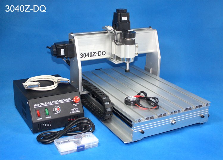

You say you used a 2.8" LCD, do you mean something like this one? (2.8" TFT LCD Arduino Mega 2560 shield selling for 7.50$CAD, if you are a visitor from the future and the link no longer works).
You also mentioned a small CNC machine. Can we see it?

The screens I use are something like $25, these ones.. But the screen looks the same, so if you're handy with linux I guess you could get the $7.50 ones working.
The CNC is a 3040Z, cheap Chinese, 280x390mm work area. Construction is ok and it has ball-screws, it would probably benefit from a better controller.
