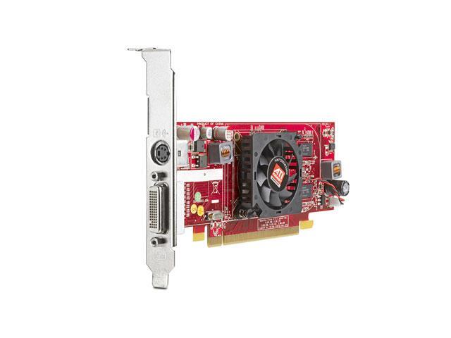

I have noo idea, but would this be a good candidate for the Driving Cab monitor (current broken CRT in the driving cab has a viewing area of 18", yes i measured diagonally) this is 20".   Would this be "composite"?
It looks like those inputs on the left are component (RGB).  I did some testing with a similar monitor and component inputs before ultimately going with an arcade monitor.  To be honest I was pretty happy with the results of the testing.  You will need a video card that can convert VGA (or DVI) to component if you want to use that TV.
or soft 15khz and a transcoder.
Or one with an S-video out (like this old ATI 4550) since the TV does have the s-video connector also !

That's component video on the left, and it shares audio with the composite video on the right. You can use component , just plug the guns into the green wire, else just use composite.

It looks like there is both a composite and component input on there. That should work for the PS2 if that's why you are asking.
