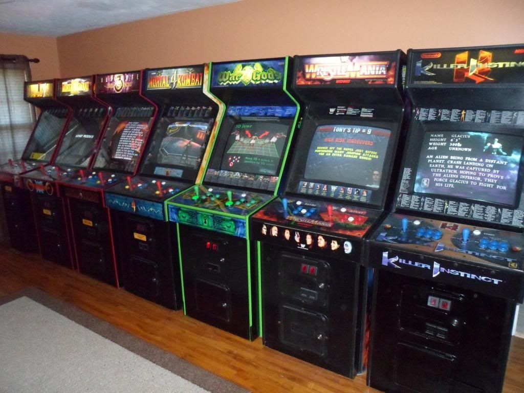

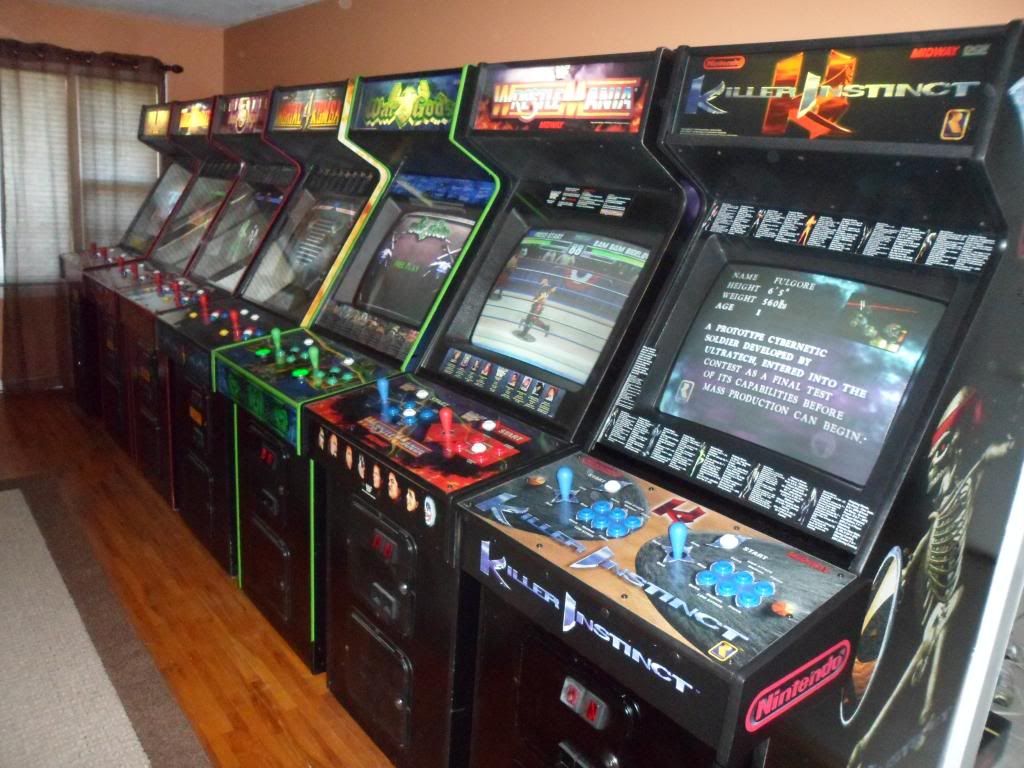

Re: Lets watch Malenko fix up a NFL Blitz
« Reply #18 on: December 16, 2014, 01:43:59 am »
Here's my newbie version of your (MK3FAN) 's Midway Row:
Most of my games are now gone/sold but here's what is used to look like. My KI2, Radikal Bikers, War: Final Assault and Mace: The Dark Age were in storage but if you want to include those, I was only missing the 2-Player Blitz and Midway Skins machine and I would have had them ALL!!!
