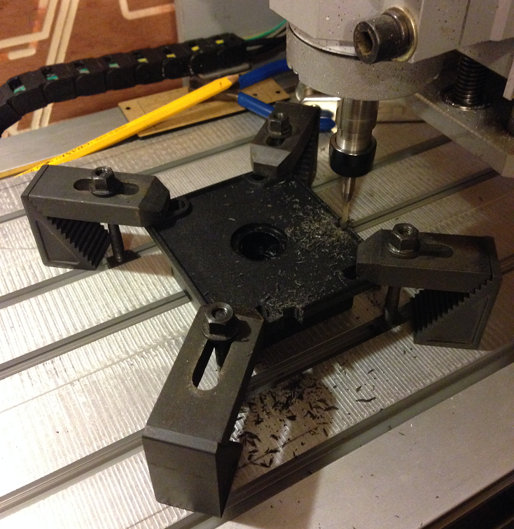

Sorry for the lack of updates.  It's the edge-lighting of the joysticks that is the bottleneck at the moment.  The spinners are done, the trackball and buttons all have lighting built in to them, it's just the joysticks that are causing me problems, but I think I've sorted it now.
Firstly on the defender/4-way panel, the defender joystick needs edge-lighting.  I've done it by using a 3mm plexi sheet and milling out a 2mm recess in the centre.  This means the joystick actually sits 1mm lower than it should be if it was mounted flush to the panel.  I think this should be ok and hopefully won't affect gameplay too much.  The artwork will go close to the shaft opening, leaving about a 4mm radius plexi ring around it exposed for edge-lighting...
The U360 was the other joystick (on the spinner panel) that was causing problems due to "bumps" around the mounting plate opening.  I've solved this inserting a 3mm plexi sheet between the U360 base and the metal mounting plate. Then I milled out a 2mm recess around the bumpy raised part so 1mm fits nicely over the top of it.  The mounting plate then sits flush on top.  This lowers the joystick by 3mm which doesn't seem too bad.  It also negates the need for a dust washer as the plexi ring kind of acts like one since it's so close to where the shaft sits.  This is good because I don't want flappy dust washers during the rotating of the panels.
On the defender/4-way panel, for the dedicated 4-way joysitck I had planned to bottom-mount a Dominux 8 with a 4-way restrictor, but this doesn't feel right, and doesn't lend itself very easily to edge-lighting.  I've switched this now to be a Pac Pro, which I really like the feel of.  This will be top-mounted with a 2mm plexi-sheet acting as a dust-protector (again solving flappy dust washer on rotation) sitting in the recess of the joystick base.  I'll be making the plexi insert and the metal plate very soon. Here's the idea...
Similarly, I'll be making a 1.5mm plexi insert for the 2x Dominux8's on the 2P panel.  I'll keep the dust-washers for these as they fit nicely in the joystick base recess (unlike the pac-pro!).  I already have the metal mounting plates made for these, so just the plexi sheets to mill...
So there you go... all the flappy dust-washers sorted, and the edge-lighting (I think!).  I'll need to make a couple of panel cuts to house these changes, but over the next couple of weeks it should all be done.  Then I'll finalise the artwork for the panels and order it, and then start the final panel preparations before applying the artwork.

Got the 2 plexi inserts for the Dominux8s made.  These sandwich in-between the joystick base and the 2.5mm thick aluminium mounting plate.  They are made from 1.5mm clear plexi and leave a gap just big enough for the dust washer to sit under it.  The alu plate hole is 30mm diameter, the plexi is 26mm diameter.  The shaft at full throw is very close to the plexi but doesn't quite touch it.  The addition of the metal plate and the plexiglass does lower the joystick slightly, but it still feels nice.  Panel surface to top of balltop is 66mm.
Next up... the Pac-Pro for the dedicated 4-way panel!

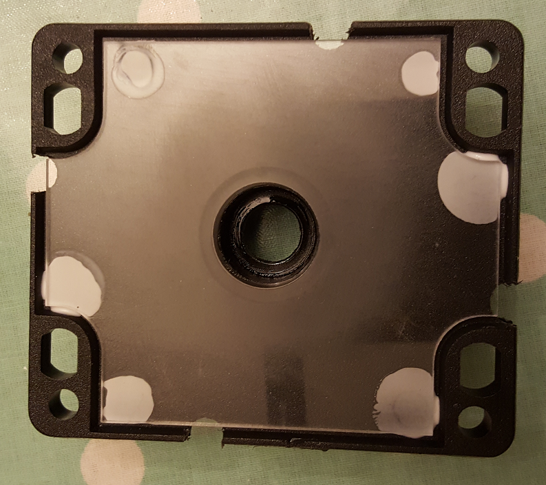

OK, first proper update in a while!  Finally getting back in to this now :)

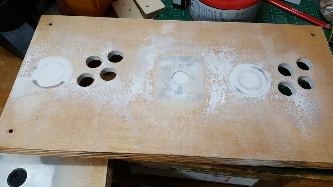

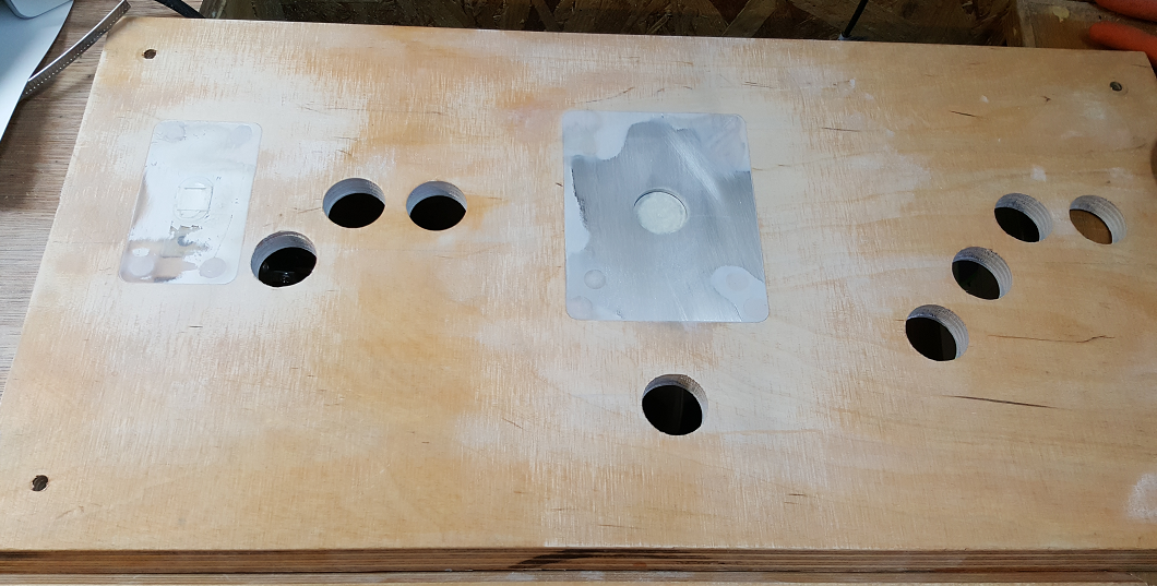

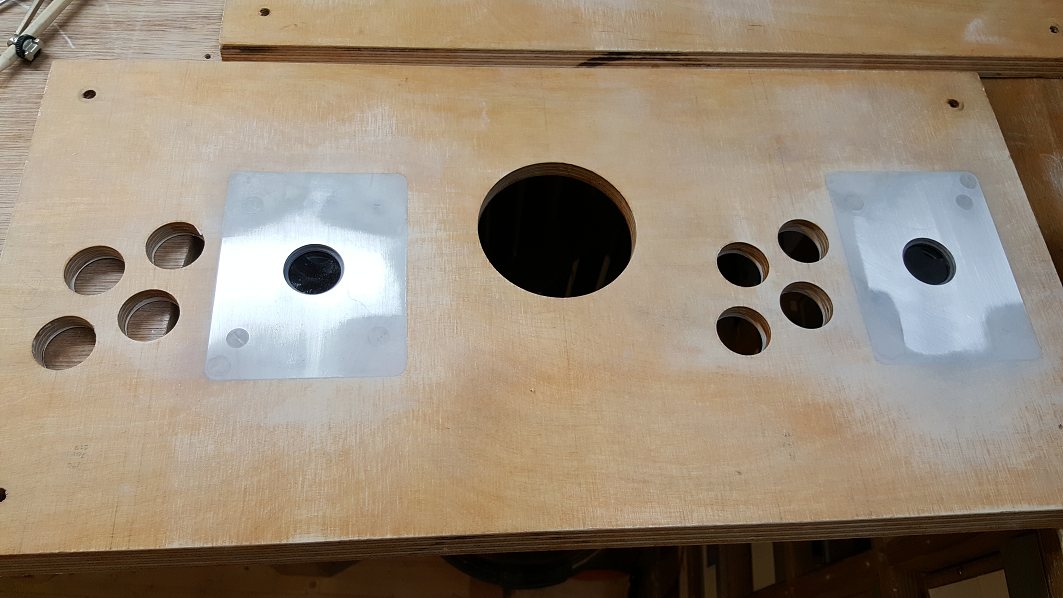

I have all the controls now ready for edge-lighting, but the pac-pro needed mauling so that the LEDs can reach the plexi...
Then some high strength PVA to lock the plexi in place.  The metal mounting plate will go over this leaving a nice edge-lit RGB ring in the middle...

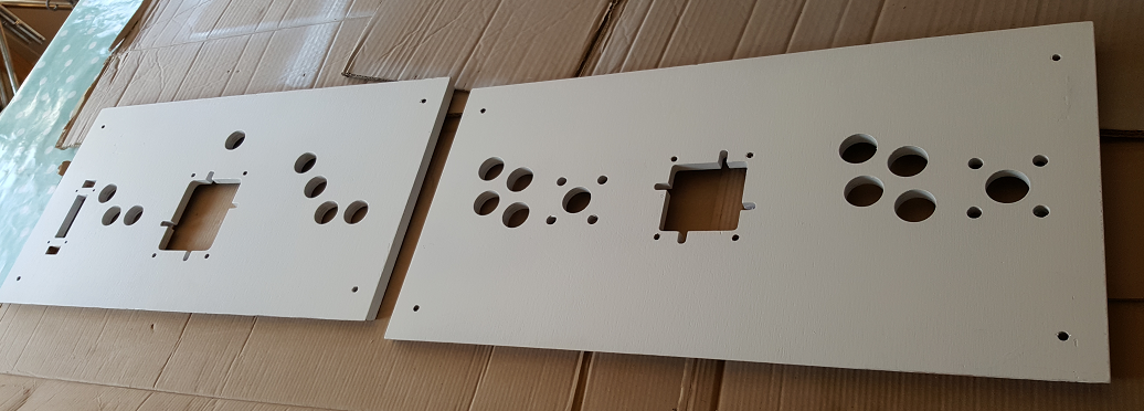

Next up, (skip forward 13 months!) I decided to spray paint the backs of the panels white because, well, I want it looking nice :)

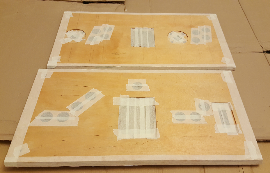

Masking taped over the control holes on the front and then sprayed a few thin coats of white gloss Rustoleum Universal All Surface Paint.  Backs look great now for wiring :)
Time to finish prepping the panels for the artwork.  I needed to get them filled and sanded so that there are no ridges around the control mounting plates (and plexi inserts) and the panel.  I used some Isopon P38 for this.  Seems to have worked great, now the panels are dead flat with no ridges :)
You can see that I masking taped the visible edge-lit plexi parts in the middle of the joysticks and spinners.

This weekend I got some spray painting done.  3 coats black Rustoleum and now no LED light shines through where it shouldn't :)  Surfaces are nice and smooth with no lumps and bumps...
I also started to cut the holes in the artwork. A little scary but the compass-with-a-blade tool I used was excellent!
The two-player panel lines up perfectly - very happy! For the joysticks holes, I cut them very slightly smaller than the actual holes for some wiggle-room (1mm diameter smaller).  I plan to use a stanley blade to cut them perfectly around the edges of the holes once the artwork is applied...
The defender panel lines up perfectly too (ignore the messy looking defender edge-lighting opening on the left, I have to clean up the cut on the left side of the artwork for that...
The 3rd panel, the spinner one... hmm... it was all going so well :(
As I peeled away the masking tape I realised I forgot to paint the wood underneath the plexi edge-lit insert.  It still shows the unfinished plywood underneath...
As you can see when the spinner is in it's not terrible, but still not what I want. It actually looks great in the dark when shining an LED on it from underneath, but in daylight it looks pants...
I can think of 2 things to help... Firstly, rough the plexi up a bit more to make it more opaque.  Secondly (as I've not cut the holes in the artwork yet), make the visible edge-lit circle a little smaller, so for example make the diameter the same as the widest part of the spinner flange near the bottom.  This would (I hope) still give a nice edge-lit effect as the spinner would cover most of it when looking from directly above.
Bah, I'm such an idiot. :(  If anyone has any better ideas I'm all ears.
Depending on the look/finish you are going for, here are 5 ways to proceed:
1. Mask the panel (and LEDs?) so you can spray paint the bare wood.
2. Hand-paint the bare wood with a small artist's brush.
3. Mask the lit edge of the plexi insert with tape then paint the back.
(the bare wood edge might still show if the insert outer edge is left un-sanded or un-painted)
4. Sand the back and outer edge of the plexi insert.
5. Some combination of 1-4.
« Last Edit: September 25, 2016, 05:07:47 pm by PL1 »
Jimbo
  • Posts: 1014
    • Wood Finishes Direct
Re: JIMBOVISION: Rotating CP [an update at last!]
« Reply #151 on: September 26, 2016, 03:51:12 am »
Thanks...
Unfortunately I don't have simple access to the back of the plexi insert as it's glued in with PVA and has been filled/painted over.  The bare wood is underneath.  I think I'm going to have to prise them out and re-prep the entire spinner areas. :(
My head is saying accept and compromise but my heart is saying do it properly.

Redo the whole panel.if you have to..no point in compromise
You know what you have to do...

yep.  no compromise.
I might try using a syringe full of black wood stain, and see if the ply will soak up the stain enough to cover the exposed area.  Worth a shot.  If that doesn't work, out pop the plexi inserts!  Gah!

Couldn't you just pva solution coat the surface first then paint it black? The PVA would seal porous wood. Apologies - haven't read the problem fully.

Just waiting on a few bits from ebay so I can continue with decimating the other 2 panels because of my stupidity in forgetting to paint under the plexi...
In the mean time, made some "jigs" so I can work on the panels for wiring and testing etc.  These are angled at 10 degrees, and are handy as I can flip the panels on them so the undersides face upwards to work on the wiring.  I got the controls all mounted now on the 2-player trackball panel, so this one is ready to wire up...
Those dominux8's feel great :)
You can see I had to make small mounting blocks to give space for the controls right up to the edges of the panels...
I made 3 sets of these jigs so I can have all panels resting somewhere sturdy until they are ready for the rotating contraption.
Next update will be about decimating the other two panels to re-prep them.
