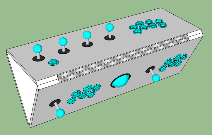

OK so call me over ambitious, but after some inspiration from darthpaul's ridiculously cool automated cabinet, I've decided I want a piece of that pie too.
Here comes the rationale on the controls I've chosen for the 3 sides.  I'm aiming for all joysticks to be leaf-switch ball-tops, and all controls to be LED illuminated (if I can).  Comments/feedback/criticisms welcome, of course...

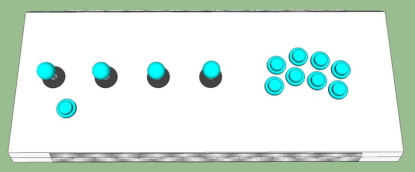

SIDE 1 - Single Player Dedicated
From left to right:
 - 2-way vertical joystick (for Defender) along with dedicated reverse button
 - 2-way horizontal joystick (for galaxians, galaga, etc)
 - 4-way joystick
 - 8-way joystick
 - 8 buttons - should give me enough for most games I can throw at it... the extra buttons will also come in handy for C64 emulation (e.g. buttons for Spacebar, Run-Stop, arrow keys, Return etc)

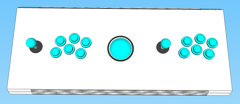

SIDE 2 - Two Player + Trackball
From left to right:
 - Player 1 controls (8-way leaf, 6 buttons)
 - Trackball (will use this also for Star Wars, and probably some ScummVM games)
 - Player 2 controls (8-way leaf, 6 buttons)
This will be my robotron panel! :)

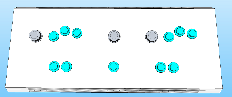

SIDE 3 - Spinner/Various
 - The top half of this panel is for 2-player spinner games such as Blasteroids and Two Tigers, plus with mini-racer wheel can be used for Super Sprint etc.
 - The spinner in the middle would be for dedicated arkanoid or various single player driving games (TT2 w/mini-racer wheel)
 - The bottom 5 buttons are for dedicated asteroids :)
 - I can also play Tempest on this panel :)
Can't play Tron. Can't play QBert.  Most of the other games I care about I can play though.  I don't think I've missed anything out but if something is glaringly obvious I'll be happy to hear it.
It's a bit snug under the panels, but all the controls fit and I have an idea or two on how to rotate it (thinking: stepper motor again). Keeping the CP securely in place after rotation is another concern... electromagnets maybe... needs more thought.
I haven't specifically allowed space for an interface such as IPac yet either... and I'm sure something else is going to come and bite me in the ass too.

Love the arcade design. The new updated rotating control panel does not follow the keep it simple rule. It's crazy, but not in a good way. You don't need to play every game. Focus on playing most games well.
Keep up the amazing renderings!

What the hell,
  I check this thread out one day and the cp is on the simpler side with only 4 buttons per player.
Then it gets a little more busy with an extra joystick then an extra spinner and I stil liked it.
Now this.

That CP with 4 joysticks in a row looks like a big WTF. If you really really need that many different controls than go with modular panels (Switchcade style http://forum.arcadecontrols.com/index.php/topic,112889.0.html). Or go with swappable panels (Blip style http://forum.arcadecontrols.com/index.php/topic,137295.0.html). In any case try to keep those CPs simple and obvious.

This is way overkill.  You can play defender with a 4-way joystick, I don't see the problem to warrant an extra joystick.  Hell, most of the spinner games you can control with a 4-way too.  I don't think there was anything wrong with the control panel you had before.  I hate overloaded control panels with hundreds of bloody lights, like a las vegas show or something.  Why can nobody keep it simple?!!  :soapbox:

OKAY OKAY... so I may have overdosed on the caffeine yesterday.....  we all get a little over excited sometimes, right?
On reflection (good night's sleep followed by a bacon roll)... you've convinced me to ditch the 2 x 2-ways, so the single player panel will have a 4-way (with defender reverse button) and an 8-way.
I'm fine with the spinner panel so I don't think I'm going to change that. The controls don't get in the way of each other and I've seen much much worse.
To minimise any confusion I'm planning on using LEDBlinky to highlight which controls to use with each game.
It might not look so harsh once you see the render of the panel in-situ in the cab.  I'll get a pic uploaded soon.
Have I earned an ounce of forgiveness now?  :cheers:

Still also got to decide where to put start1 and start2 buttons, and I want a 'Pause' and an 'Exit/Back' button.  Don't really want to duplicate them on each panel but I can't think of a viable alternative right now that I'd be happy with.
Oh, and ignore the metal piano hinge on the front of the panels... that will be covered up :D

AzureKnight
  • Posts: 474
Re: Cab 2.0 (upright new build, motorised rotating CRT+CP, LCD marquee panel)
« Reply #21 on: September 30, 2014, 04:10:07 pm »
Just a thought, for the start/admin buttons, what if you shift the monitor up a bit and add a 3" panel in the same plane as the marquee that holds all those buttons?
Jimbo
  • Posts: 1014
    • Wood Finishes Direct
« Reply #22 on: September 30, 2014, 04:44:46 pm »
Hmm something like that could work, yes, as I will probably have to move the monitor back/up slightly anyway due to the CP rotation.  :cheers:

How you planning on the actual rotating of the cp?
Typically you will need to have enough space between the cp and monitor for the panels swing.
In my opinion, it makes for a goofy looking cabinet because of that space

I've been working out how to get this CP thing to rotate over the last few days. I must admit this is a massive learning curve for me and I've never attempted anything quite like it before, but after speaking a fair bit with a knowledgable friend of mine, a plan is starting to form.
Current plan is to build a steel frame to hold the rotating CP and mount the whole thing inside the cab.  Due to needing space for the rotation/brake mechanisms, I've had to make the rotating CP section narrower than the cab by about 6cm each side.  This means I've slimmed down the controls a bit (yay I hear some of you cry).  But I'm still happy I can play most things I want.
There's a steel box section at the bottom with welded on steel sides. There will be a steel tube going through the entire control panel, held in place on the frame by a pillow block bearing on each end. On the side of the CP "triangle" I'll mount a timing pulley which will gear down to a smaller pulley attached to a DC motor.  The motor I have also has an optical encoder built into it.
Mounted onto the big pulley is a small flag that will pass through a photo interruptor sensor that is stuck onto the side of the frame on a bracket.
The idea of using the DC motor with the encoder is that I should be able to control the rotation with an arduino and use the encoder pulses to tell me exactly where in the current rotation cycle we are, or more to the point where we *should be* so that I can stop accurately and determine if some external force is preventing the rotation (someone's finger for example!).  This can help me build in a safety shut-off and perhaps show a warning message on the LCD panel etc.
The flag and photo interruptor are there so that I can get a valid "home" position when powering on and for re-calibrating.
Mounted on the other side of the CP triangle is a brake disk. A 25KG lifting electromagnet is mounted onto a bracket onto the sides to act as the brake. I've no idea whether this will be enough, but I've seen the strength of a 10KG one and that was pretty strong!  I guess I'll find out.  I'll be needing to attach some shielding to this too as I'm using a CRT!
The electromagnet will fire once the CP is in position, hopefully preventing any movement until the next rotation is triggered.
Like I said - this is a massive learning curve for me, and I'm sure once I get started there will be lots of changes.
Might have to actually start building a prototype soon!
