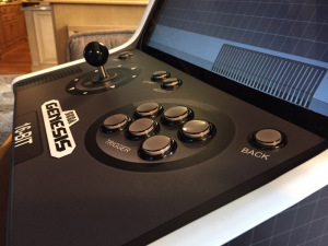

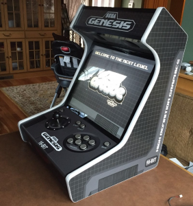

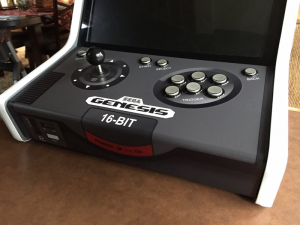

Well I am marking this guy finished. It turned out way cooler than I ever thought and I want to thank all of the great comments and help over the last few months. Can't wait to get started on my next project, a 2-player stand up. More pics are located at the end of the thread.
***NEW ***
PDF plans are now available attached to this thread. They are all 1:1 so you can try to print them full scale for tracing, or use the plans to draw on the wood. They are dual dimensioned so that it includes both Inch and Millimeter. They are shown as     in [mm]
I also exported a DWG file from my cad system which is the only format that is compatible with sketchup. It's in the zip file below. It works but it's not perfect.
