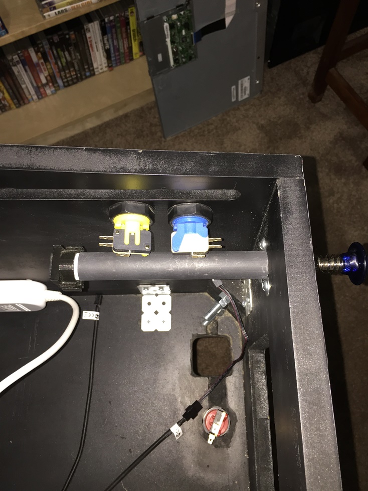

Work continues on installing all the components and wiring the cab up. Generally going well, but not without difficulties in some spots. Most of them are to do with routing all the cables around the sliding drawer, or leaving enough slack in the cables that attach to something on the drawer. With hindsight, maybe not the best design choice… oh well.
The items at the front right of the cab are quite tightly packed. I had to fit the plunger and the flipper buttons below the slot where the screen slides in, but I didn’t want the plunger or the buttons to be placed a long way down the cab. Overall I am happy with how it looks and functions. Oh, and that scrappy work in the bottom of the cab is an underside pause button and a hole for the volume slider that came with the speakers. If you’re going to have pause and volume controls I figure they should be out of sight.
Main power is handled by an “eco” power board (smart strip). I have the PC hooked up to the master outlet, and the 3 screen and speakers on the slave outlets. Works great! Screens go off with the PC, not just into standby. This was particularly important because the little DMD screen displays a blue screen when it has power but no signal.
I cut the plug off the power board and hooked the wires up to a panel mount socket. Other work done on the back of the cab – installed a power button (connected to the PC on/off switch), and a panel mount USB for quick updates. Grills installed over the rear fans – I would have mounted them at 45deg, but the mounts were on the exact same diameter as the fan mounts and the screws would have fought for the same space. No big problem, but just doesn’t quite look right.
Inside, I have put the PC, PSU and the HDD on the drawer. Towards the front I have a small sub woofer that came with the Logitech 2.1 speakers I am using. The speakers themselves will be in the back box next to the DMD screen.
A pic of the front of the cab with parts installed. Gonna have to put inserts in those buttons.
That's all for now. I'll wire up the control next and install everything in the back box

With a few distractions of late (kitchen renovations and holidays) I have had some time to rethink some of the hardware choices in the pin cab. First up, I ditched the Core2Duo based system, as it was running a bit slow in the frontend with the multiple screens and videos going at once. Replaced it with a 3rd gen i5 system I found on eBay for cheap. May end up changing the HDD for a SSD, but it’s less critical.
Also, sadly the plunger kit from Virtua Pin wasn’t performing as well as I had hoped. It worked ok in Visual Pinball, but it was very jittery in Pinball FX 2. Also, it would not always get detected by the PC when it was plugged in. I noticed that the Virtua Pin web site doesn’t stock these any more, presumably because there have been too many complaints. I replaced the kit with one from Zeb’s Boards and it works great. It has a mechanical sensor attached to the plunger rather than the optical sensor the VP kit used. I just wish I bought this first!
So with the hardware and controls all sorted, it was time to finish up the cab itself. I used some weather strip seals on the side edges, so that the glass would sit snug under the side rails. I also glued some 1mm foam strips on the underside of the side rails, so that the glass wasn't hard up against the metal surface. I can slide the glass in and out if I want, but it won’t move around on its own.
Applied some T-Molding (from GGG) around the back box and installed side rails, glass and lock down bar. Rather than finding a lockdown mechanism to fit in my mini cab, I found some 3M Dual Lock strips did the job nicely. They are like adhesive backed Velcro strips on steroids, holding the lockdown bar to the top of the side rails. Everything is quite solid, but can be opened up when needed. Here are some photos of the completed cab. All up I'm pleased with how this turned out  :D
