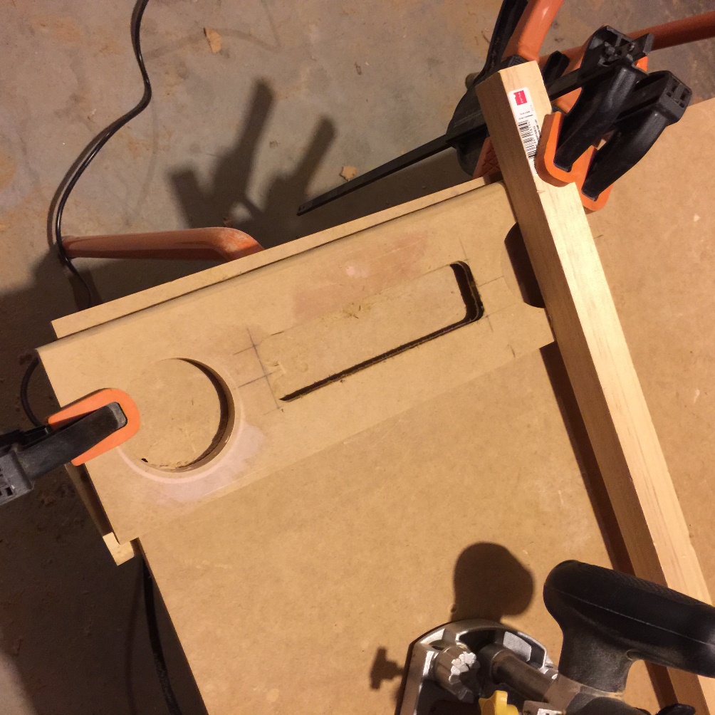

* For cutting out the sides an other panels, I whipped up a saw board. Highly recommend this - it improved my cutting with a circular saw by a mile.
* With the two sides cut, I clamped them toghether with the factory cut edges lined. I then ran the router around the edge with a flush cut bit. Result = two sides exactlly the same size  ;D
* Temporarily assembled the panels with wood screws and brackets. The brackets are ok, but the panels don't always line up perfect. Might have to clamp and glue as well when I am happy with the cab assembly.
Now for the new stuff..
Routed a slot in each of the side panels so that the playfield monitor can slide in without any of the case showing. Was a bit tricky, because of a tiny cable that runs to one corner of the screen. To accommodate this I had to put a tiny step inside the slot.

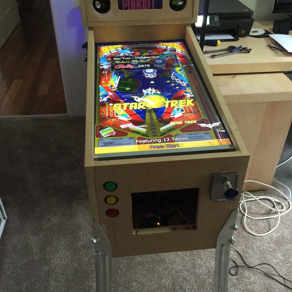

Well it has been ages since I've done an update, but I finally managed to get some more work done on this build. Things are coming along nicely, even though I've made plenty of mistakes. My work is a bit sloppy in places because everything I'm doing is pretty much a new experience  :)

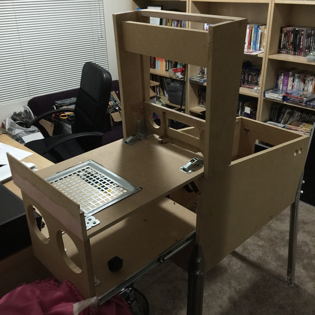

First up, I've partially cut out the front panel. It now has holes for the coin door and the plunger, but I've still got to figure out what I am going to do with start, exit and coin buttons. I also unscrewed the cabinet panels because the alignment was quite bad. Have now clamped and glued them with (most of) the edges lining up good enough to be sanded flush later.

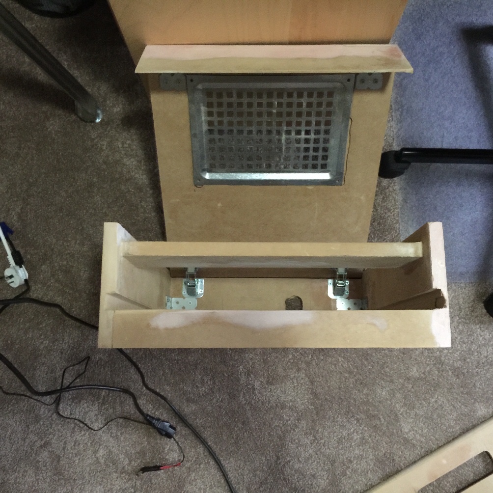

I've also added a drawer shelf with the back panel attached to it. I've used "push to open" drawer slides which work ok. I'm not 100% convinced I want to use these over regular drawer slides.
For mounting the motherboard on the shelf I have taken the mounting screws out of an computer case. With a small pilot hole they easily screwed into the MDF. It won't be super strong but is fine for this purpose.
and up close...
Lastly, I removed the back panel to cut some holes and route a recess for some cooling fans. I'm using just a couple of regular 120mm PC fans. I will place another 2 on the underside of the cab to promote airflow in to the cabinet and then out through the back.

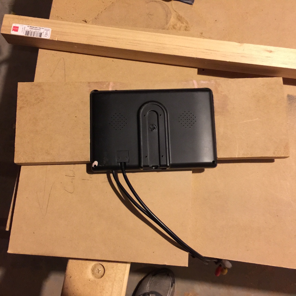

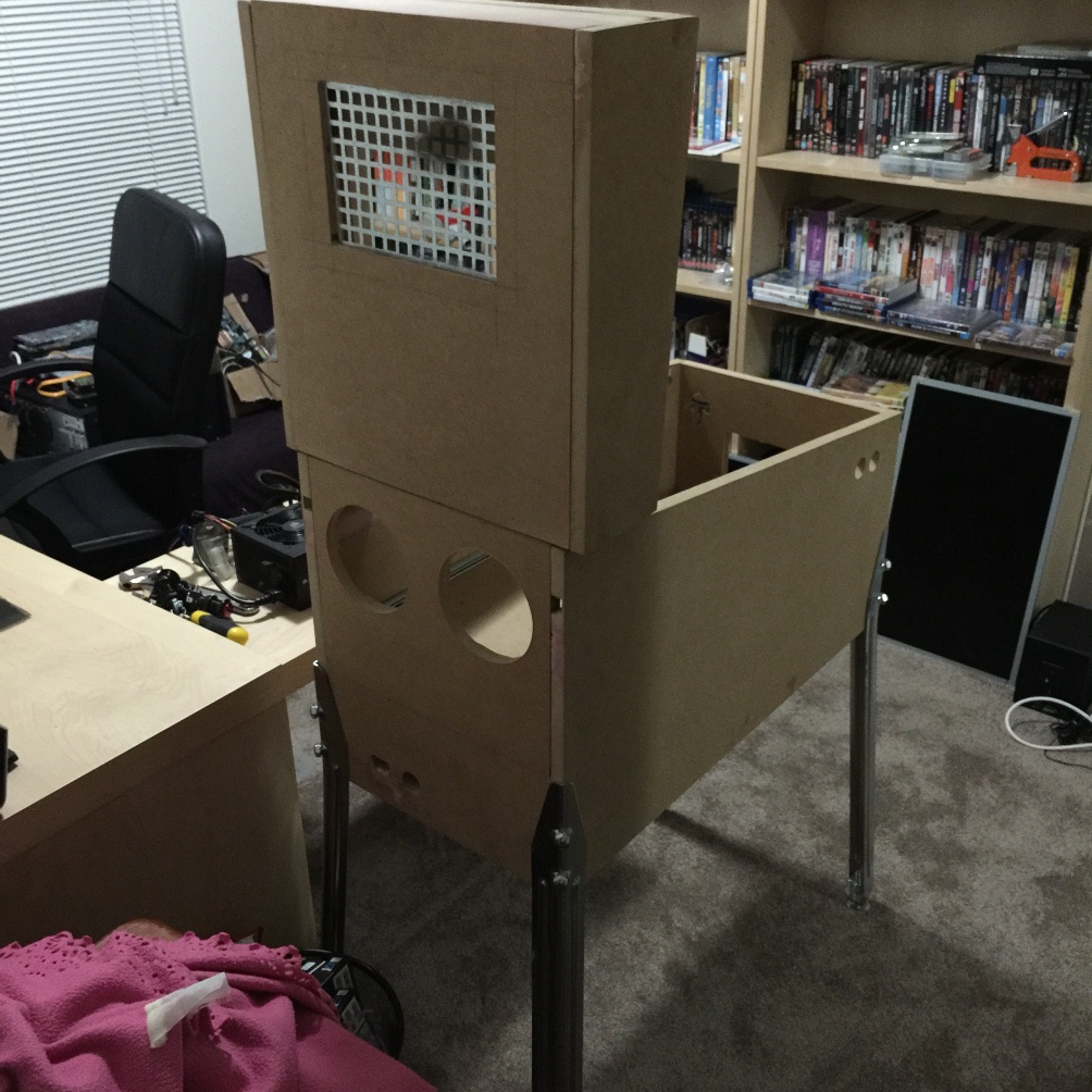

The backbox has been completed, but not after some pain. I had it mostly done when I accidentally knocked it off the work bench  :cry: :hissy: All the joints came apart and I had to rebuild it, doing the best I could to smooth out anywhere it had become uneven. It will never be quite the same as before, but overall I’m happy with the outcome.
Since I decided to go for a dedicated monitor for the DMD, I had to make a panel to house it at the front of the backbox. I will also fit the speakers in this panel. I started by routing out a space for the monitor.
I rounded the top edge of the panel, and cut a DMD aspect ratio size hole where the monitor sits. A lot of the small 7”monitor will not be seen, so that the correct aspect ratio can be kept. I also cut out some round holes for the speakers and routed a square cavity behind them where I will eventually put some speaker mesh.
Here is the mostly complete backbox, and a view from the top showing the hinged back panel and where the monitor slides in. That grill at the back should look better once I paint it black.
And here it is with the rest of the cab. I got some authentic pinball cabinet legs – these make the cab look a whole lot more legit.
Some photos from the back showing the slide out drawer for the PC and the backbox access.
I put all the guts inside for a sanity check and to see if I have to make any adjustments to the cab before I start prepping for painting. Everything fits ok but I will have to make some extra holes to run some cables to slightly different places. Lastly I gave it a test run. I think it looks a lot better than my original 2 monitor setup.
So I'm happy with the build so far. I think it is time to start getting some coats of paint on this thing. My plan at this stage is to throw on a few undercoats first, inside and out. The outside sides and front surfaces I am planning to cover with printed vinyl, so I will spray these with gloss black (I read a smooth gloss surface is best for adhesive vinyl). All other visible exterior surfaces will get a few coats of satin black.
