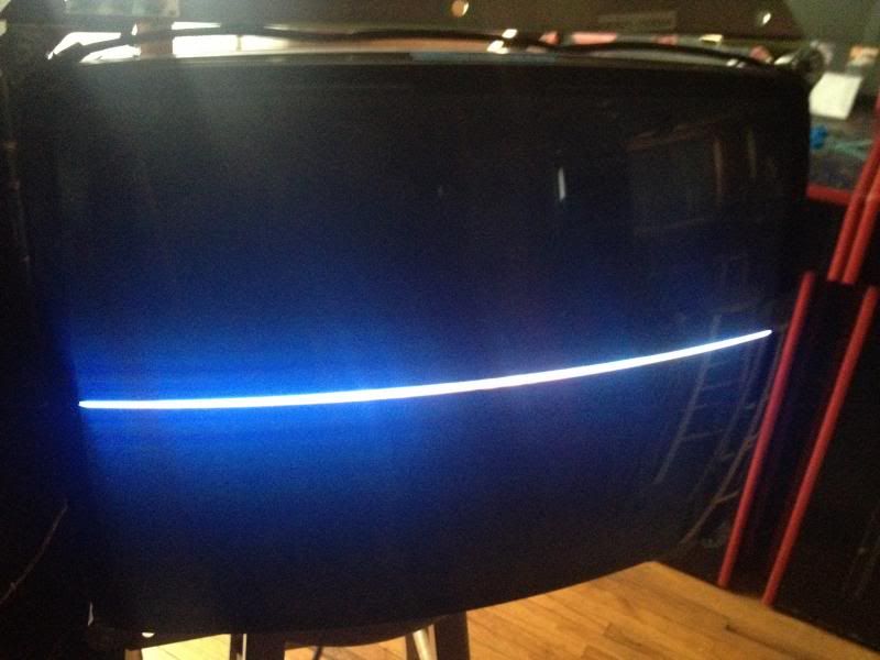

Hello All,
Recently, my flyback transformer failed.  The typical failure from my understanding: a steady stream of fault current from flyback to the metal partition to the left of it (if looking into the back of the cabinet, at the flyback and video board).  The flyback fails about once a year, this time I squeezed 2 years out of it, but new it was starting to fail at the one year mark - if I turn my cabinet off after playing for a while and then back on, the video would be all garbled.  It seems to be heat related, because I could let it sit for 10 or 15 minutes, turn it back on, and all would be fine.  The "cooldown" period would have to be longer on hot days and shorter on cool days.
That aside, I replaced the flyback and capacitor kit.  The kit I had for a couple years.  When I hooked it back up, I ignorantly connected the H sync and RGB connectors backwards.  So R was on H sync ground, blue was on H sync; H sync ground was on R and H sync was on blue.  I also failed to connect the gray cable that comes off the neck board, to the one in the cabinet.  This cable surrounds the back of the monitor, and I'm guessing is a ground.
When I first turned it on, with things connected wrong as outlined above, there was no video.  There might have been a slight burning smell, but nothing persistent, nothing that I could see was on fire, and it didn't replicate once I fixed the above described mis-connections.
Now, I get what you see in the picture.  The only adjustment that makes any difference is the "focus" and "screen" controls.  The make the line slightly taller, with more color, and make it go way completely.  "Vert Hold" makes the line move up and down slightly.  All other controls do nothing.  Thoughts?  Was the initial mis-wiring the cause?  Or have I possible replace a cap (or more than one cap) with the wrong replacement(s) from the kit?  I am going to re-check all the replacements again, but would appreciate any feedback, especially if other have experienced this.

i can't see anything obvious in the photo so next step will be to check polarity of capacitors on the vertical deflection circuit,in particular around the vertical deflection ic
next step is change the vertical deflection ic as it may have been faulty anyway

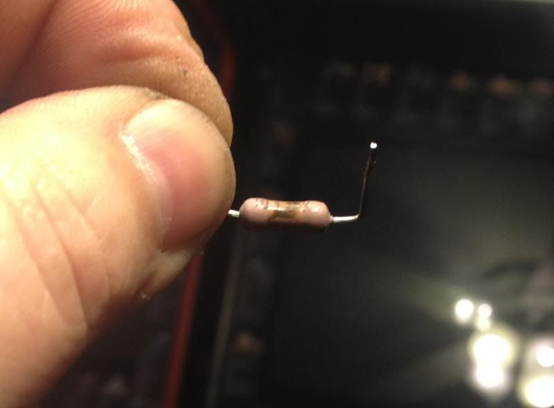

your pic you posted before of the bridged solder joint??? it's good.
looks like the pad got lifted off so they just bent the lead back over to the next component and soldered it up to make good contact and not have the weakened trace burn out.
if you look closely, you can see there is a foil trace slightly underneath.
ALSO:
k7000 no vertical deflection?
check R91 - 1.2 ohm 2 watt
check D13 - often goes out.
Check the polarity of C40 - 2200uF 35 volt
Check D25 can go open or shorted.
Check polarity of C48 - 100uF 35 volt.
(copied from a post-it stuck to the side of my computer...must be right.)

Here is what fixed my vertical collapse on my K7000 (copy and pasted from over at KLOV)...
Just picked up a working K7000. Installed a new fly and full cap kit. Fired it up and it looked great, got everything adjusted and all of a sudden the brand new flyback cracked and started arcing profusely. I turned the cab off immediately, removed the chassis from the tube, removed the flyback and saw this...
Damn thing was brand new. I've always heard about bad batches of flys but I've never ran into one. Well, looks like it happened this time. I re-installed the old flyback and when I powered the chassis on again, I got vertical collapse and then D13 smoked/shorted. So I replaced it, checked everything in that area, it all checked good and reinstalled/turned the chassis back on again. Poof! Fuse blew. HOT shorted.
So now I've got a lot more troubleshooting to do while I wait on the new HOTs I ordered to come in. ARGH!!
I got the Flyback from TwistedQuarter. I've ordered MANY cap kits/flys from them and NEVER had any issues. I don't even remotely consider it their fault. How could it be? As with all things electronic, you never know how long it's going to last. Regardless, I contacted them and told them what happened and I am awaiting a response. Hopefully, I can get a replacement but now I have a dead chassis that was working before that I have to fix. That's the most frustrating part for me.
On the vertical collapse issue, let me just say that I've never had a K7000 in VC that wasn't an IC issue but I have to wait until my new set of HOTs arrive (ordered 10 of them because I'm tired of never having any on hand) to start testing them. Oh well. First world problems.
Partial Success!!
I received my HOTs and some solder wick from MAT Electronics today. Started troubleshooting....
-) Re-installed original flyback.
-) Installed new HOT.
-) Critical Safety Cap(s) test good in circuit.
-) VR was shorted across pins 3 and 4.
-) Replaced VR.
-) R107 tested OPEN in circuit. Replaced R107.
Found no other issues so I re-installed the chassis and powered it up. It fired right up but my exuberance was short lived because it was in vertical collapse. Damn. What's next? IC1?
Total Success!!
-) Tested R101 and it's traces. Good.
-) Replaced C51.
Still collapsed.
-) Tested R91 in circuit. Supposed to read 1.2 ohms (basically shorted). Meter didn't ring so I removed it from the circuit to find that it was completely open and burned up...
-) Replaced R91 and gave everything else another good lookover. Fired the chassis back up and...BAM! Collapse fixed and back up and running. Maybe this will help someone else in the future. TwistedQuarter contacted me and told me they are sending me a replacement flyback from a known good shipment so I'll install it when it arrives and hopefully it'll be ok this time.
-) All told, the bad flyback took out D13, HOT, VR, R107 and R91 (either directly or indirectly).
