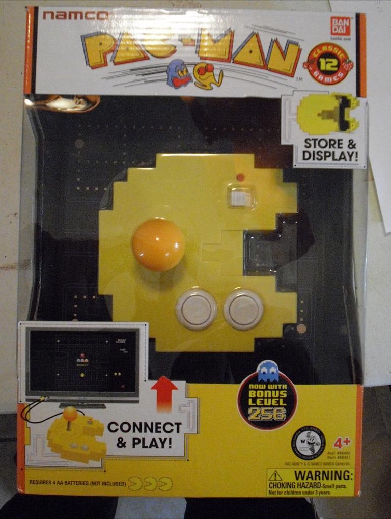

First thing I needed was to source one of the PNP units so I took a trip to the local K-mart and discovered that they had just received a new shipment of the Namco Pacman units for $25 ( they had been OOS for several months so I thought I was going to have to resort to Ebay for a used unit.)
Got home and had to test it for awhile to ensure it worked correctly so put in some batteries and hooked it up to the TV I thought would be used in the build - an old 13" Disney Princess TV that my neice had outgrown.
Everything worked fine but there were a few problems - First being I had started looking at designs for the unit and was leaning toward a Weecade Clonish shape which this TV would not easily fit in unless I really scaled it up and I wanted something with a smaller footprint. Second and more of a problem was this TV did not have a button to set for AV mode (you had to use the remote control to switch to AV mode and it did not stay in AV mode when turned off) - so after some contemplation (and purchasing an AV to Coaxial converter at Goodwill for $2 that bypassed the second problem) - I decided the 13" TV was not going to work for this build. So started looking for other options.
