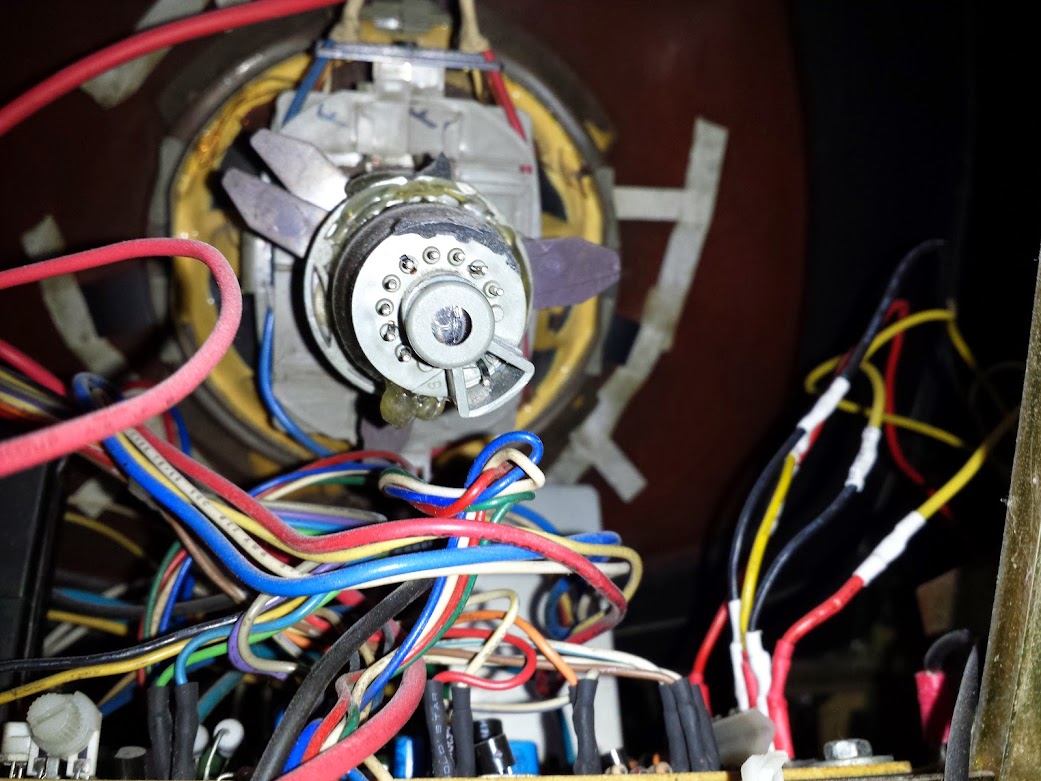

So, story time.  I started this arcade project a long time ago (and yes, feel free to laugh at my original timetable) but I'm almost done.  I have everything aside from the front plexi and final calibration of the monitor done.  I didn't compromise (much) on the contents of the machine and I still want to add coin-up buttons and at least a hidden 'esc' key (unless I configure the software a bit differently).  I may also add external USB ports and an aux input to use it as a set of speakers, but that's after I declare it done.  I will update this post with pictures (and maybe video) after I get home today, but for now I'll just have a text description of my issues.
I have been working on this monitor almost as long as the cabinet itself and I thought I had the issues sorted but it's still got something up.
What I have done:
1. Cap kit
2. new pot on control board
3. reflow solder
4. new flyback
I haven't tested any resistors (that I remember) or other capacitors.  I haven't checked the HOT, or any other relevant parts because I thought the issue was gone.
The problem is this:
The monitor looks beautiful on initial power-up but within minutes goes completely out of focus The focus control on the new flyback can't bring it in (and can barely be seen to do anything) and I can't tune up the colors until I have a stable picture.  I have been using my Simpsons board as my gold standard to check if it's the signal I'm giving it or the monitor itself, but I splurged on one of those VGA to CGA converters floating around on e-bay so I think the signal form there's pretty solid (even does color bars when it has no signal which is cool).  As an electrical engineer I can imagine a loose high voltage wire being the problem where over a long time (electrically speaking) a charge can build up and it appears ok to start with, but it drifts out of focus.  I will admit I have a limited knowledge of CRTs, and I can dig more into what these symptoms mean at a component level if need be, but I figured that someone with experience could point me at something obvious (except to me).
Secondary symptoms include the monitor developing a high static charge on the tube (I know some CRTs just do that, but I thought I remember it not doing that after I replaced the flyback).  Crackling a lot on startup and shutdown (same situation, maybe it's supposed to but it doesn't sound "good").  There's also a clicking (I hope not arcing) at a fairly regular and quick pace (maybe 30 HZ, I can check) and the picture bobs up and down slightly (maybe with the clicking) and has a slightly perceptible intensity wave move up it (I seem to remember).
Like I said before I will update this with pictures and video, but I can't for now.
Any help would be greatly appreciated,
Evan Allen

« Reply #1 on: June 02, 2014, 12:19:32 pm »
sounds like,
crt socket or focus wire is not soldered correctly
dag earth is no connected
abzman2000
  • Posts: 217
  • Last login:August 26, 2020, 06:25:12 pm
  • I LIKE my hat!
Re: WG 25K7191 problems
« Reply #2 on: June 02, 2014, 07:04:36 pm »
ok, it turns out I had the focus pin bent in the socket, it wasn't making contact with the neckboard.  That's fixed.  I did screw up the grounding too, a cheater fixed the crackling and static-y monitor, but there's still an inescent ticking and throbbing of the picture.
