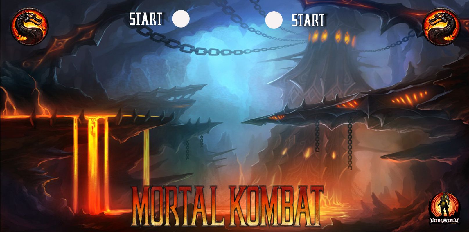

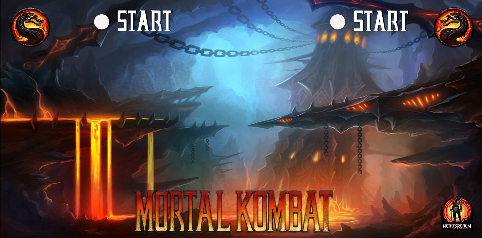

okay guys. after dissing my magical sharp pineapples of death and busting on my diamond plates. Here is the final revision of the control panel. 100% pure martial arts awesome-sauce. Only thing that would make it better is some blue lighting.  ;)
I worked really hard on this so go easy.
Also, there are 3 ninjas hidden in the image. If you guess where they all are, I'll give you a cookie. And the nether realm logo doesn't count.

That looks pretty good.  I'd probably toss some kind of outline around the letters and maybe shift the MORTAL KOMBAT a little bit.  Your best design yet, though.
Are they the black bits behind the logo?  :cheers:

I don't think you need Mortal Kombat on the CP; that is what the marquee is for.  I don't think you need the Netherrealm logo either, but it would be cool on the back panel by your game ID plate on the back.

Man,
I like it, just not for an MK Machine.....when i think MK i dont think Dojo and bamboo.
Im not trying to be ugly, but i dont know why you insist on cluttering up design with un-needed graphics.....swords and green bamboo
Take the logo, and the mortal kombat off, and you'd never know this is an MK9 cab, it would look like some generic knockoff of martial arts game.
This is the best one i think........with the changes recommended prior (facing the dragons right, using your current starts, and removing the button labels)
Remove the Mortal Kombat, replace it with a "9" or an 'IV", Like below, but more in scorpions Neck/Chest Cavity.
If you make the 9 right you could put something coo` in the oval portion of the number....like the netherealm logo etc.
I would take the swords, out, , this keeps your linear flow of the design in tact.  You have alot or horizontal and vertical lines, then you mixed in the crossed swords, which makes them visually seem out of place.
If i had to use them i would of put them underneath each player controls blades facing each other, 9 in the middle, used a blood font and had mortal dripping from one blade and kombat dripping from the other
But that's just me  :dunno
MK1 and MKII had the name Mortal Kombat name on the bottom of the CPs, MK3 put the logo there instead, and MK4 kinda put the dragon logo in the middle with a 4 that turned into a sword

That last design was joke. I didn't actually put it together as a candidate to be used. It was more or less to be silly and go over the top. I guess the joke just wasn't funny. ah well.
@ emphatic - no. they are not.  ;D

« Reply #112 on: June 21, 2014, 12:00:41 pm »
You asked what left justifed means look at your MK4 cab in your photo....thats left justified.

With the completion of this project and how it turned out, I'm thinking of trying my hand at this game next...
Sorry, I know it's personal opinion and all, but there is SO much potential with that base artwork. Like your "Start" labels. Try matching the typeface from "gods among us" for those labels. Not even the font, but the spacing and the texture and blending effects as well. You've got a great eye for base art, anything you add to it, buttons, labels, logos etc would be best (in my opinion) to complement the art.  I get the feeling your seeing some major inspiration for your projects based off art you're finding. Almost like it's the excuse to pull the trigger on a project because you found something that just jumps out, like the side art on the MK cab, this DC control panel, etc. If you haven't seen it already maybe watch the documentary called "Helvetica". Might trigger some thoughts and get some conversations in your head going about font design and layout.
Thanks! I'm just learning how to use PS so I'm not up on all the possibilities/abilities of it yet. I really did try to match the START text but I couldn't find anything really close. These are just rough drafts and I'm still working on them.
ChanceKJ
  • Posts: 3229
Re: Mortal Kombat 9 (Home Console) Arcade Cabinet Build
« Reply #118 on: June 24, 2014, 02:00:41 am »
Hey man, no worries.
I've been working with Photoshop since at least 1998, I've owned a design business and I still think I'm ---steaming pile of meadow muffin---. Mind you I am overly critical of my own work.
Seriously, watch Helvetica. It's crazy.  Couple other things if you didn't already know about them: DaFont.com, WhatTheFont (the app), and Bert Monroy. Try watching some of the early episodes of his show "Pixel Perfect".
A good artist with a pencil with impress, but a good layout artist will trick you every time.
