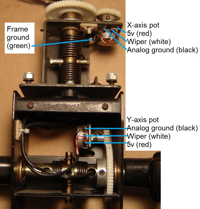

My question is what do I do to just use the joystick aspect? I don't need the buttons, therefore how do I wire it?
Just ignore the button inputs.   ;D
For what you're doing, you need the following:
  1. The 10k pullup resistor between Vcc and E2/B to keep the board from going into programming mode every time it is plugged in.
  2. Wiper 1 to tab 2 of the Y-axis potentiometer. (blue wire below)
  3. Wiper 2 to tab 2 of the X-axis potentiometer. (green wire below)
  4. 5v to either tab 1 or tab 3 on the potentiometers and Gnd (Analog) to the other-- if an axis moves backward, swap 5v and Gnd (Analog) on that potentiometer.
PROTIP: Verify both axes are moving correctly before soldering the wires to tabs 1 and 3 -- alligator clips are your friend.
Here you can see the red 5v wire on tab 1 of both potentiometers and the black Gnd (Analog) wire on tab 3 of both potentiometers.
If you're wiring P2's analog joystick to the same board (using the 4-axis hex), connect 5v and Gnd (Analog) same as with P1's stick and connect the P2 potentiometer wipers to inputs F4 and F5. (I don't recall which wiper is which axis  :dunno)

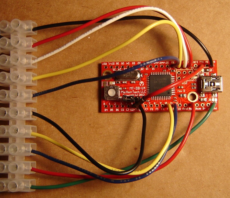

1. Cut/strip/lightly tin a 2.5" - 3" wire and and bend one end into a U-shaped loop.  Cut one lead of the 10k ohm "pullup" resistor to ~1/4" and bend it into a U-shaped loop.
2. Solder the wire loop to the resistor loop (shown below with the end of a wire-bending tool) and insulate the connection with heat-shrink.
3. Solder the resistor and wire between the Vcc and E2/B holes on the board.

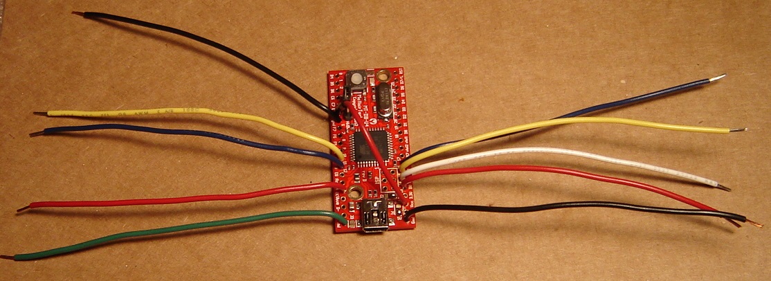

5. Solder 4" wires to the following 10 board holes:
* Gnd (lower right) - Ground (Buttons)
* B0 - Button 1 (left trigger)
* B1 - Button 2 (right trigger)
* B2 - Button 3 (left thumb button)
* B3 - Button 4 (right thumb button)
* Agnd - Ground (Analog)
* F1 - X-axis Wiper
* F0 - Y-axis Wiper
* Avcc - 5v for Analog
* Gnd (lower left) - Frame ground
You may want to use color coded wires.

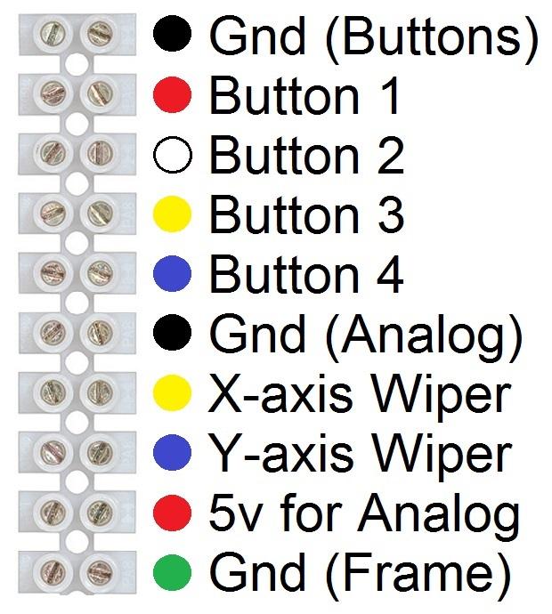

6. Connect the 10 board wires to the terminal strip. (strip shown was cut to 10 positions)

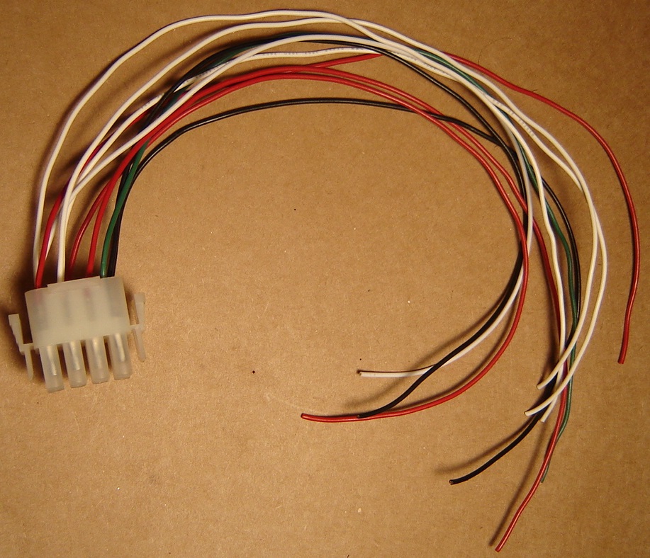

7. Make a Molex adapter cable.
- You may want to use color coded wires that match with your yoke harness.

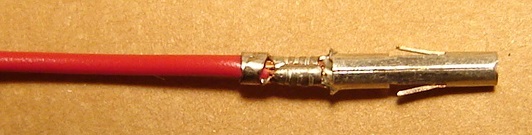

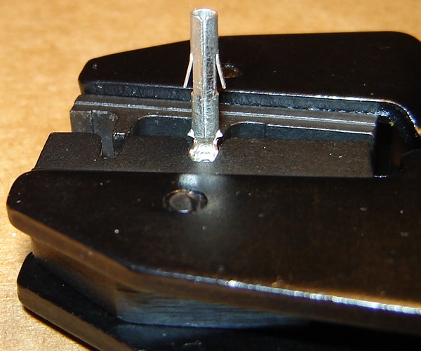

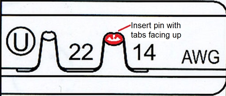

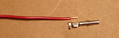

- Crimp pins onto enough 12"(?) lengths of wire to connect each pin from the yoke harness to the terminal strip.
-- The "14" slot on the HT-236-2U die works well for 0.084" pins
-- Pic below shows a molex pin properly positioned in the jaws of a ratchet crimper with the wire end of the pin toward the slightly wider side of the crimp die, the "ears" on the pin pointing into the U-shaped side of the crimp die and the already-round part of the pin clear of the crimp die by just over a thumbnail-thickness.
- Insert the crimped pins into the molex housing.
8. Attach the Molex adapter cable to the yoke harness.

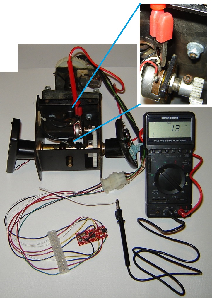

9. Carefully remove the outer grips (don't lose the springs on the thumb buttons or triggers) and the cover from the yoke so you can check the wiring.
10. Verify the wiring using your multimeter set to either continuity or ohms mode.
- Clip one lead of your multimeter to a wire in the yoke and touch the other lead to one wire after another in the molex adapter cable until you hear a beep (continuity mode) or read less than 2 ohms. (ohms mode)
- Connect that wire to the associated terminal on the strip -- some terminals may have more than one molex wire connected
- Repeat until all molex wires are identified and connected to the correct terminal.

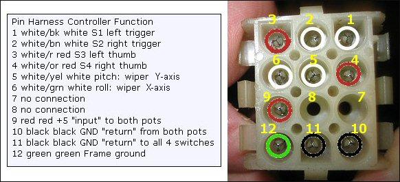

Pic shows continuity from Y-axis potentiometer wiper (red lead) to the corresponding wire on pin 5 of the molex adapter cable. (black lead)
Star Wars harness pinout (Thanks to Ninten-doh for the original image and to Gray_Area for clarifying the wording)
Hydra harness pinout (Thanks to processedmeat.)
NOTE: This pinout and wire colors may not be factory defaults.  If you have an un-hacked harness, please confirm and/or clarify.
I'm not as confident about the harness colors as the previous owner seemed to do a hack job on the wiring.  But those are definitely the pinouts as confirmed by the multimeter.

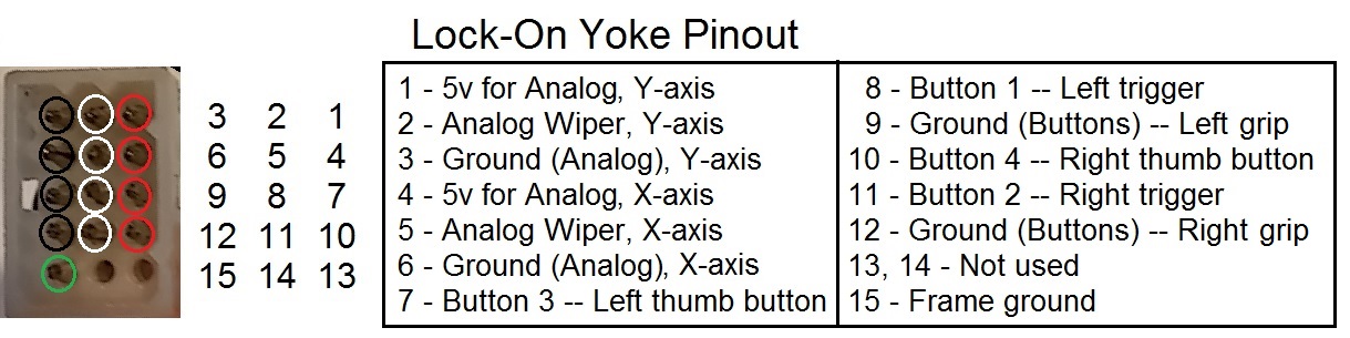

Lock-On harness pinout (Thanks to greenmanjph.)
Terminals
