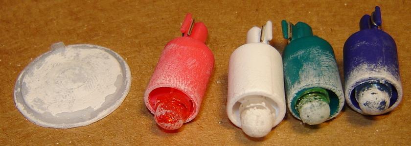

I've been printing inserts for translucent buttons, but sometimes they get turned the wrong way.
After reading this at GGG, I figured I'd try the trick that Randy recommends.
For permanent installation a small drop of GEL superglue can be placed on the back of the PGI at the point where it meets the inside wall of the plunger.

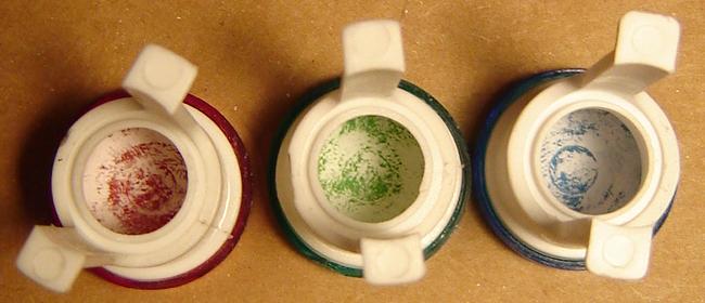

Well, it turns out I used a little bit more gel superglue -- 8 really tiny spots around the diffuser.
Wanting to see how well it came out, I assembled the buttons and everything looked great.
The next morning, I lit them up to see how well it worked and they looked like  :censored:.   :dizzy:
Taking the buttons apart, it became obvious that the superglue did exactly what it does in the fume hood on CSI, bonding with the fingerprint oils  -- it built up quite a thick layer.
Lessons learned:
1. Use the least amount of superglue possible.
2. Let it cure fully before assembling the buttons.
Hopefully this helps someone dodge the bullet.   :embarassed:

There's a glue available at most hobby shops that's made for glueing clear plastics. I believe its for car and airplane models, specifically for glueing windshields and cockpit glass. Its formulated to not fog the clear plastic parts. Might be a better option. Its not instant set though. Zap formula 560 is one brand, but upon further investigating in model building forums, it seems these special canopy glues are nothing more than overpriced Elmer's glue. I guess Elmer s brand has the standard white glue that dries white, and another that dries clear. It however does not create as strong of a bond as super glue but I would suspect would be adequate for the purpose posted above.

You may be able to save the LEDs. Nail polish remover with acetone dissolves super glue. You might be able to use a q-tip and clean the LEDs off. It might still leave a fog behind, but its worth a try!

Already managed to clean all the sockets, bodies and springs with just isopropyl alcohol + Q-Tip.
Also finished cleaning one plunger -- the rest should come out OK.   ;D
We'll see if the LEDs/diffusers clean up.  :dunno
Bad news: The lens covers are also somewhat fogged. :badmood:
Good news: I bought spare LEDs and lens covers/diffusers in my last order from Bryan.   8)

Until superglue is fully cured, it lets off some byproducts that are absolutely terrible for plastics. I learned that building models years ago. Yuck.
About saving those buttons, if the acetone doesn't work, take some steel wool and a scotch brite pad to em. It'll evenly scratch them up such that they'll "look" nicely diffused or frosted. Might be just the trick.

Two of the lens caps were adhered to plungers.
Vise Grips made short work of pinching an edge and prying them apart.
One slightly cloudy lens cap cleaned up passably well with mineral spirits, but it's probably not worth the effort since a new cap/diffuser only costs $0.75 here.
Didn't even bother trying to clean the diffusers since they come with the lens caps.
The LEDs still look like total crap, but might be usable in a pinch, assuming the brightness isn't too badly degraded.   :dunno
The blue LED looked OK with the replacement diffuser, cap, and printed insert.
The plungers cleaned up well enough for reuse with just a bit of isopropyl and a thumbnail to break off a few bits of super glue.
Finally got around to trying Acetone and a Q-tip.
Before:
After:
The LEDs turned out OK with very little effort -- the red one looks almost new and only one or two of the others have a slight haze left on the face of the LED.
The lens covers did not fare well at all and the rough surface of the diffusers makes them very difficult to clean -- given that these are sold together here it's probably not worth the effort on these.
