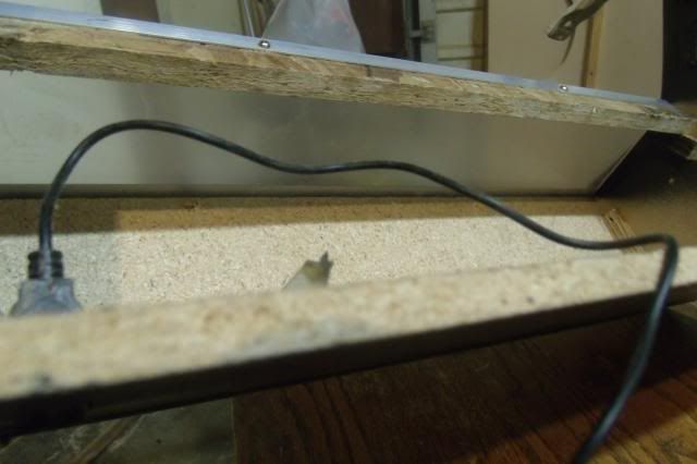

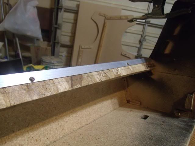

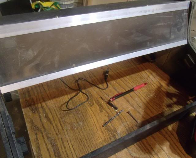

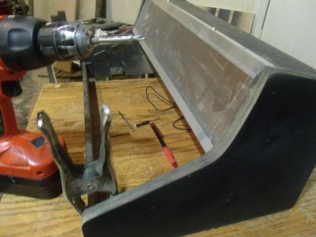

Anyone got any ideas on how to secure the bottom half of the marquee? Where it runs into the control panel.
Rick
  • Posts: 2801
    • Gameroom Designs Canada
Re: S.A.M. - Stand Alone MAME
« Reply #17 on: September 02, 2013, 09:29:41 am »
Trim the depth of the CP at the back, so it creates a channel for it to sit in? Then, use some black channel molding on the top and bottom.
Maybe a piece of inside corner moulding ( http://www.homedepot.com/p/Stabilit-1-2-in-x-3-4-in-x-8-ft-White-PVC-Tile-Inside-Corner-Moulding-FRP-ISC-WHITE/202083289#.UiSc-T_pwrx ) If you can find the right thickness - tacked into place with staples or finishing nails from the backside so they don't show.

for the marquee, do it as you would do it with a speaker brace just thinner...
run a baton or bracing across near the cp same angle as your top, and use the same aluminum L-channels to hold the marquee.
screw in the l-channel to the baton underneath the CP.
I was thinking that would be the easiest route. I would have to remove the bottom panel (the only panel that is removable) after painting and screw in the L-Channel like normal then glue the control panel down after art and buttons\encoder is complete.

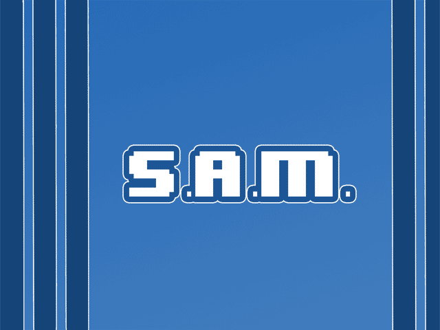

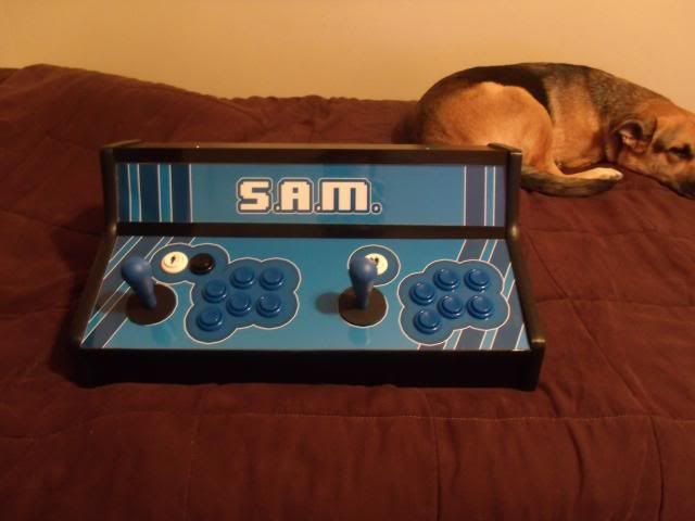

Work in progress - Art
Just messing around with the control panel. I didn't know how much I suck with photoshop but I tried.
 :dunno
« Last Edit: September 04, 2013, 03:56:31 am by CoryBee »

Messed about some more, kind of liking where this is going.....
Edit: Outlined the SAM text in white, use to be this (click to enlarge);
« Last Edit: September 04, 2013, 04:46:13 am by CoryBee »

Color scheme seems off.
Instead of shades of blue, shouldn't it be gray, with about 47 more shades?  :duckhunt

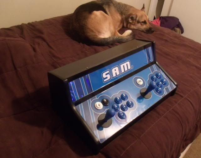

Buttons should be here tomorrow. I have all I need to complete the cabinet one they arrive. Had the art done yesterday.
I quite like it.

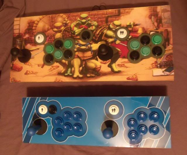

Also, there is no place for this but here is the art I had done for a separate cabinet I am doing (full size cabinet). Figured I would share since I printed them at the same time.

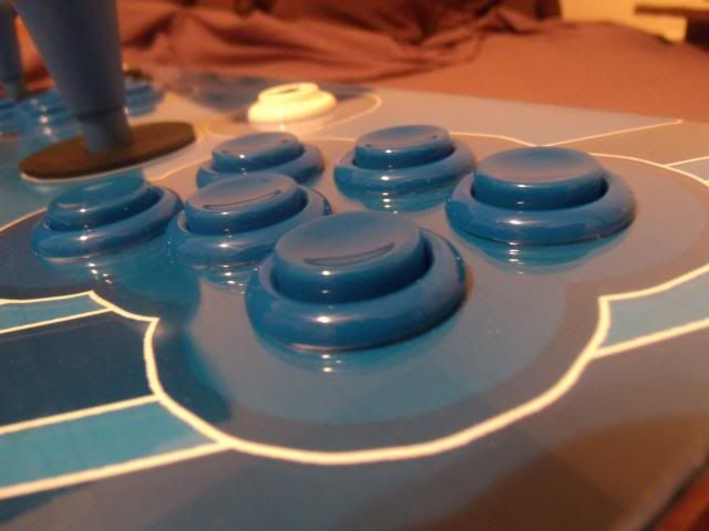

Marquee retained  :cheers:
Turned out pretty good and was a pretty simple solution
A view from the underside for the hell of it
Just finished the painting the last coat, not much left to do once it is dried. Just assemble and software  ;D (oh and solder a couple things like the power button and external USB port)

SAM is complete. I have been playing this thing on the big screen and I absolutely love it. Will have some pictures of it being played soon.
I had a couple of small issues I had to deal with. Worst of it was after I put together the control panel and started assembling everything I noticed I could not move player one's joystick very much because it was pressed against the laptop hard drive!!  :banghead:
I had to remove all buttons, basically strip down the CP back to bare wood. I then recessed the joysticks enough to barely miss the hard drive this time. All is well now though and S.A.M. is just waiting for a custom MALA theme. Turn the thing on and it kicks into the frontend with a ton of games and console systems. Definitely taking it with me to the UK, might even try selling it there for a bit of cash before my trip back.

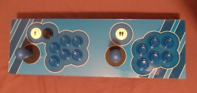

Not sure if I should do a blue and white themed Mala layout or just leave it to the one I have been using lately. Hmmm.....
Monkeyvoodoo
  • Posts: 251
    • threefoldhorse Custom
« Reply #108 on: October 02, 2013, 09:59:19 pm »
What about staying with the blue and white but reversing the colours? Blue on white?
CoryBee
  • Posts: 2093
  • Bopity Boopy
« Reply #109 on: October 03, 2013, 06:11:56 am »
I like this idea. Will play with it a bit.

Got some more pictures for you fine fellas.
Sold it already I think, the guy is coming over tomorrow morning. $550 for the first production of my Stand Alone Machine.
Finishing up a better theme for Mala tonight that  goes with the overall "cabinet" theme.

Here is a quick demo I made to show the thing off a bit
