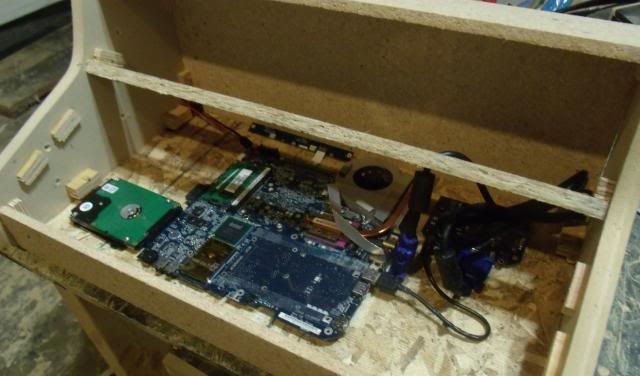

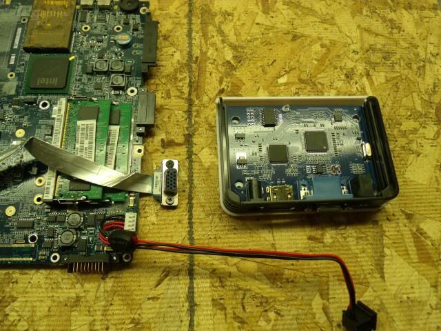

« Reply #67 on: September 09, 2013, 08:51:09 am »

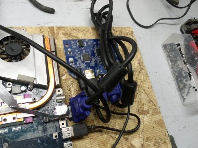

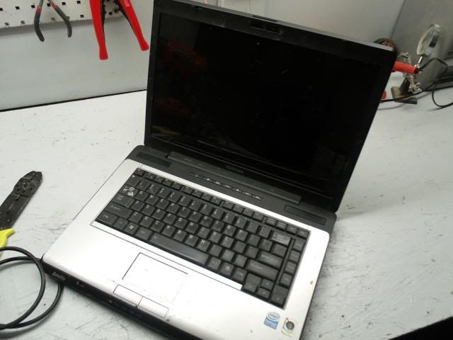

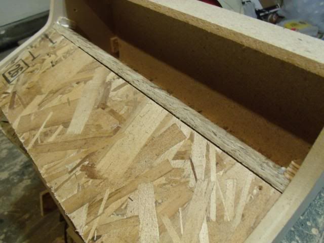

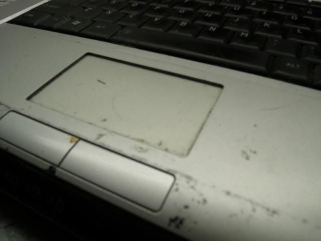

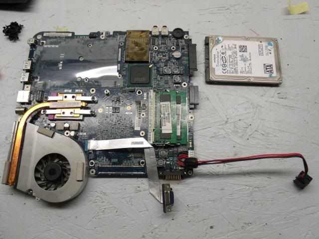

This is the piece of wood that will secure the marquee in place. After installing the marquee I will then glue the CP in place and push it snugly against the aluminum bracket that holds the marquee together.
Prepping the Laptop for surgery
Must have been owned by a cat or something else gross like that
Taking apart the VGA to HDMI Converter

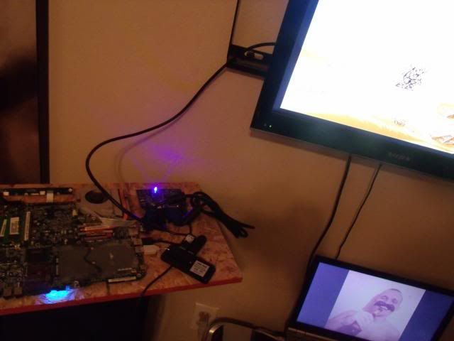

Boards mounted to the base panel...and cords. I don't like the length of all of them so I am probably going to shorten all of the cables and\or wire them directly from port to port.....I dread this process though
Also, the converter runs on 5v so I spliced a USB cable for power. I will run another USB combined with a chip to step up the voltage to 12v if I plan on lighting up the marquee area. This way all power is pulled form the laptop itself.
Everything mounted\plugged in, Windows Black installed and the thing works perfectly!
As I had hoped it sits fine and out of reach of any buttons and joysticks
And as always, thanks for watching.
