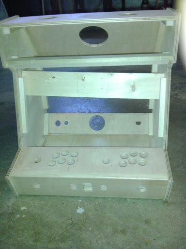

Iv'e been working on this for a while, almost done now so I decided to post all my progress pics.
Design was based off of Unstpuid;s Bartop NeoGeo which you can see here:
http://forum.arcadecontrols.com/index.php/topic,114435.0.html

Cutting all the wood
Starting to put it together

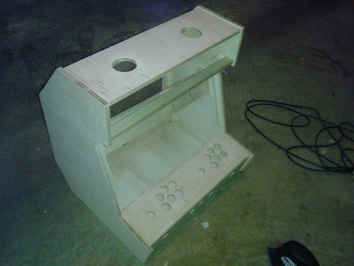

Glued and assembeled with all the holes cut
Spray painted (3 layers on the back, 1 on the sides)
Started putting things in to check the fit

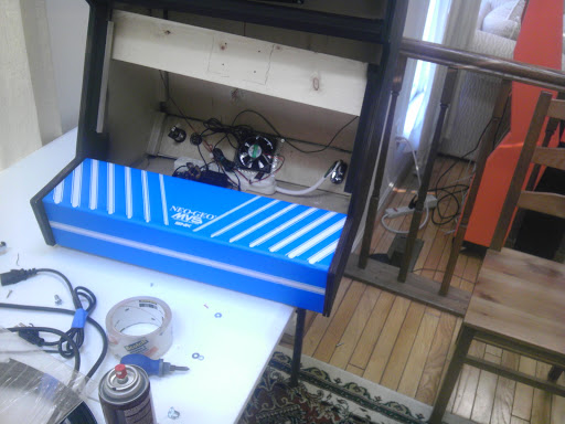

The computer I am using (massive heat sink somehow managed to fit inside)
Artwork came in the mail, started applying it
Put the buttons and joysticks in, tested the LED's on them

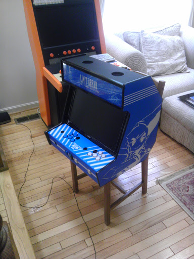

Final (sort of) exterior picture of it (not much connected inside at this point)
More updates to come as I finally finish up!

Nice looking cab!  ;)  Ya better put some speaker grills on those holes before someone thinks; "Hey, cup holders!"
