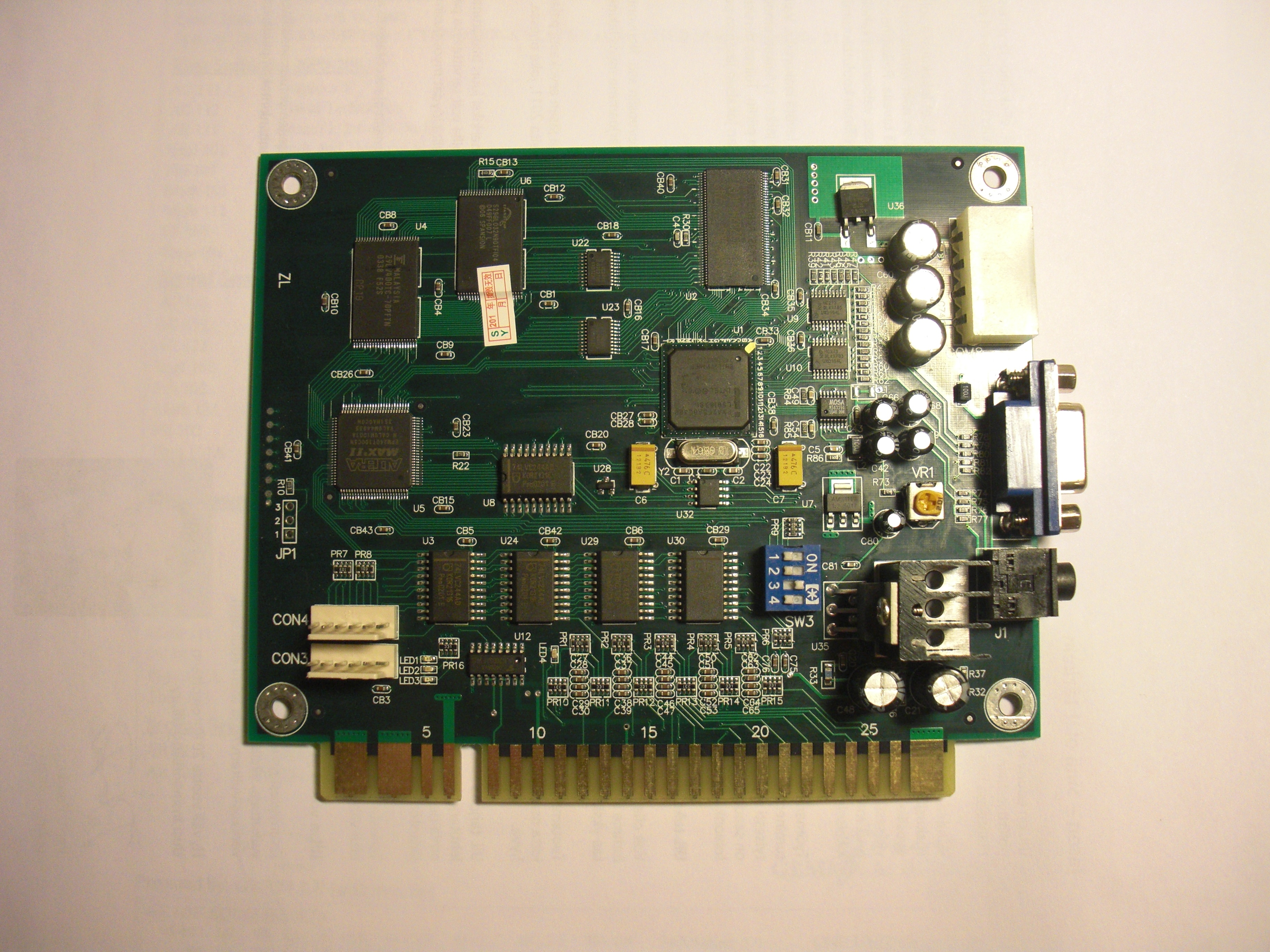

OK, a two part question with pictures:
Here is the 60in1 board:
Here is the board with jamma connector (is this the way it connects) - it is in Chinese :( ?
Here is the power supply:
What is throwing me off, is how does it get power, there is no plug for an outlet.  And looking at the inside of Maximus's unit, I don't see PC power supply:
dextercf

Copy of Little Ms. Pac-Man
« Reply #18 on: April 25, 2013, 07:38:16 pm »
You attatch leads from your mains to AC1 and AC2.

« Reply #19 on: April 25, 2013, 08:27:21 pm »
OK, the power part makes sense to me now, but how about connecting the wiring harness to the 60n1 card, do I have them lined up right?
Re: Copy of Little Ms. Pac-Man
« Reply #20 on: April 25, 2013, 08:42:05 pm »
Yup.

  • Last login:October 04, 2024, 06:10:57 pm
  • Sshado's Club
    • Sshado's Club
« Reply #21 on: April 25, 2013, 08:50:44 pm »
Cool, and special thanks to Maximus for the diagram :)

How did you wire the speakers to the amplifier? I had the speakers connected to the 60n1 card, but now I want to add the amplifier.
Also, how or where do you wire the service / test buttons?
The amp I bought from amazon just had wire terminals so I attached them easily like that... I think, hard to remember now. The service buttons are part of that Jamma Harness, one called test and one called setup.

Hmmm, I looked at your Jamma wiring map and it doesn't snow anything for test or setup. I also looked at the board and don't see a direct connect:
Maximus
  • Posts: 1392
  • Plans are for fools!!!!
    • Arcade Icons
« Reply #91 on: May 16, 2013, 12:27:52 pm »
Hrmmm, they are usually on the harness, do you have any wires at 8,9, or 11 or J,K,M on your harness?

There you go, 15 parts side is the switch line for 'test' and 14 solder side is the switch line for 'service', just ground the other side of the switches and they will work
